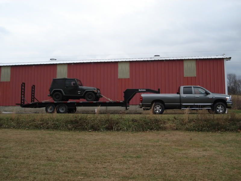

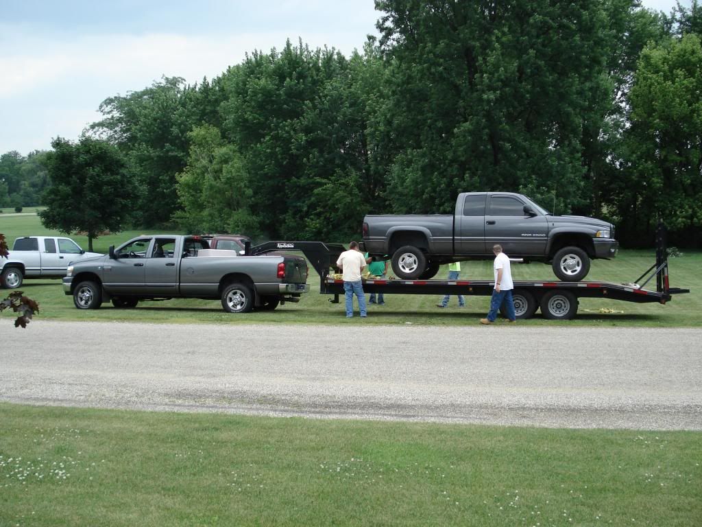

Great pictures! I have a very similiar gooseneck just a different brand, mine scales out about 5100 lbs with chains, binders, and a couple 6x6 blocks. I dont think i could go back to a bumper pull trailer now. Here are a few pictures of some various loads.
Picking up my Ford 961
The Jeep loaded to go to camp
Delivering a buddies truck that he just bought
