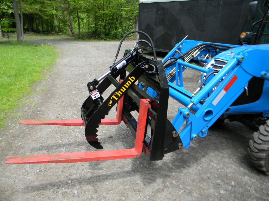

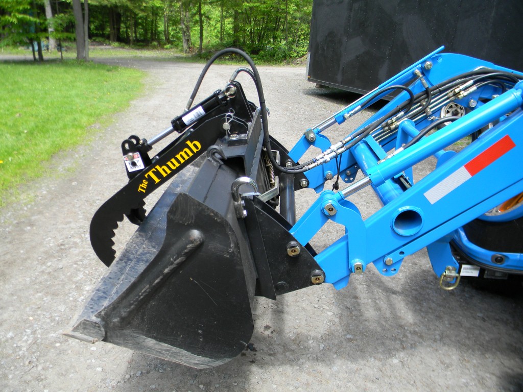

looks like a grapple isnt gonna do me any good then. even if I had a compact tractor I still would want more power lol. So any recommend then a good thumb for the backhoe? Also where is fizikgeek at. he said he has a thumb on his loader, I think we all would like to see that thing in action, I have looked all over the internet and have yet to see it with something big on It.

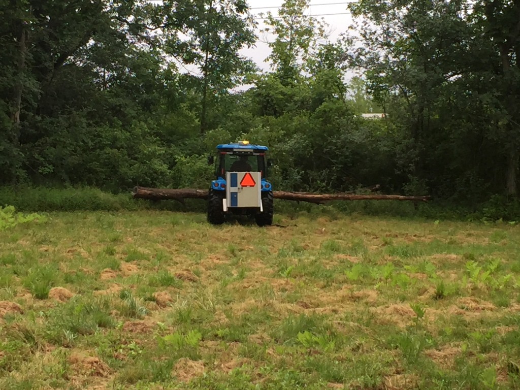

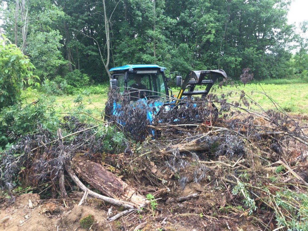

I have the thumb which I can use on my forks or bucket. I recently cleared some downed trees at a friends house. However, I don't think a 1720 would pick up a full length tree. Adding a thumb to your BH would be much easier than chaining.

Thanks for the pics george. I was looking into like a pallet fork thumb combo for my Gc. But i think the most economic option woukd be a backhoe thumb. But if the backhoe/thumb option dont work then dont mind spending on the thumb with all the hydrolics for the loader.

Amen ! It was a HOLLOW log, though, you notice in one view. In general his backhoe feet will be resting on the ground when he picks up that size log if his backhoe would pick it up in the first place, which is doubtful. Otherwise he does a wheelie. Conceivable you might hold the log there in order to cut it up into smaller lengths but a solid log the length you show -- you are not going anywhere with it. Some will say you are barking up the wrong tree ?
