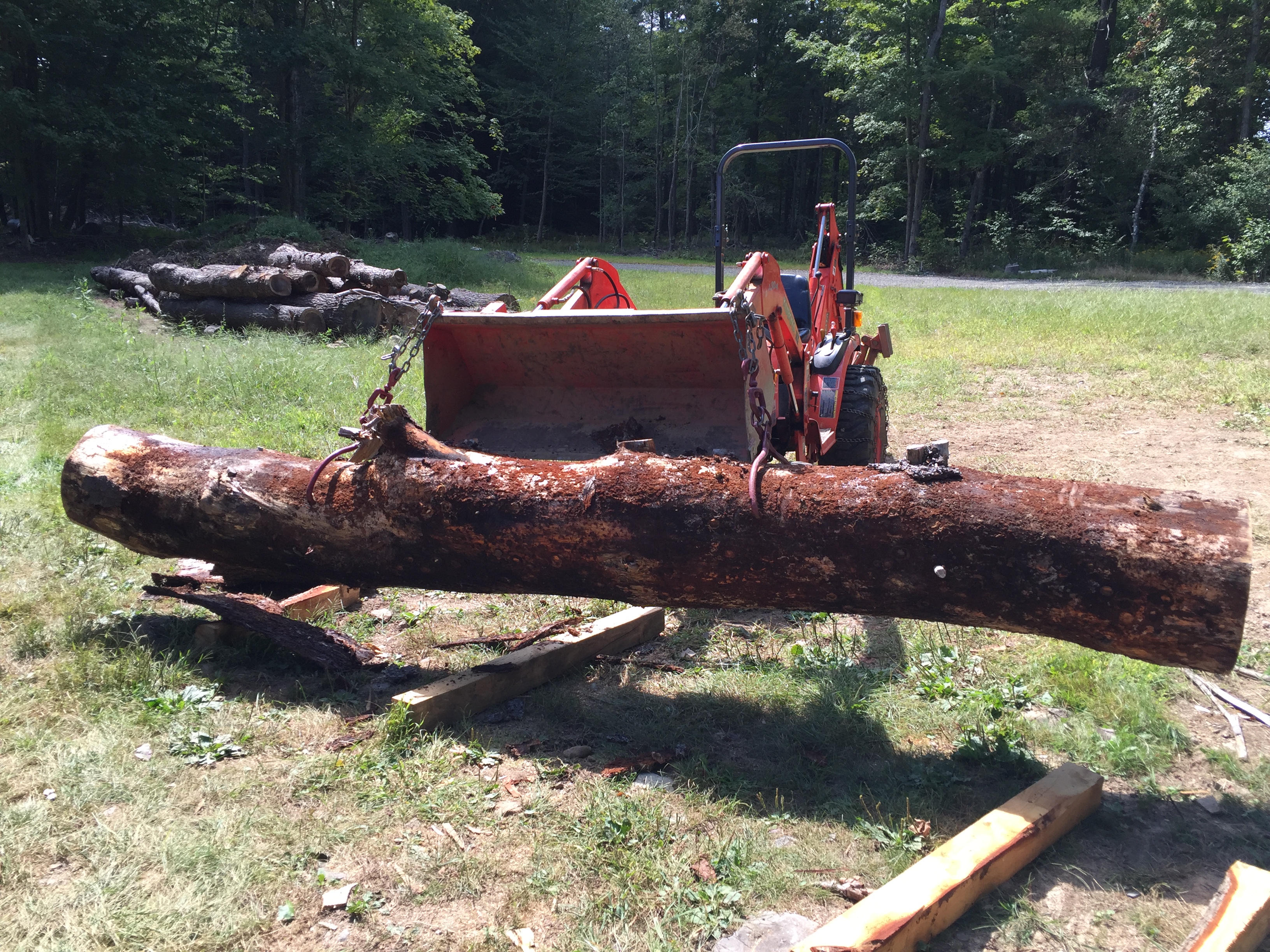

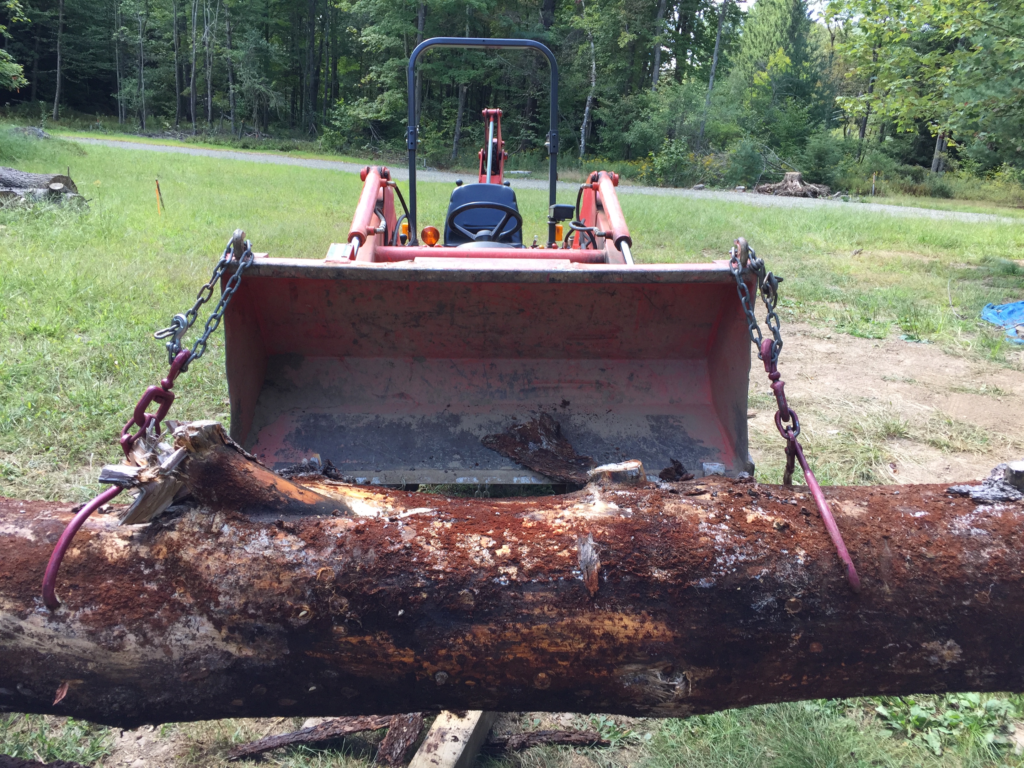

Not a thumb or a grapple but another method to move large logs and have stable cutting. I bought two skidding tongs and use them with the bucket hooks to lift and transport large logs. I have a manual thumb on the backhoe, however I can lift larger logs with this setup. I have a set of clamp on forks but they decrease the lifting capacity of the bucket and do not stop the log from sliding around when cutting rounds off of each end. The skidding tongs work well.

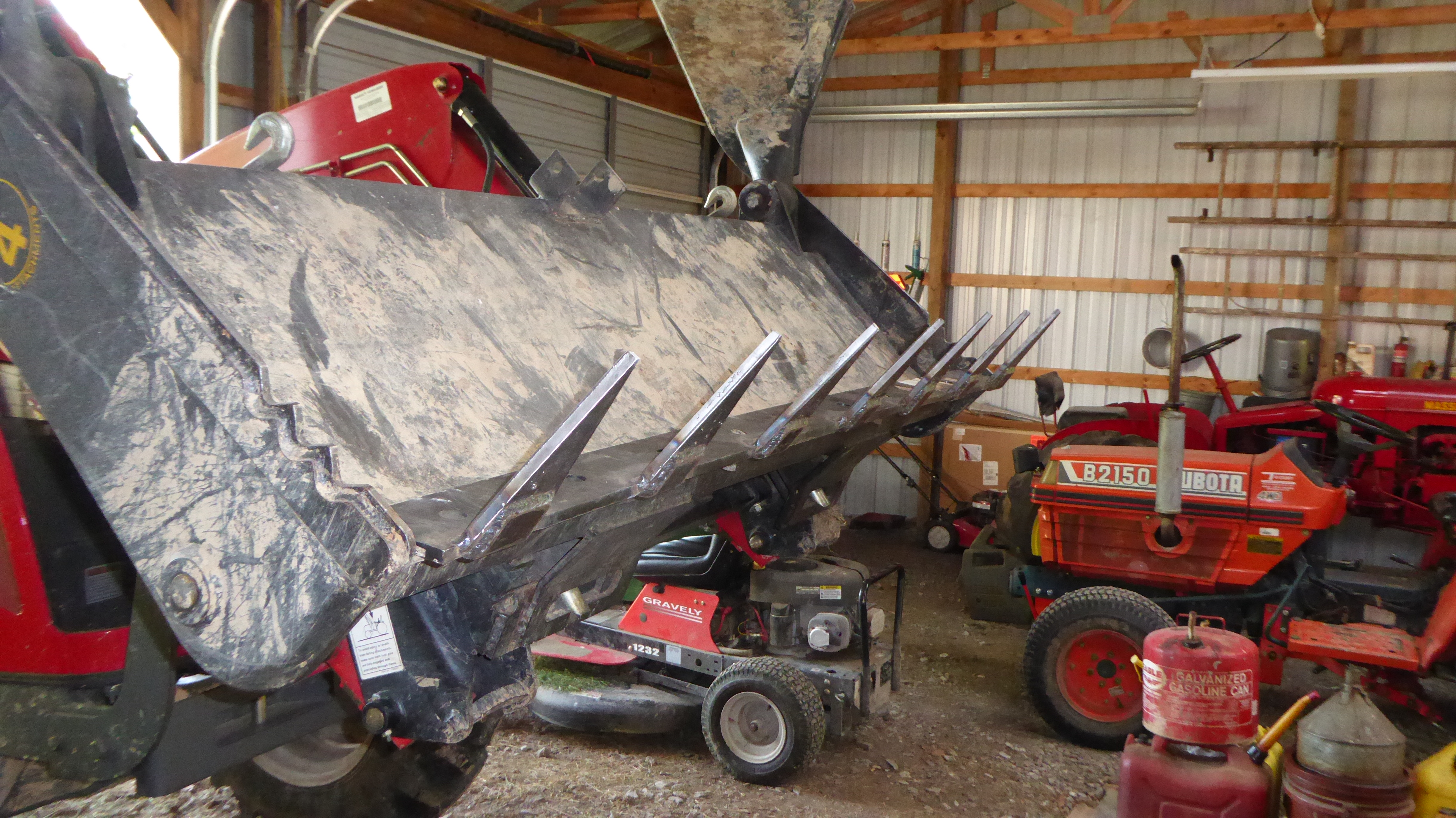

A bit off center from this thread but relating to picking up logs, limbs and tree parts -- I had teeth welded on to a spare replaceable knife edge on a 4-in-1 bucket. Had been using the pinch bucket to pick up posts, limbs, trees, etc. cleaning up an old farm and found problems with the wood slipping out of the pinch bucket several times before a good grip. With these teeth every grip is a good one and rarely do I have to try twice. This is on a MF 2660 and DL250 FEL.

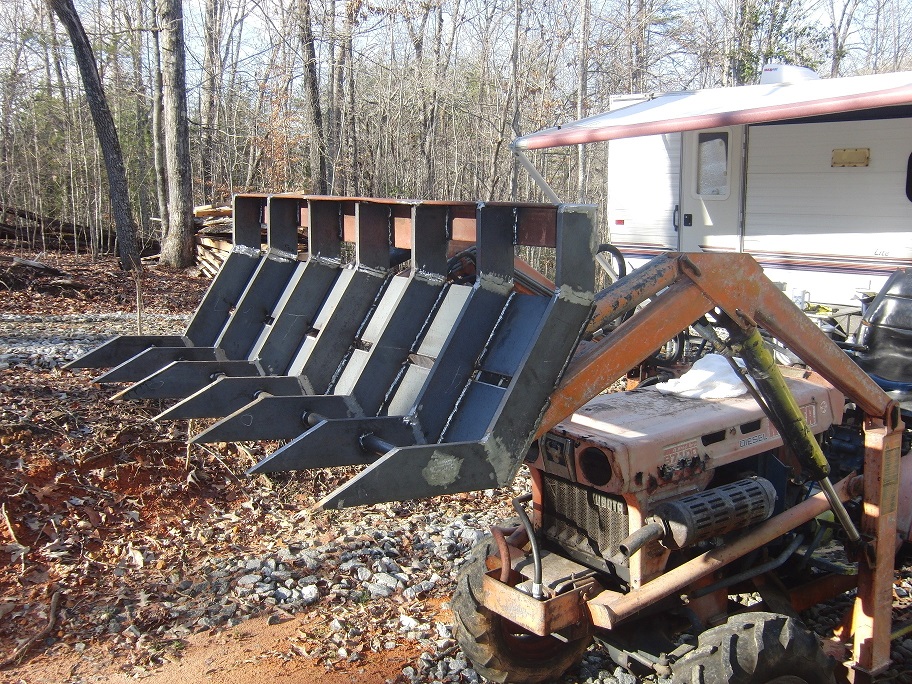

A little overkill for my B7100 but it works
I like the idea of the skidding togs. gonna call some people tomorrow and ask about ordering a backhoe thumb

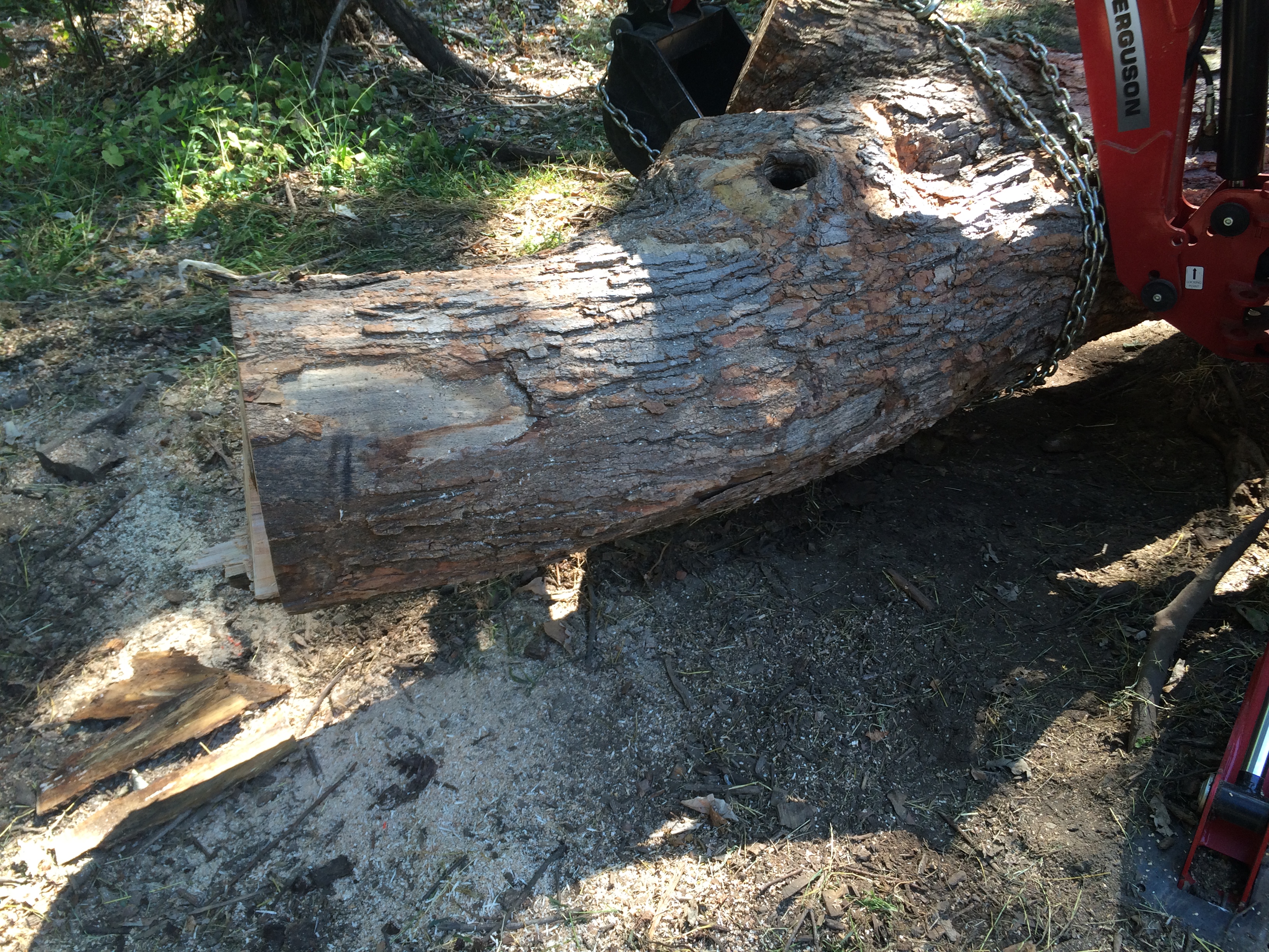

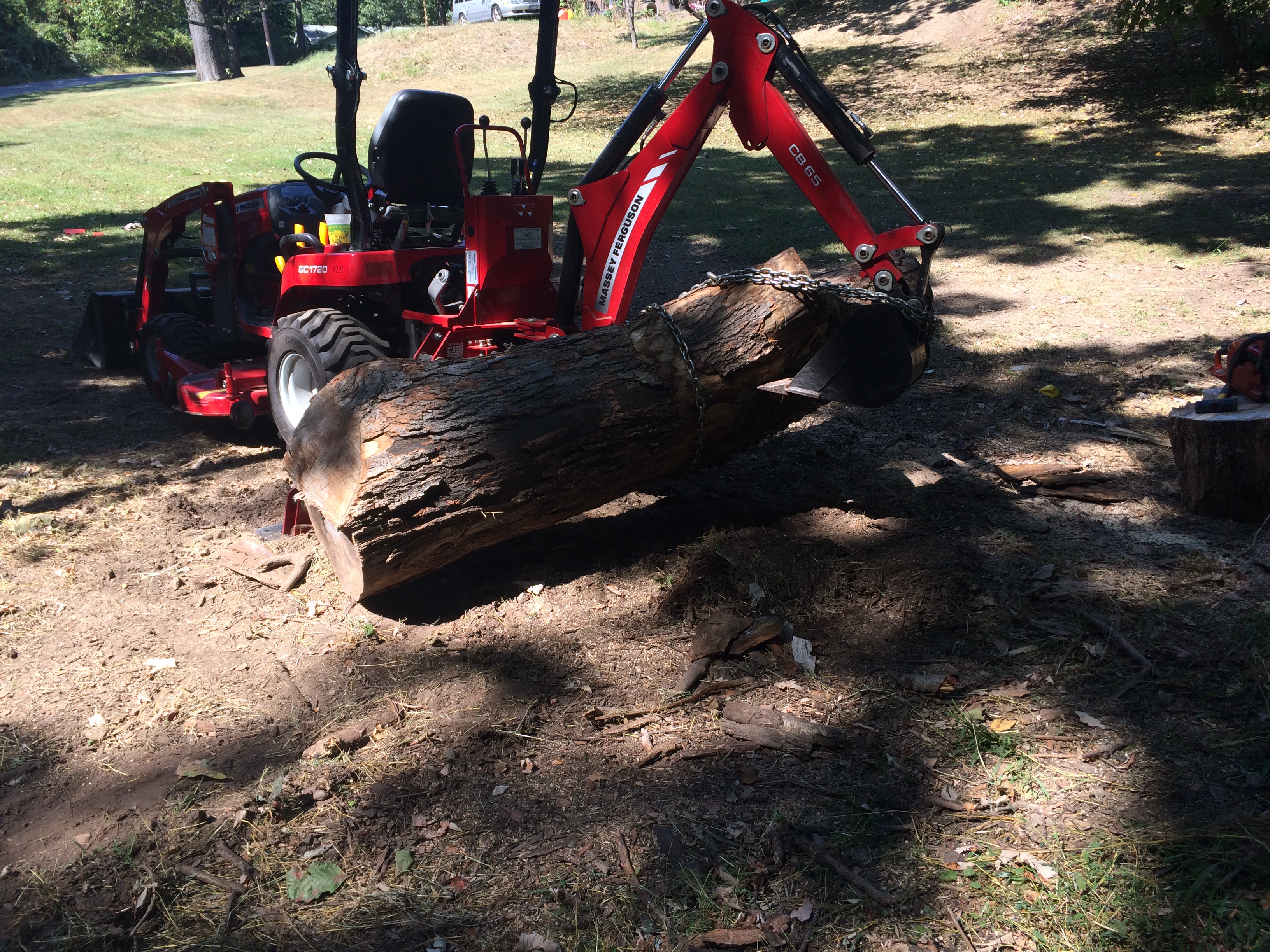

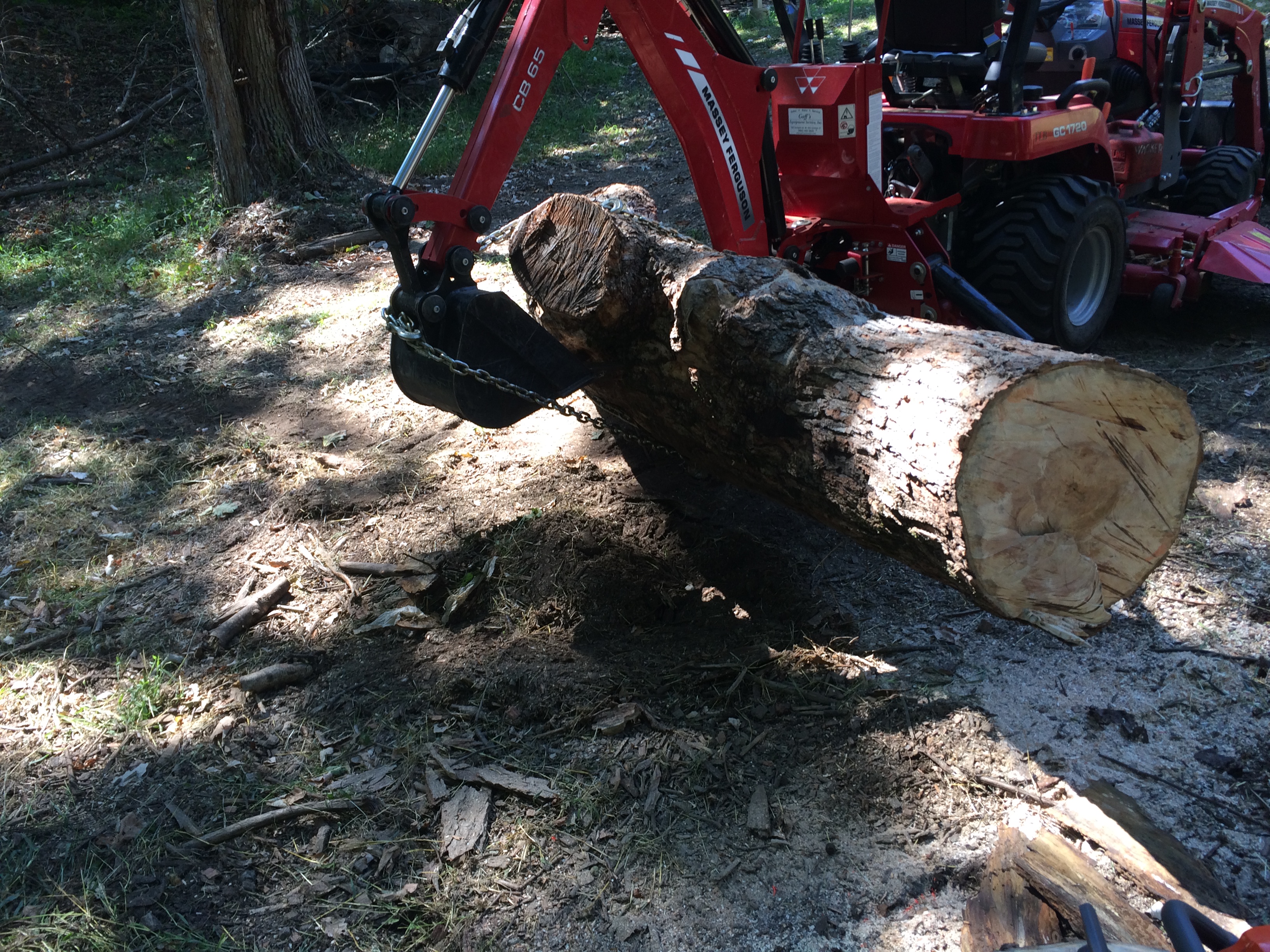

Well this is sure to test the might of the bckhoe. This is one big and thick piece of wood. I got it off the ground :). The chains where not hooked up good thid time i did hve it higher.

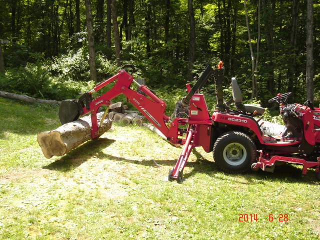

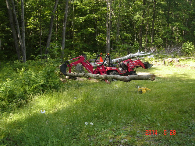

My BH and thumb in action. This was 2 years ago, got over 3 cords that time.
