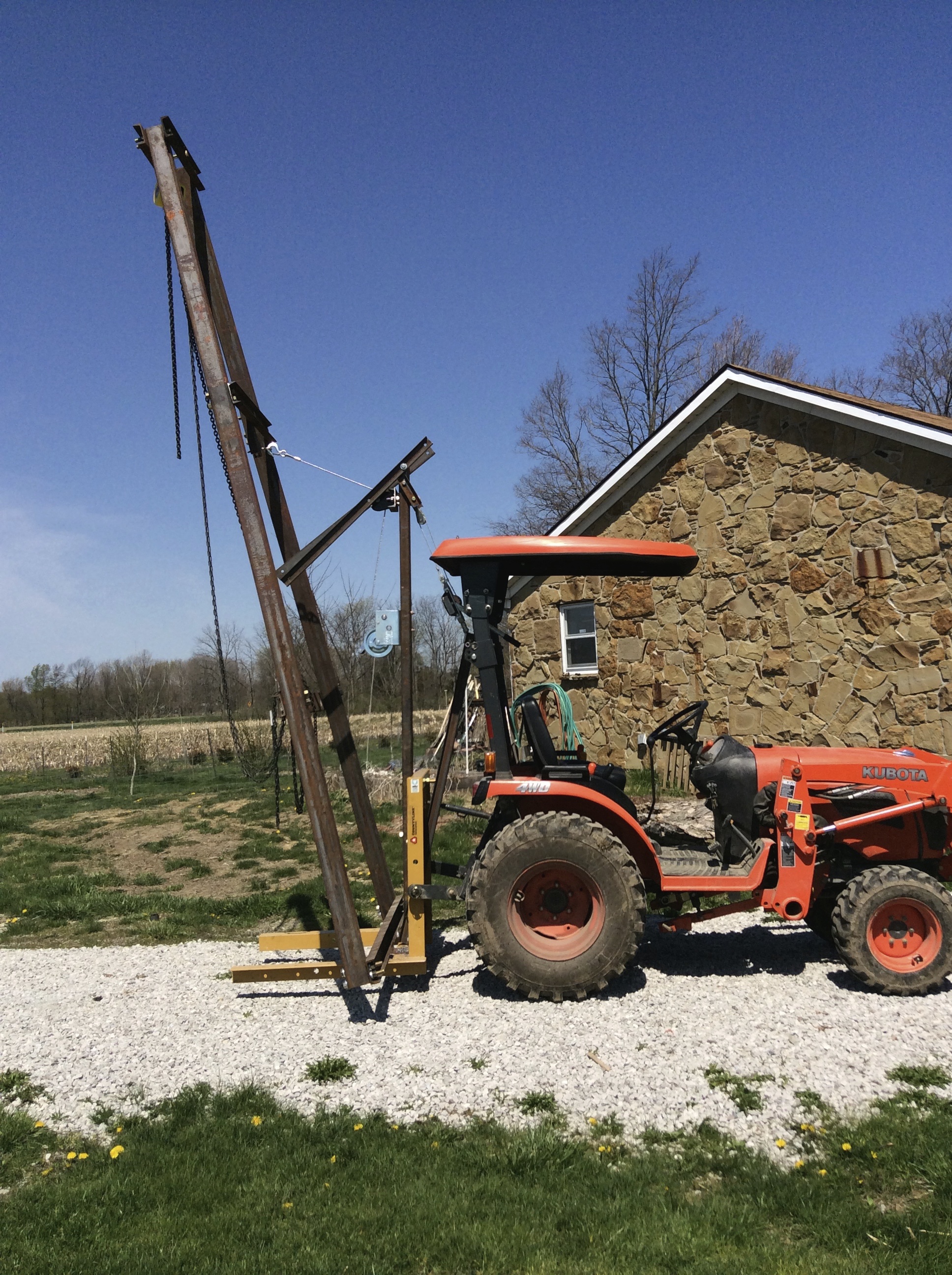

I built a crane for my little B2320 and attached it to the little landpride carryall. It worked for me and maybe you can get some ideas from the picture. It has a lifting capacity of a ton but if that's not enough for you, you can use heavier-duty chain winch and cable winch. The reasons I used 2 manual winches are: 1) I didn't want to get into a electric and or hydraulic project (manual worked great putting up my large dimension timberframe pavilion); 2) I needed the crane to tilt so I could build it in my metal pole bard with 10 foot high overhead doors and get it out with a lift height of about 16 feet with the elevation of my 3-point (had to lift the whole thing with tractor to be mobile, the crane itself stands 17 feet tall vertical; chain hoist reduces that a little);and 3) I wanted to tilt the crane to lowest possible to start the lift, raise it as necessary for whatever I was lifting, and that made it so I didn't have to constantly rely only on one or the other hoist which was beneficial because I didn't know how to calculate the additional load created by the crane being at different angles (I'm no engineer). I just overcompensated with 3/16" rectangular steel tube and 1/2", 3/4" grade 8 bolts, nuts, washers (I'm no welder either!). If the overall height at horizontal position while driving the truck has too much out the rear end, you can make it 2 pieces—upper and lower, just drill 4 extra holes for 3/4" hardened bolts. If you would like more photos, I can share them, just don't know if tractorrbynet lets us put multiple photos in on reply or is there a way to email through the site without you giving up your private email?IMG_0353 (1).jpg IMG_0354 (1) 2.jpg IMG_5912.jpgIMG_0635_2.jpg
I attached several photos. Let me know if they are of any help. To give you an idea of the weight, the timbers were wet (freshly cut from the forest) and the largest (8" X 12" X 16 feet long weighed 600 lbs. and the 8" X 8" posts attached to them were about 150-200 lbs, so lifting the 3 pieces was 900-1,000 lbs. and I did have to lift them completely to move them exectly into place. The 34 foot wide trusses weighed about 500 lbs and had to be lifted 17 feet to get over the top and compensating for the different grade the tractor and crane were on.

TerryMcQ - Thanks for the pictures! I might use that in the future, but right now I need a crane that is mounted to the truck. I haul a lot of firewood and other heavy stuff and can't load it by hand. Some of the chunks of wood I bring home weigh 2500 lbs. It is much easier to chop them up at home rather than out in the boonies.

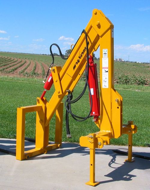

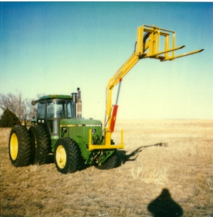

This is another style that you might consider, with an added base rotator: Ag Krane
