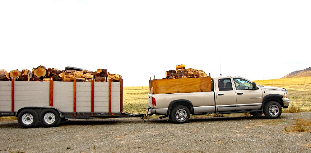

Not a tree in site, but all that firewood!!!!! Just kidding. LOL Jon
I had to smile when I read oosik's post about have to travel a half mile one way to get firewood.
Very true, no firewood to be had around here. Well, there is some but the government (BLM) won't allow firewood cutting, even for dead trees that had been killed by forest fires. So that load of firewood I posted a picture of came all the way from Oregon - 242 miles one way. Hauled my firewood from Oregon for many years. But two years ago even that source started drying up - they can't get firewood cutting permits up there either anymore - so I went to a pellet stove. Drought and bugs have killed huge swaths of our western forests, so now massive forest fires result. Yet no one is allowed to cut down dead trees....the logic of government bureaucrats.
