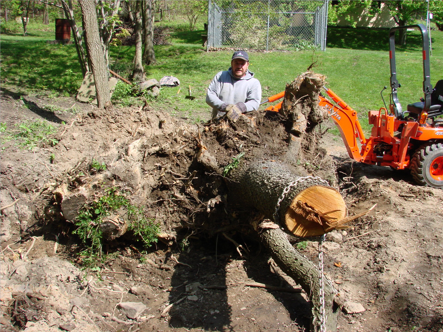

RayCo said:
May I suggest that you purchase a chain? Using a strap to pull things like that can be a bit dangerous, as you're essentially creating a slingshot aimed directly at yourself and the tractor. </div>
Thanks for the advice RayCo. I was hoping someone would mention whether I was crazy for using the strap. My thinking was that since this was my first time, would I rather be hit by the strap when it breaks or get hit by the chain if I don't hook it right or it's the wrong size. I went with the strap idea and purposely put both metal ends at the BH. Now that I have more confidence in myself, I will use the chain for the stump beside the one I just removed.

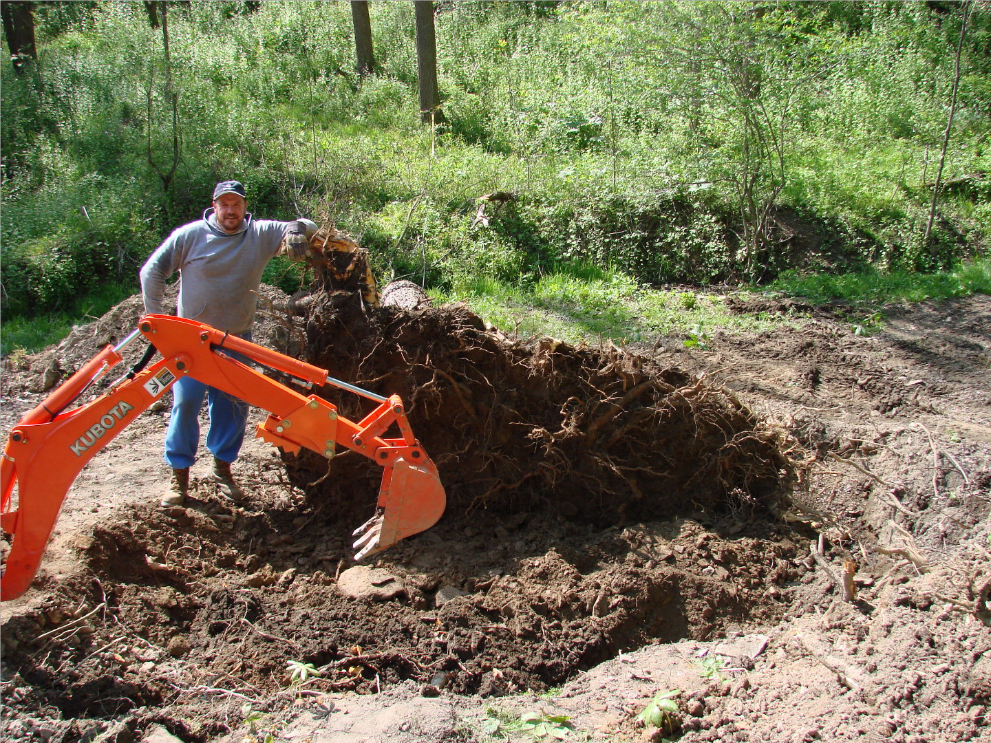

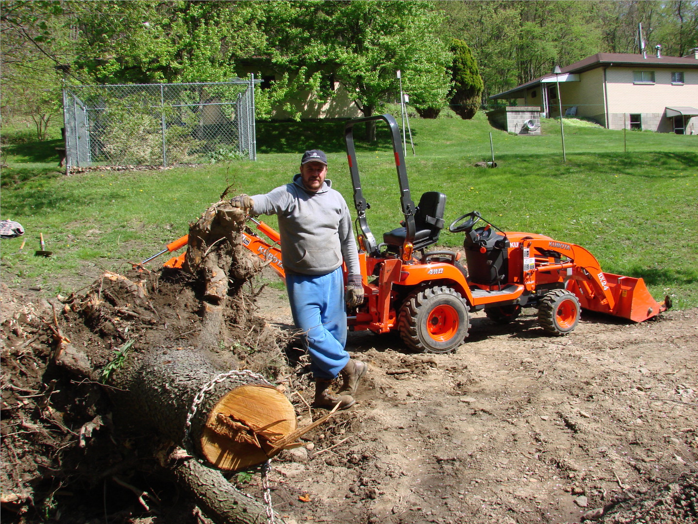

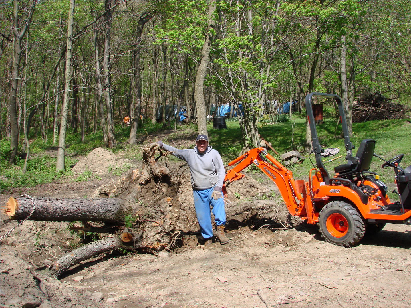

Frank....I must disagree with you here about the BX24. Now I will say its a small tractor, it just takes more time and thought when tackling a big stump.
Proof is in the pictures........
Craig

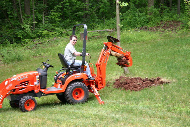

He he. You'll get a lot of slack for that comment. Although, it seems as though you already got more than I would have expected. It says you're banned now. :eek: Well, regardless, here' my obligatory dispute, but all in fun. :) I know the BX is limited in what it can do and knowing the limitations of your machine is very important.
Here's a stump I dug out about an hour after delivery of my BX last summer. It's about 7" in diameter:
At the risk of posting this image too much (I'm proud, what can I say?! :)), here's one year later after getting comfortable with the tractor. Now, I didn't dig this stump up; the tree was pushed over and uprooted by a Case 580, but I could have dug it up had that machine not uprooted it when it was pushed.
I didn't measure the diameter, but it's a bit larger than 8". :p
