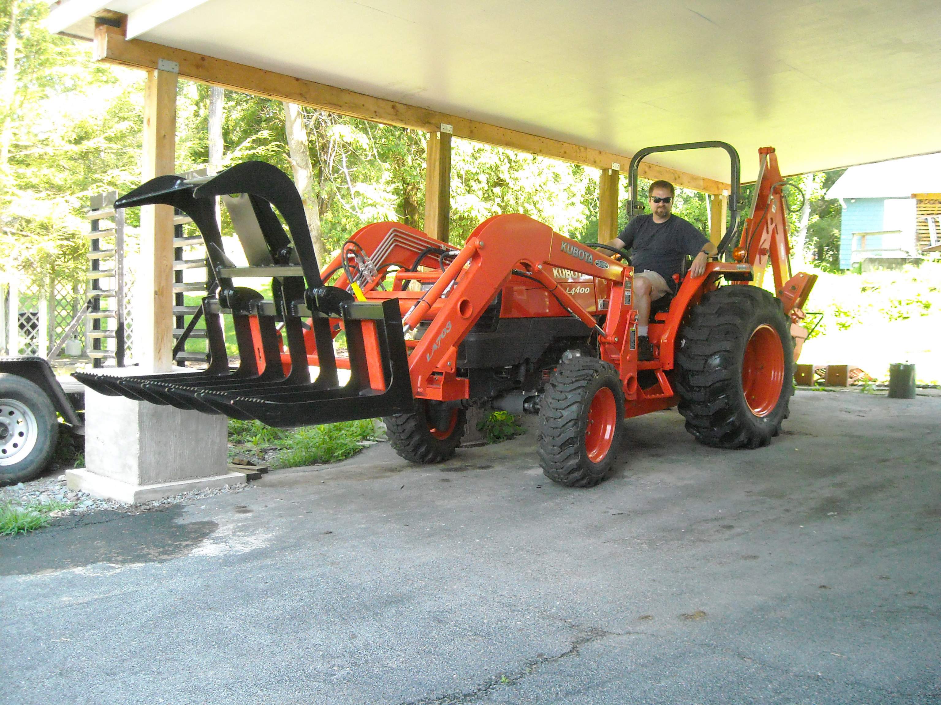

Was the third-function a Kubota item, or another brand? And did you install it yourself or have the dealer do it?
It's a WR Long 3rd function valve, and I had my dealer do the install.
   / Pics of my new Grapple!
#13
Man that is really nice. I have never had a grapple, does it increase the risk of grille / front end damage from sticks and stuff?
It really looks awesome though, rarrrr! Go get em!
I plan to weld a piece of expanded metal across the back of the grapple to reduce the possibility of a stick/log poking through and hitting the grill or the hyd fittings going to the grapple arm.
Stu
   / Pics of my new Grapple! #14
I just bought the markham 60 inch Grapple, and I never thought about a stick poking through. Maybe a piece of walkway grating like we use on cat walks at work will do the trick, and keep visability high. I'll let you know.

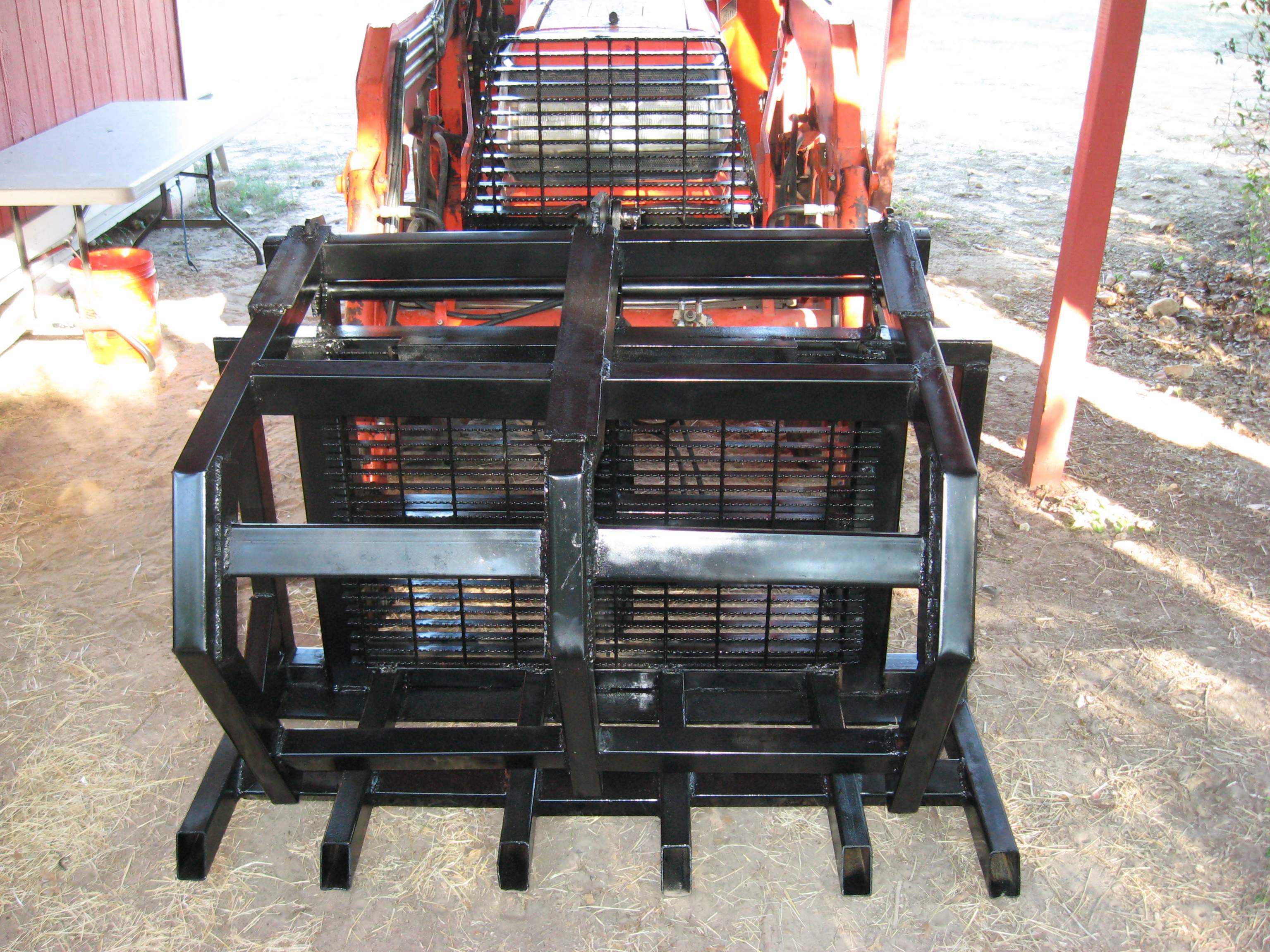

The WR Long kit works well - I have one on L4310 - the only issue I have had is the crimp on one of the hoses went bad after about ten hours...and PAIGE TRACTORS replaced the bad hose - and paid for half the cost of the other line as well. If you are in Central Texas - check out PAIGE TRACTORS in PAIGE, TEXAS for your WR. Long items.
Your grapple set up looks great - I built my own and on the grill I welded class 1 intergrated safety grate (pricey but worth it).
Look around steel yards / scrap yards - you may find it. I never worry about brush now - as the the spacing is 1 inch by 3 inch rectangle shape.
Good luck with your new grapple.
