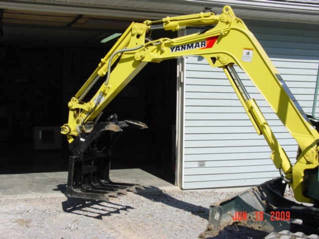

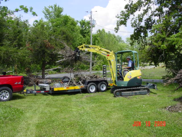

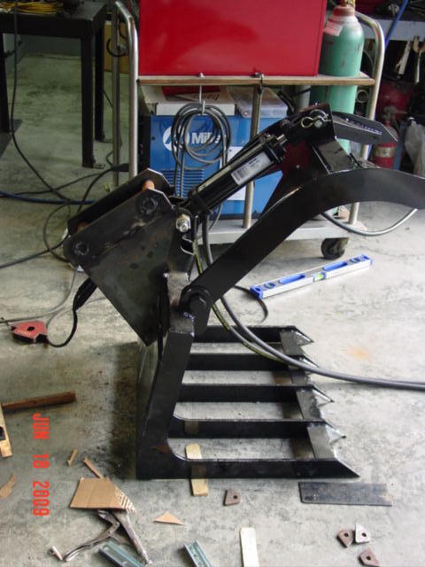

Here is another use for a grapple. I ordered one for a walkbehind skid loader and adapted it to my trackhoe. It is amazing what you can grab with it.
