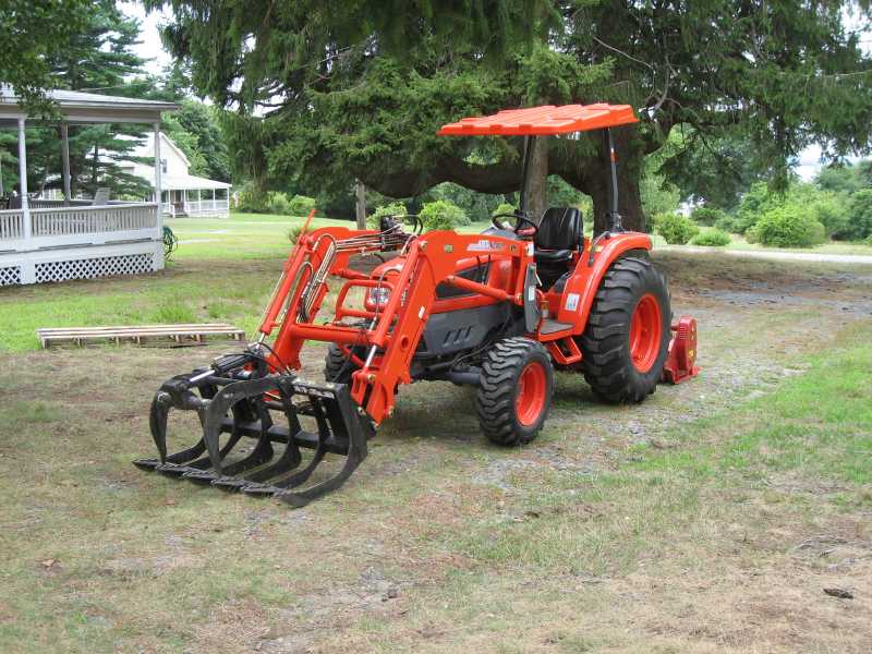

Markham's description of "light duty" is based on them only building skid-steer implements for years. They are new in the tractor world...and don't fully realize that CUT loaders do not have the power of most SSL's, and most CUT owners do not abuse equipment like most SSL operators do. Light Duty to them is Heavy Duty to us!
Agreed! See my pile of concrete in my sig... the grapple is holding up fine.
   / Pics of my new Grapple! #32

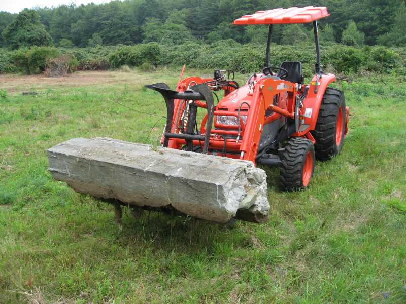

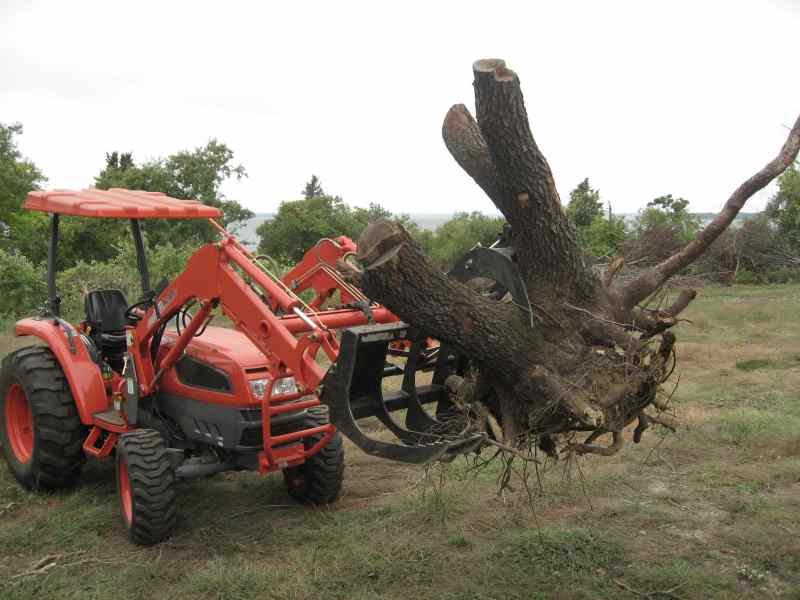

People are scared by the term "light duty" but really shouldn't be. A tractor FEL is not going to overpower a 3/8 inch steel grapple. I use a light duty 48 inch grapple on a FEL with 2700lbs lift capacity and it does a great job ripping up bushes, small trees, big logs and big rocks and concrete slabs. The WRLong grapples are very nice though I think Nelson tends to recommend slightly larger sizes for a given tractor than I would. No one should order a grapple the same size as their primary bucket (for a tractor). Think net lift capacity (always greater with a smaller grapple) and manuverability (always better too). What limits my lift capacity with the light duty grapple is almost always lack of sufficient counterweight on the back of the tractor even when I have a backhoe mounted. In the past 5 years of grapple ownership I have yet to find anything I could not pick up with my light duty single arm grapple that might have been picked up with a wider heavier dual arm grapple. Leave those to the guys with big skid steers.
I have the WRLong diverter valve set up. Works fine. If I were to do it again however I'd probably either splurge on their electric over hydraulic set up or just use a rear remote.

So would you guys recommend a 48" or 60" LD grapple for my little rig? It's 47HP and the FEL has 2500 lb lift capacity. Rear tires are filled and WR Long kit already installed:
   / Pics of my new Grapple! #34
The 60" would fit real nice:D It does have a SSQA doesn't it?
   / Pics of my new Grapple! #35

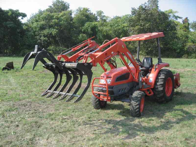

That is a bit heavier than my DK40se but with similar lift capacity. As I've said, I have been perfectly happy with my light duty 48. If you wanted something heavier duty I'd suggest getting either WRLong (if they will do it) or Markham (they will) build you a 48 inch grapple with half inch steel. I don't personally think it is necessary if you are going to use the grapple as it is designed. If you torque a grapple (uneven lift load) then you can destroy even a $3000+ high tensile steel grapple so the point is to use it as designed.

I suggest the 48". I had Markham weld in some spacer tines to help prevent the smaller logs/rocks fall through. I've got 225hrs on my tractor I'd say 60% with the grapple and I have never asked for a wider grapple or another clamp. We just don't have the arse requiring a wider or stronger grapple.
