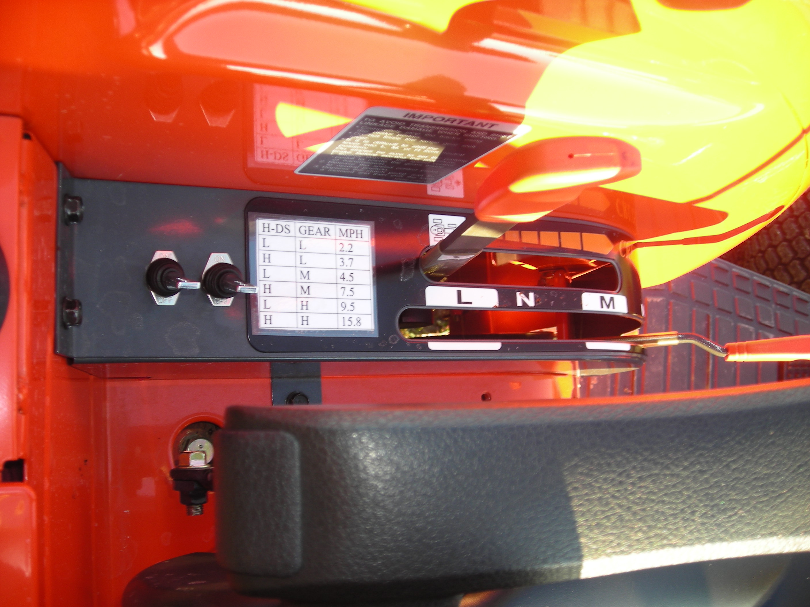

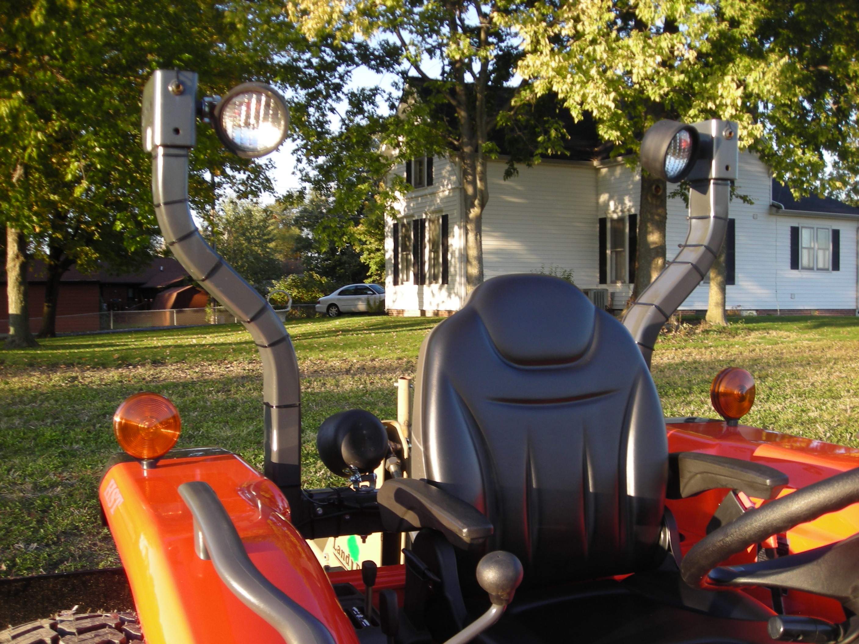

Philip ... What lights do you have attached to your ROPS?
Did you have to modify/ drill, or do they bolt right on?
Where did you get power for them?
What switch are you using?
   / Pics of my new Kubota L3940 #18
NAPA 35W Grote flood.
I had to drill the rops, which did not bother me, others it will.
Starter lug positive side, fused, with proper awg.
NAPA heavy duty marine, one switch for front lights, one switch for rear lights.
I need new pics, all zip ties are off now, I ran wire internally in the rops.
Send me private message with e-mail and I can share schematic, parts list, and more with you. Philip.
