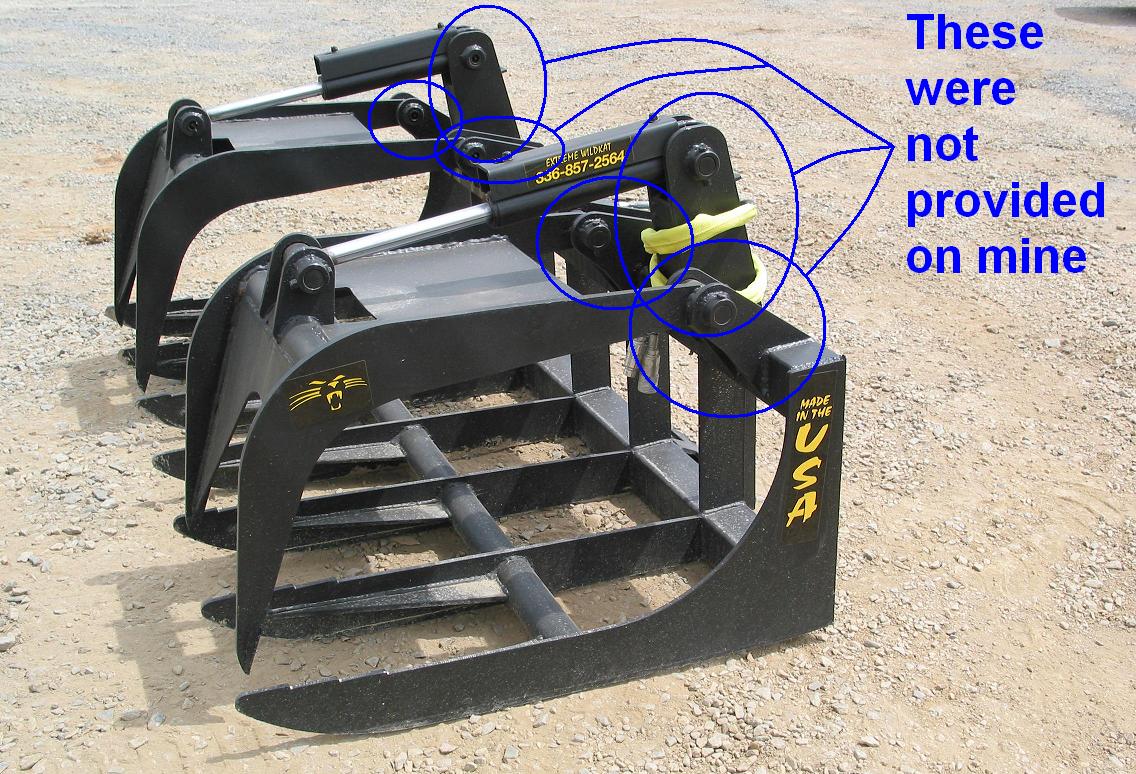

I got a new bucket, actually a grapple-bottom bucket (the bottom half of a grapple), from Wild Kat (in Denton, NC 336-857-2564) off eBay, to let me lift piles of debris/ branches/ bushes or push the teeth into the ground & pry roots/ saplings out. This one is 66" wide & they call it their "HD Deep Grapple" ... "Deep" because the teeth are long for penetrating deep into the ground, & "HD" because this thing is definitely heavy duty! All 7 teeth & their triangular braces are 1/2" thick steel. The verticals are 5/16" steel. I don't know what thickness the horizontal members are, but this thing is really heavy; maybe actually too heavy for my tractor, but so far so good, though I haven't tried lifting anything really heavy with it, yet.
I did have a problem with this bucket in that my Kubota's SS QA securing pins didn't press against the Wild Kat bucket's QA securing surface. There was a gap of about 3/8" - 7/16" of an inch, so the bucket could literally move all around sloppily. I was afraid it would actually fall off, or damage/ twist my loader, so I contacted Wild Kat. They said they had never heard of this problem, but UPS'd me 2 additional "lap plates" to have welded on to take up the gap. I took the bucket & the plates to a local guy who welds, & he charged me $30 to prep the area & weld the plates on. I brought the bucket back to the tractor, tried it out & now the fitment is nice & tight with no more play/slop. I wire-brush cleaned the lap plates, welds & general area, spray painted it black, & it's done.
Other than that issue, this thing is built like a beast! Welds seem really good, strong & complete, running along all edges of all joined metal pieces (as opposed to occasional tacking).
The full, complete 66" HD Deep Grapple is $1,700, & Wild Kat sold me this bottom half for $700 + $162 shipping.

I actually thought I'd be getting the entire bottom half, including the hinge pieces welded on as shown in the pic below, so that I could add the rest of the grapple later if I wanted to, but more importantly to me so the back/ vertical part of the bucket would be a little taller, but you can see in my pics above that they did not provide those. I would think they would if you just ask, though. I didn't realize I needed to ask.

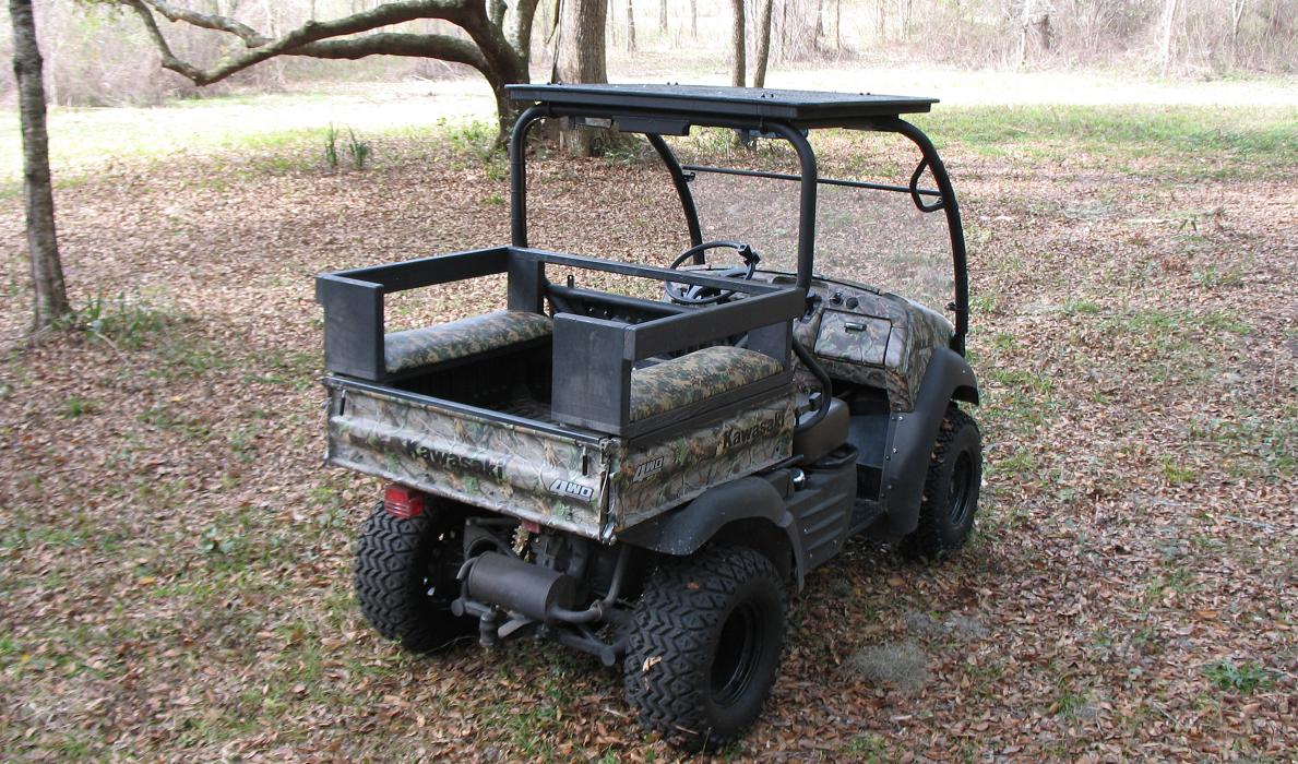

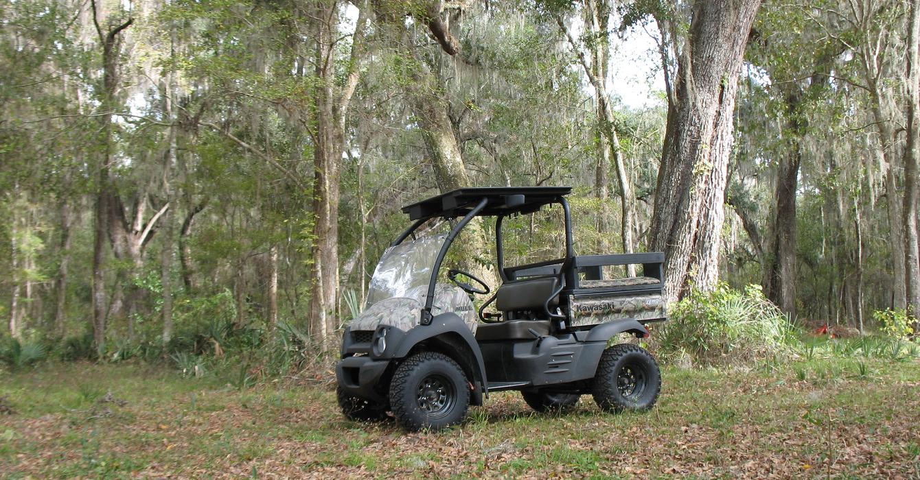

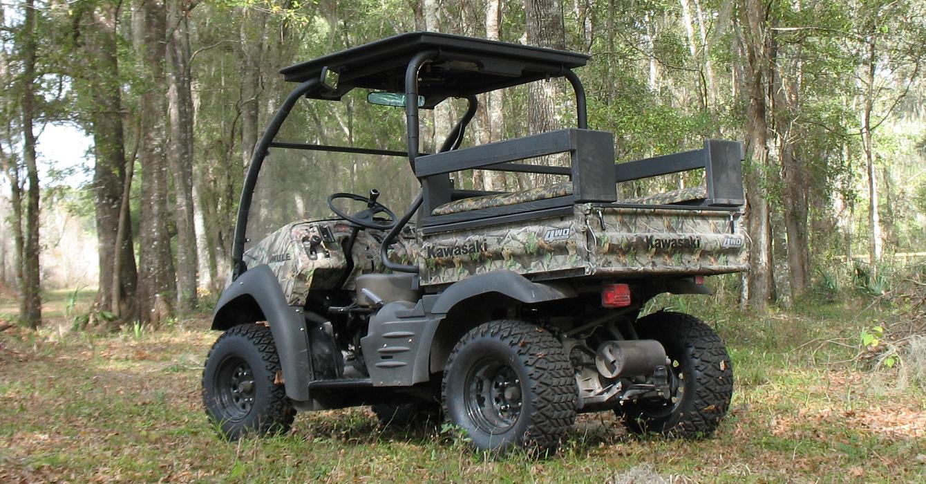

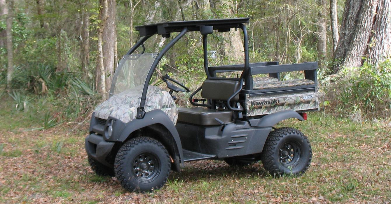

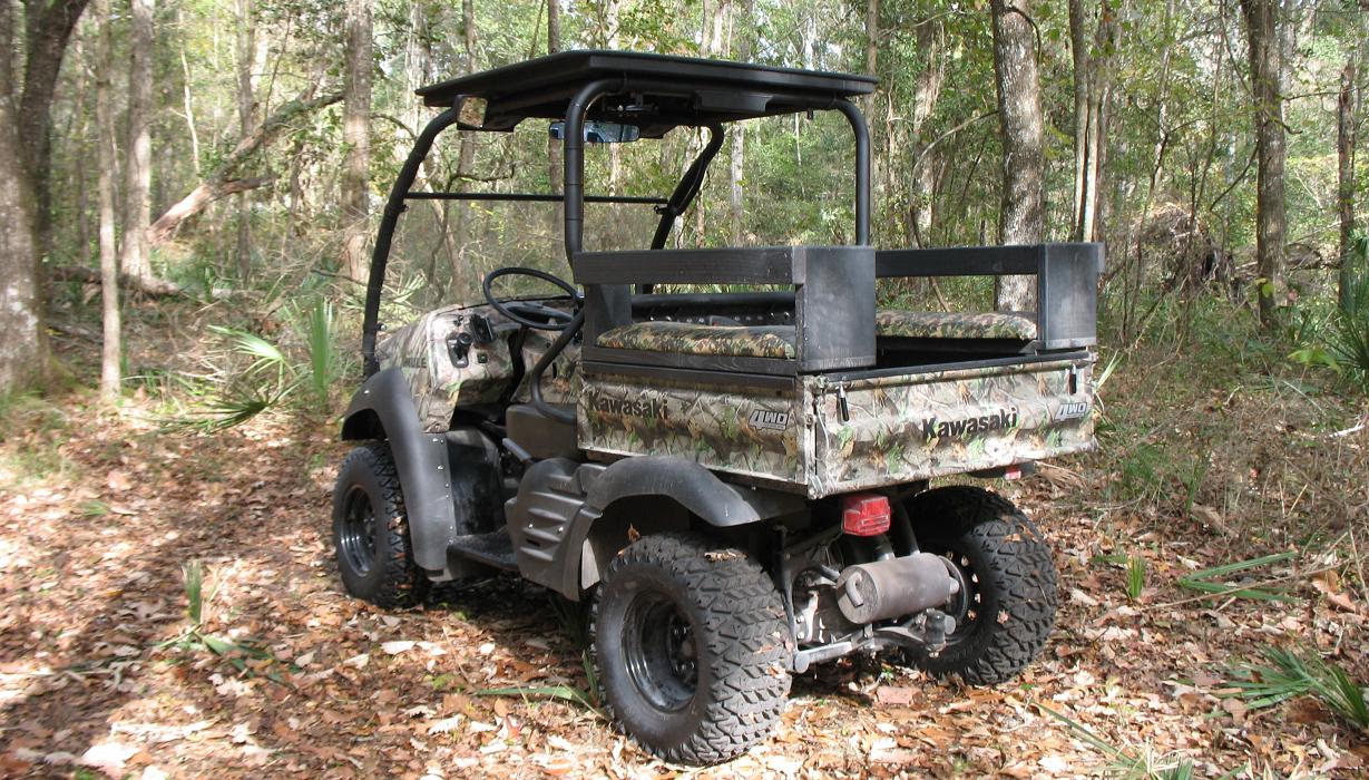

Pics of my '07 Kawasaki Mule 610 Camo:
attachment.php
attachment.php
More ... click on these to see them bigger:
   / Pics of my new Kubota L3940
#89
The pics of my Mule 610 are with new Carlisle All Trail tires on it. Carlisle says they're intended for hard surfaces, & I agree ... They give a very rough ride while riding around on my property. On pavement they're great.
Right now they're at full pressure (20 or 22 psi, can't remember which). I'm going to try reducing the pressure a little & see if that helps.
I wanted something more than the 7 psi max my previous Carlisle AT 489 tires would hold, but this is just too much, too rough, at least at full pressure.

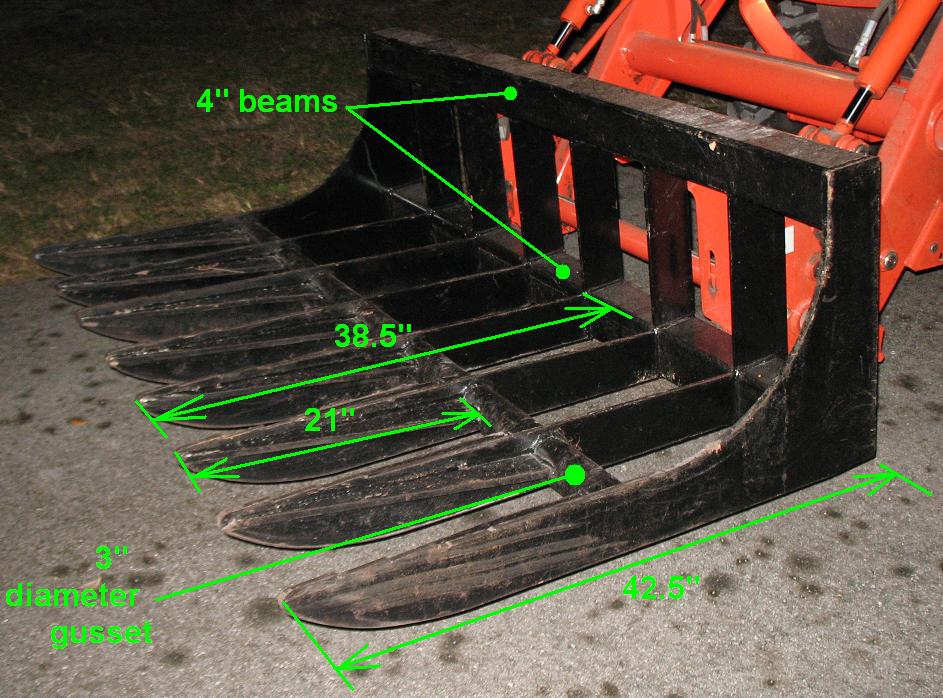

Some dimensions of my 66" wide Wild Kat "HD Deep Grapple" grapple-bottom bucket (the bottom half of a grapple):
attachment.php
