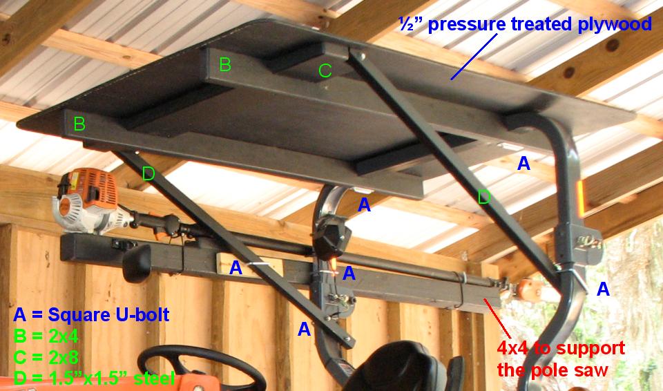

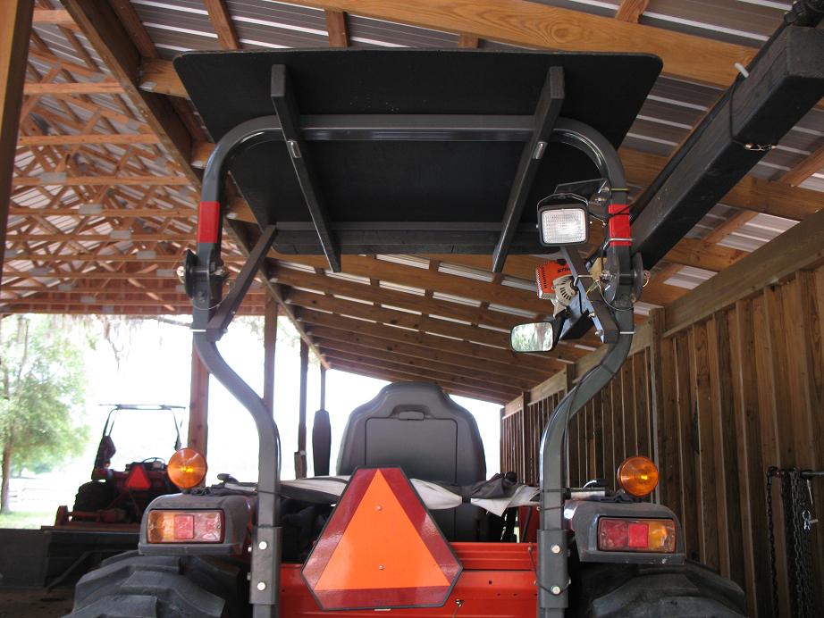

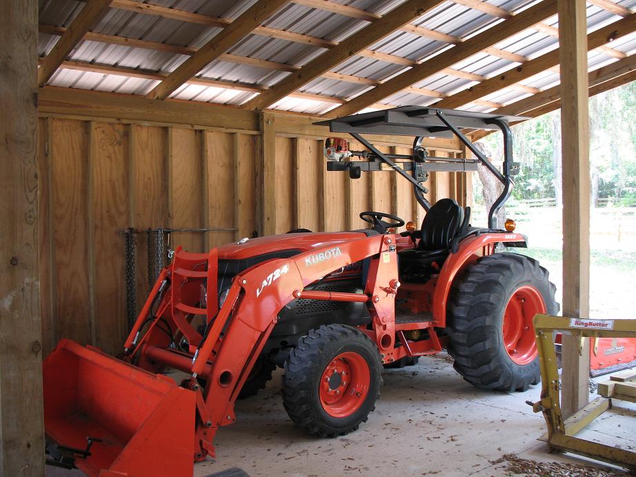

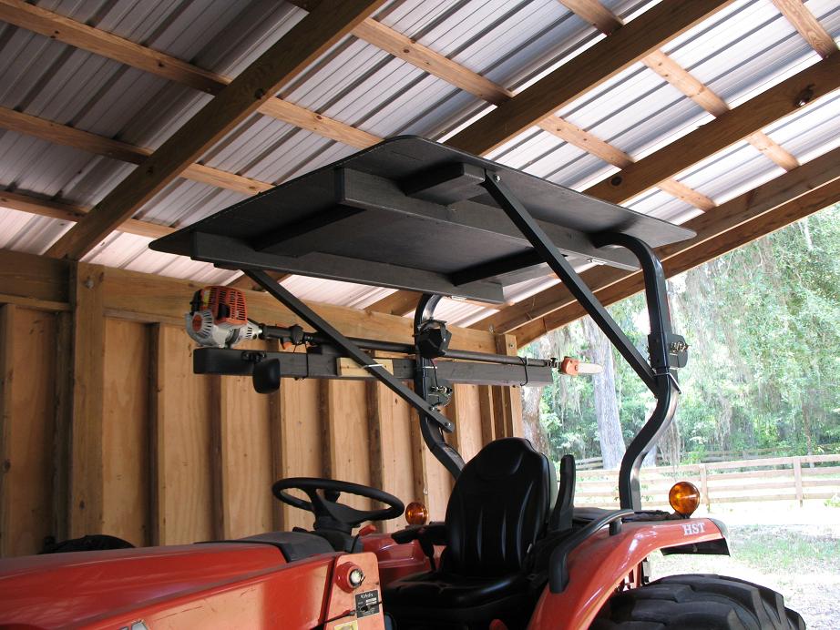

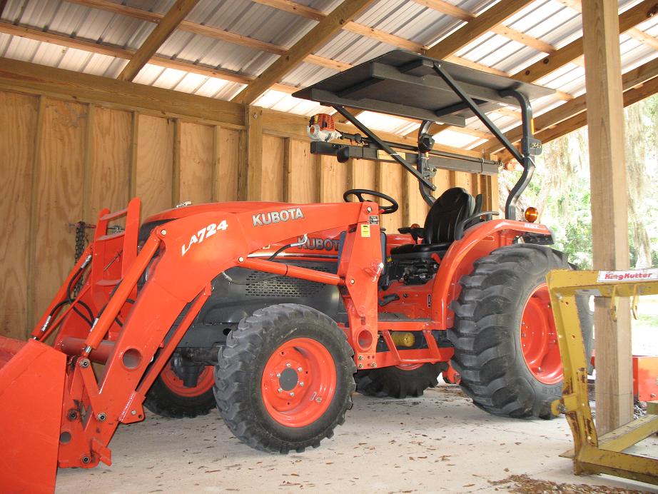

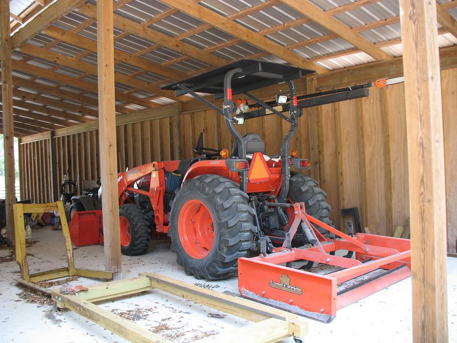

The plywood roof I made:
attachment.php
attachment.php
attachment.php
attachment.php
attachment.php
attachment.php
attachment.php
The roof is 1/2" pressure treated plywood, the full 48" wide & 67" long (need to measure it).
Under the roof are two 2x4's with notches for the ROPS. Also, crossways under the roof is a 2x8.
The 2 diagonal supports are 1.5"x1.5" steel square tube members.
The roof & the 2 diagonal supports are connected to the ROPS using square U-bolts.
I used a plate from the kitchen to draw the rounded corners, then cut them with a jig saw. Then routed the edge of the plywood, top & bottom with a little corner-round (quarter-round?) bit.
I painted the entire thing with black fence paint from Tractor Supply. That stuff is great: Covers great & doesn't require perfect surface prep.
I believe the cash outlay for this roof was about $100. About $25 for the plywood. Maybe $5 each for the 4 U-bolts. I already had the 5-gallon container of paint. The steel was something like $14/ each. A couple 2x4's & a 2x8.
Feel free to ask questions if you have any.
Edit: Forgot to menton, with the plywood sitting right on top of the ROPS like this, with the supporting 2x4's below the ROPS as you see, this only increases the tractor's overall height by about 1 inch (1/2" for the plywood plus ~1/2" for the threaded ends of the square U-bolts coming up thru the plywood).
Edit 2: I used the 2x4's & 2x8 like this because I want to be able to stand on the roof & cut limbs very high with the pole saw. I haven't actually tried it yet :eek: I will, very carefully(!), just haven't needed to yet.

Nicely done,
Dont mind if I copy it, it is a winner.
Sure, no problem - As long as when you talk about it, you call it "The Beppington" ... OK, or "The Bepp" for short :laughing:
   / Pics of my new Kubota L3940 #74
Nice project...may also copy after I get through several other projects, thanks for the pics and detailed list of items.
