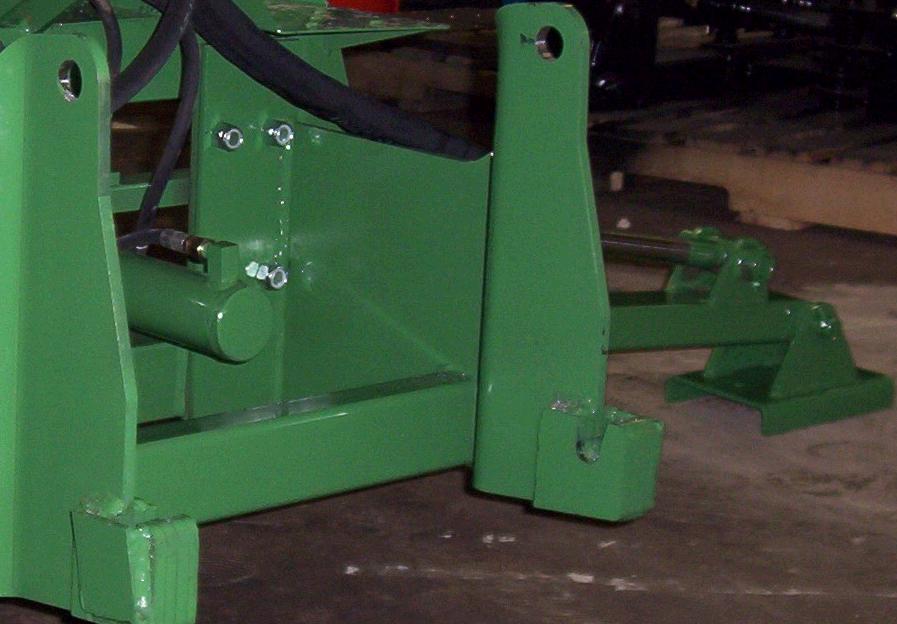

   / Picture of Wallenstein Backhoe on JD2210 #11
Pic 2.

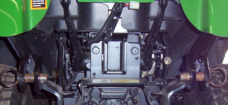

   / Picture of Wallenstein Backhoe on JD2210 #12
Pic 3.

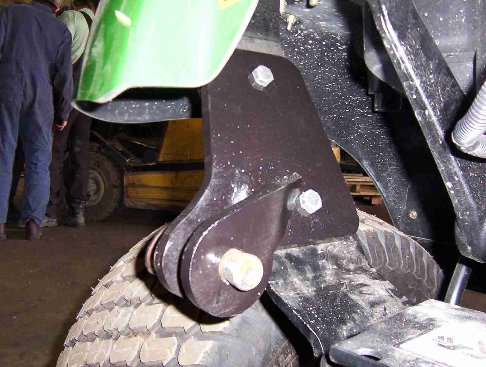

   / Picture of Wallenstein Backhoe on JD2210 #13
Here's one more of the upper bracket. There is no additional frame strengthening pieces added to the frame.
   / Picture of Wallenstein Backhoe on JD2210 #14
Let\'s twist again, like we did last summer!
I don't think I'm going to attach one of the buggers to my 2210 - just not enough meat for a hoe, I can already see the hydro cases twisting, then breaking into expensive little pieces.
I can't believe Deere would even allow them to "demo" a tractor setup this way.........guess the papers from the Deere lawyers will be next.

   / Picture of Wallenstein Backhoe on JD2210 #19
Re: Let\'s twist again, like we did last summer!
The Wallenstein frame mount system for the 2210 "works" because it does have a full frame all the way to the rear of the tractor. Although I would like to see them add some reinforcement to the frame to help handle the stress of the hoe. The 4010's frame does not extend all the way to the rear of the tractor so it needs a different type of mounting system. It uses a subframe that basically hangs from a stronger 3-point mounting bracket bolted to the transaxle housing. The subframe has 2 long tubes that extend all the way to the loader mounting brackets. This effectively transfers most of the load to the front of the frame where it is much stronger. There is a nice post of someone's 4010 & 46BH. He also posted some nice pictures that may help you visualize what I'm saying.
