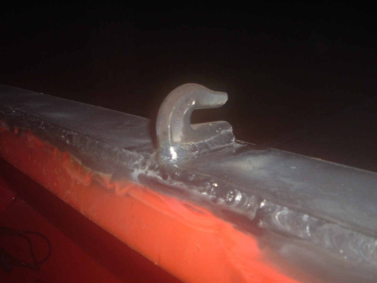

Here is a photo of a weld on hook, It has a flat base, and beveled correctly on the sides, and is not coated in zinc! They are about 5 dollars at the farm store, or you can order them over the internet.

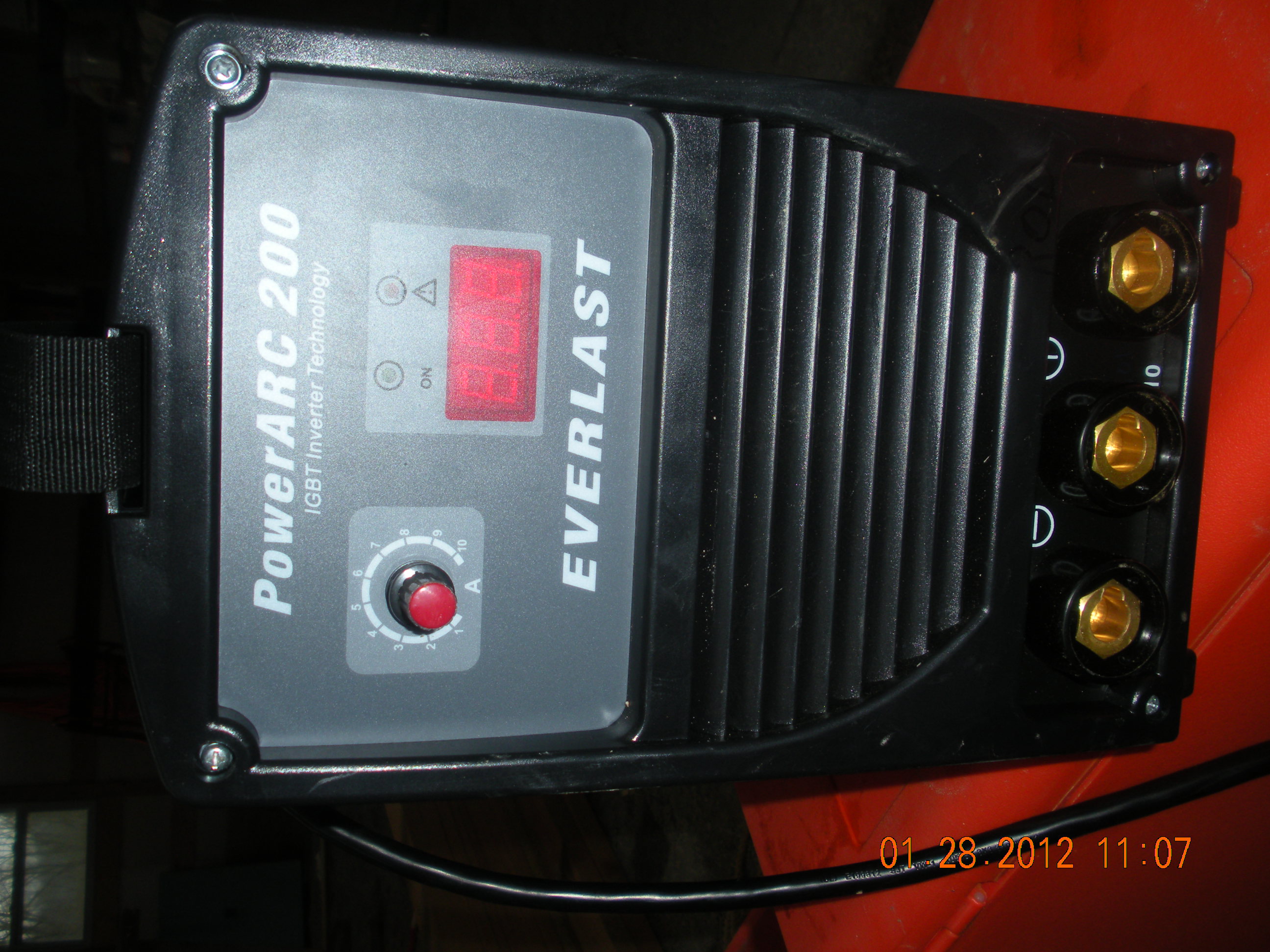

this is the welder i got from mark, i am currently running it on a generator { no electric in the barn, yet ]
all i can say is you guys are the greatest, advise from those that know PRICELESS & no one coming down on me for my sloppy welding
thank you.
i bought some 6011 last night i`ll try it today. blankets ordered, new helment & cheater lenses ordered monday. different rods & leather attire i will get monday
not sure from where i`ll check out the links ya`ll sent me.
thanks again, candyman

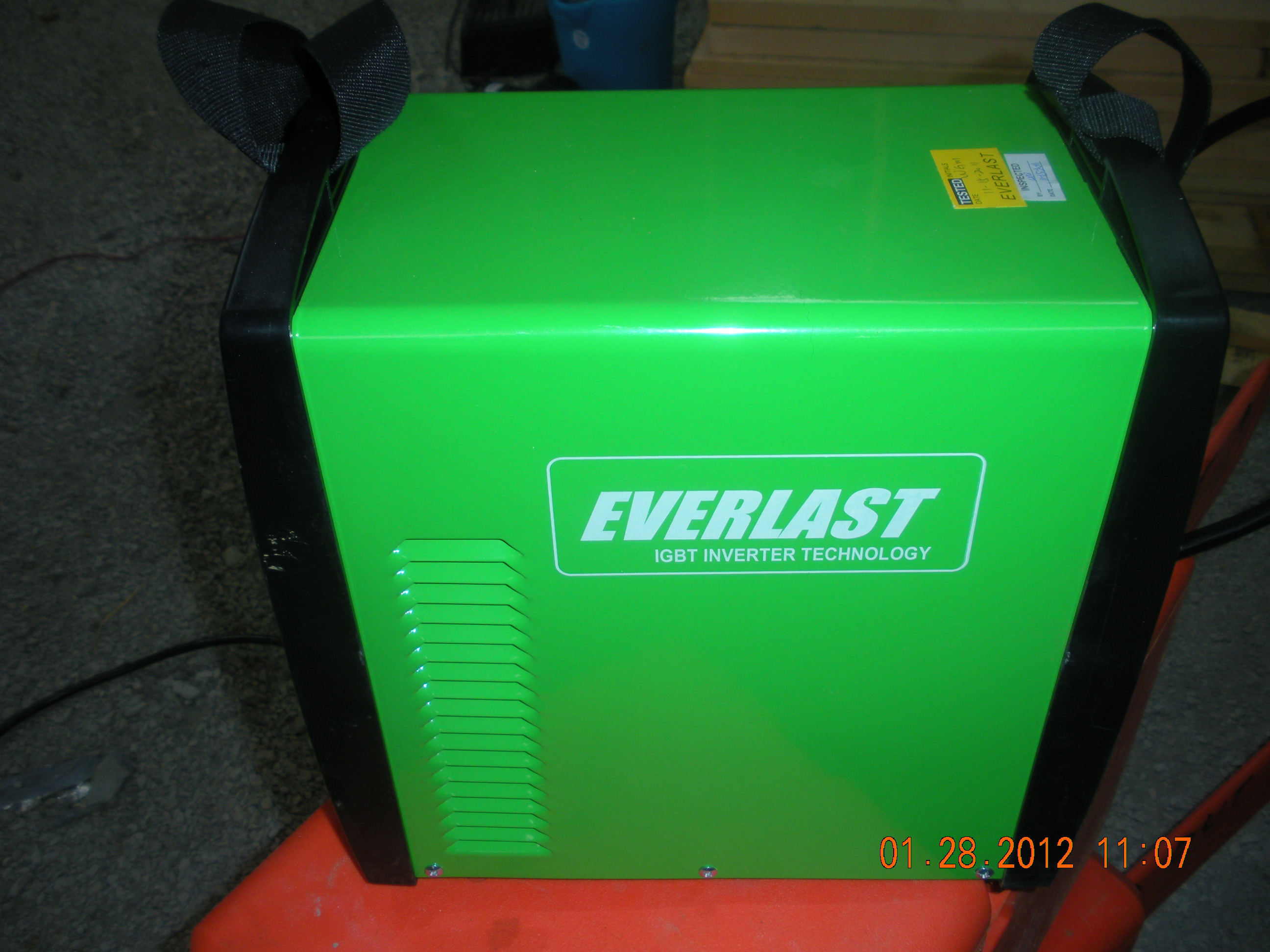

When did Everlast go from green to black cases? I like the green so much better!
Ian
The generator could be part of the welding inconsistencies.
Post the welder brand, model, and output on here. Mark from Everlast is quite familiar with what kind of generator and output needs to be used for effective welds with the PA200. (Maybe a photo, too.)
It is possible to do damage to your welder with an incorrect generator.
Ian
The front bezel and rear bezel are black. The metal case is still green.
Of course everybody has their opinion, and I might be a little more demanding of welding equipment than most. But in my opinion with that PowerArc 200 I have the best luck with Hobart's 335A 6011. ESAB's AtomArc 7018, and ESAB's Sureweld 10-P 6010.
Ah, didn't click the third picture, thought that was the box it was packed in. Thought it strange that it came in a green box. Doh!
Ian
