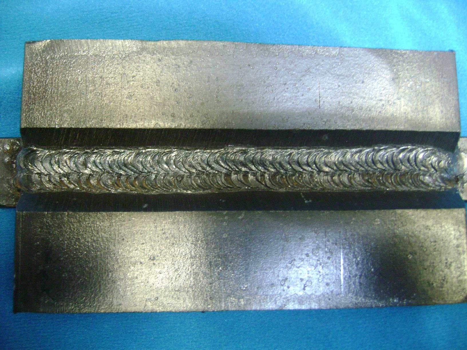

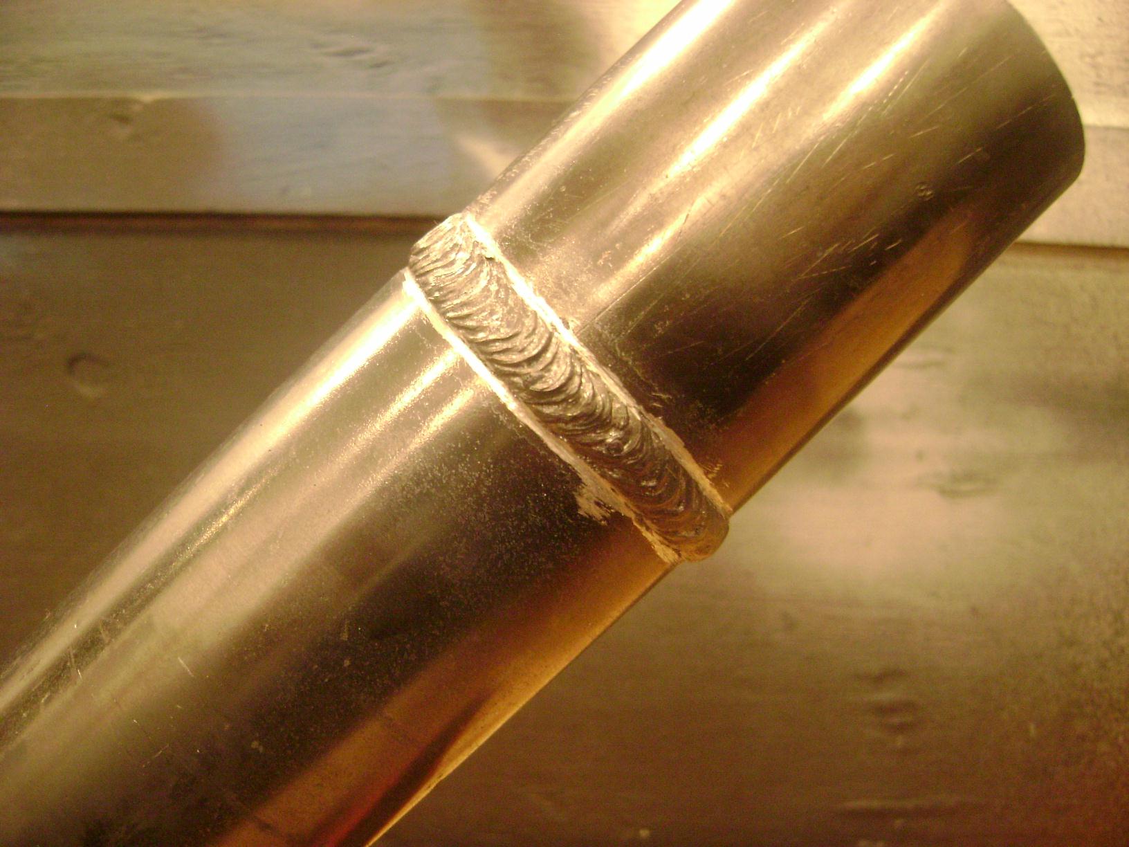

Depends on what I'm doing. Open root pipe / plate I'll run as low as 55-amps, sometimes 65-amps, depending on the gap and land, with 1/8-inch 6010 / 11. For the hot pass I'll run around 72 to 75 -amps. Just general welding with 1/8 inch 6010 / 11 I'll run around 80-amps.
Remember now I'm not a professional weldor, so take my advice with a grain of salt.
Here some 6010 run with a PowerArc 200.

Coulda fooled me.:thumbsup:
HE LIES!!!! (Well, sort of....:laughing:)
He is retired from years and years of welding experience and expertise. Have him tell you about it. Hiding behind the "retired" moniker.

not a pro, huh. for a new welder you are doing quite well. !! awesome welds. !!
