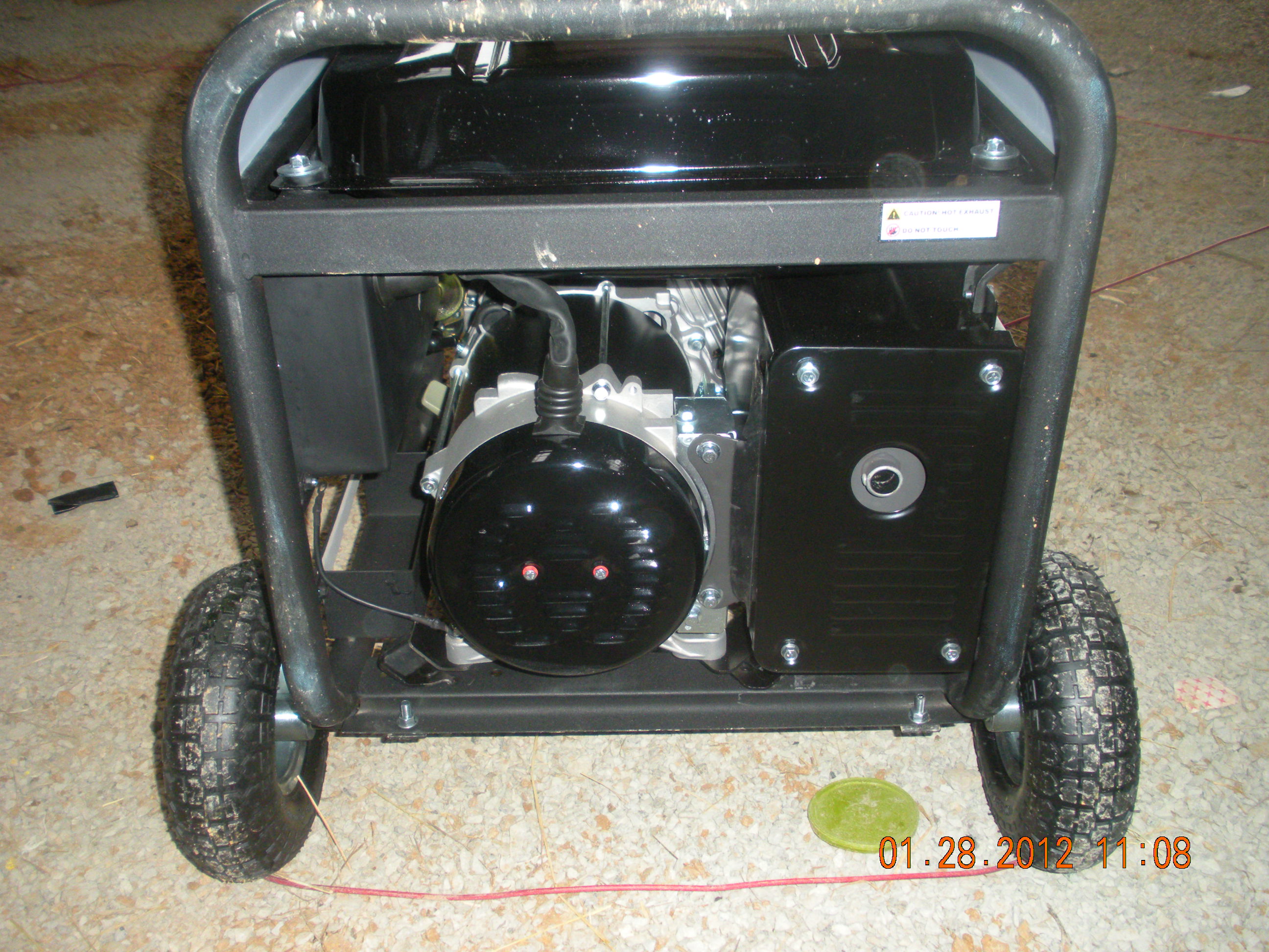

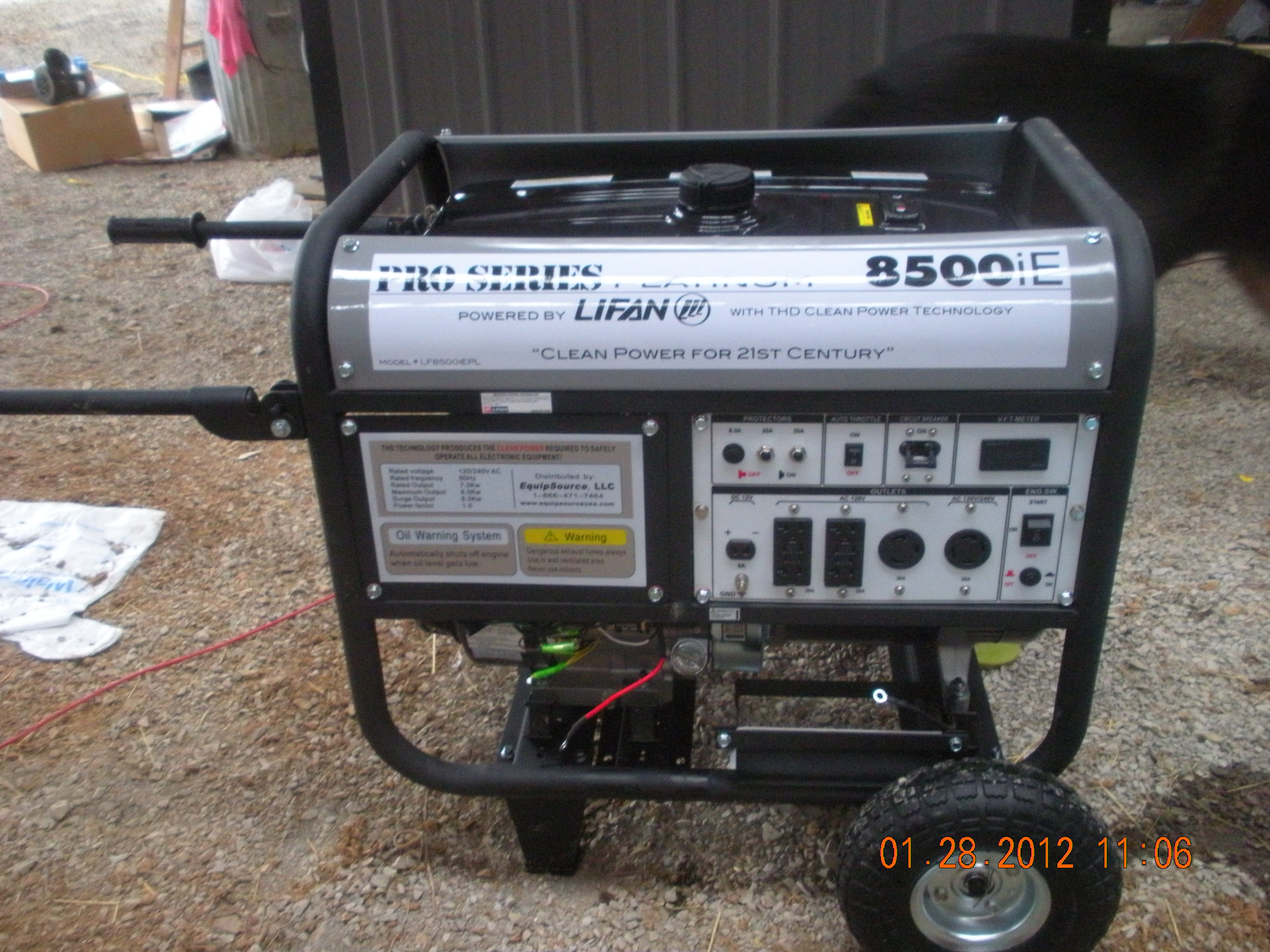

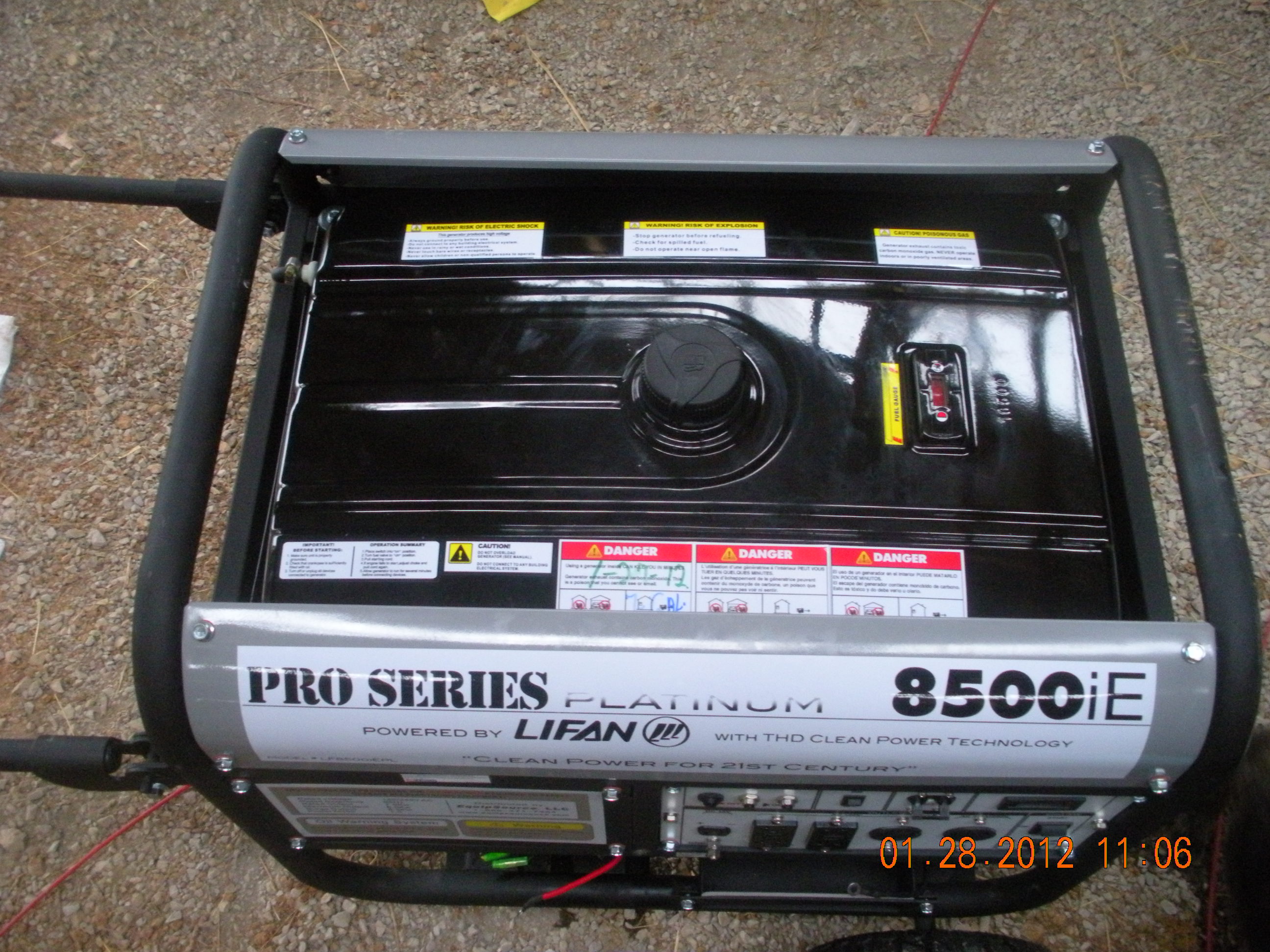

clicked the button to soon, here it is.....

That'll give you some serious welding/cutting power. A real 8500w is close to 40amps 220v and should run about everything a non industrial shop would run.
