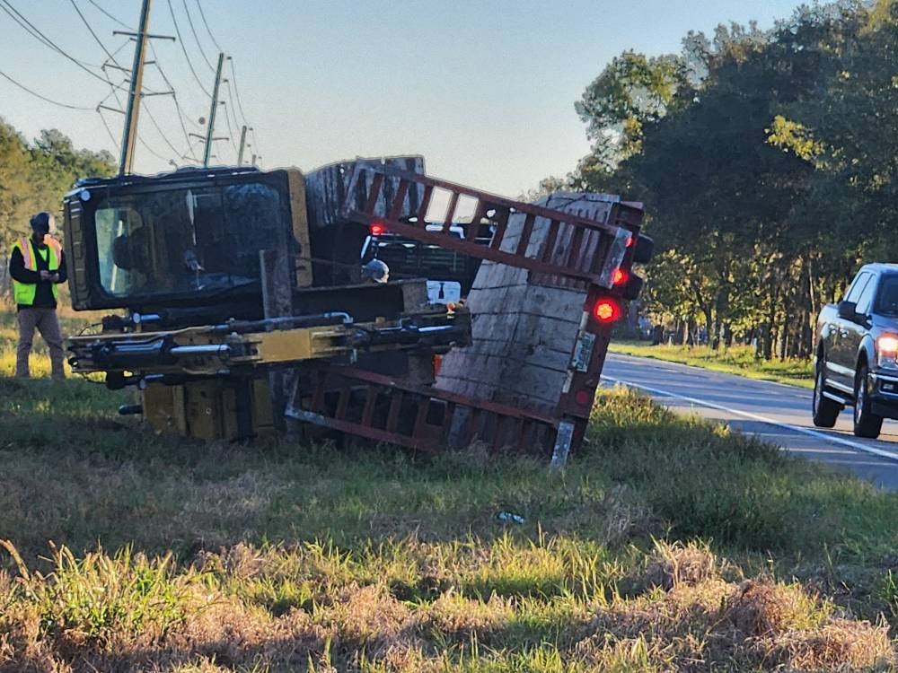

Keeping that center of gravity low is good... saw this headed up Blanding Blvd this morning

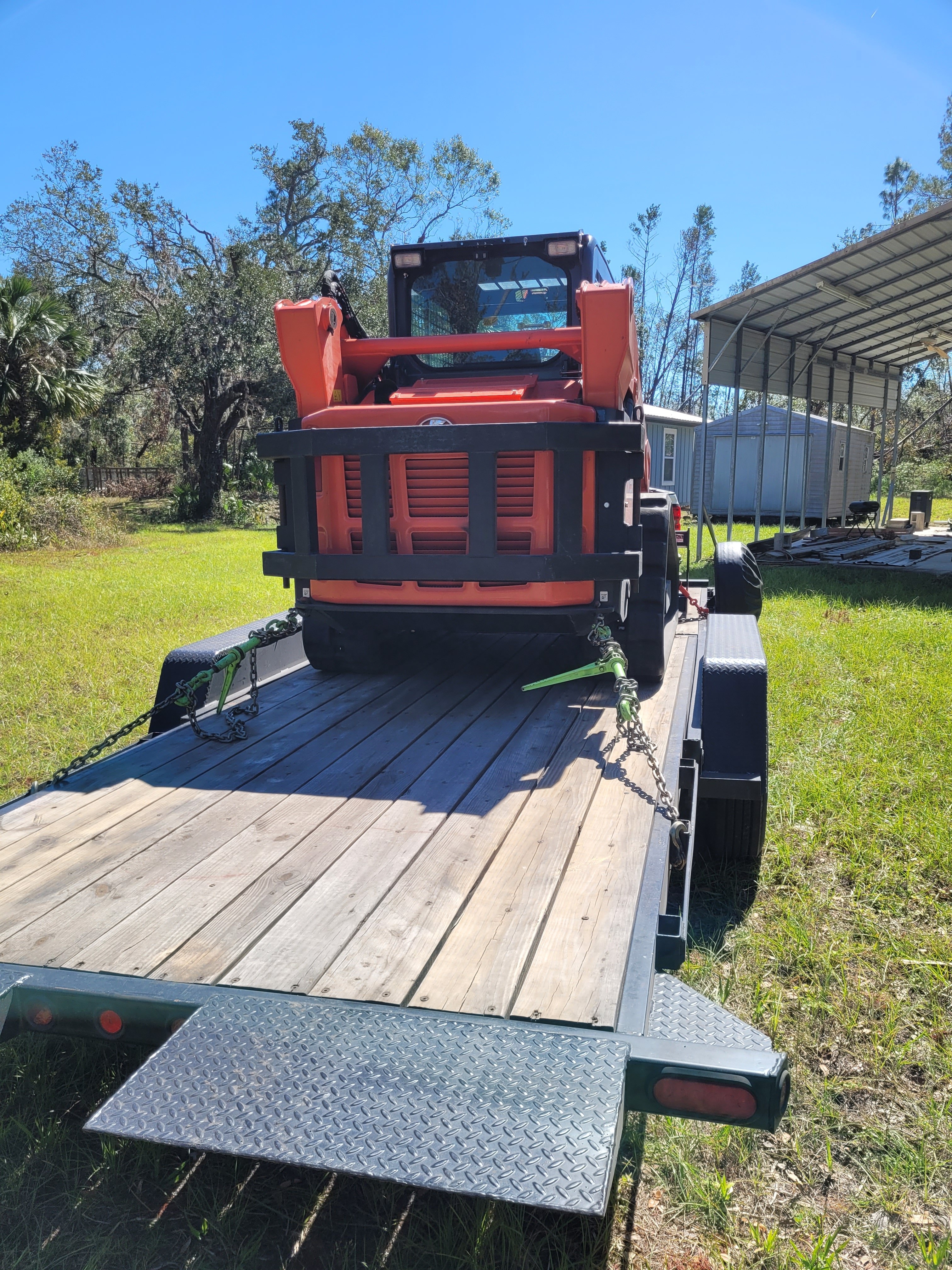

I bind my skidsteer down with chains and a binder at all 4 corners, only takes a few minutes.

Isn't that what DOT requires, though not everyone does it..?
Equipment under 10,000 pounds can use the requirements for automobiles, light trucks and Vans. That only requires being restrained at the front and the rear with a minimum of 2 tiedowns. Above 10,000 pounds has to have a minimum of 4 tiedowns, plus any accessory equipment, such as an FEL or implement on the 3 pt hitch has to be secured.
I do it that way on my tractors using chains and binders at the corners, straps for the implements, even though none weigh over 10,000 pounds. Even smaller equipment such as the Mule or ZTRs gets 4 ratchet straps, 1 at each corner.
