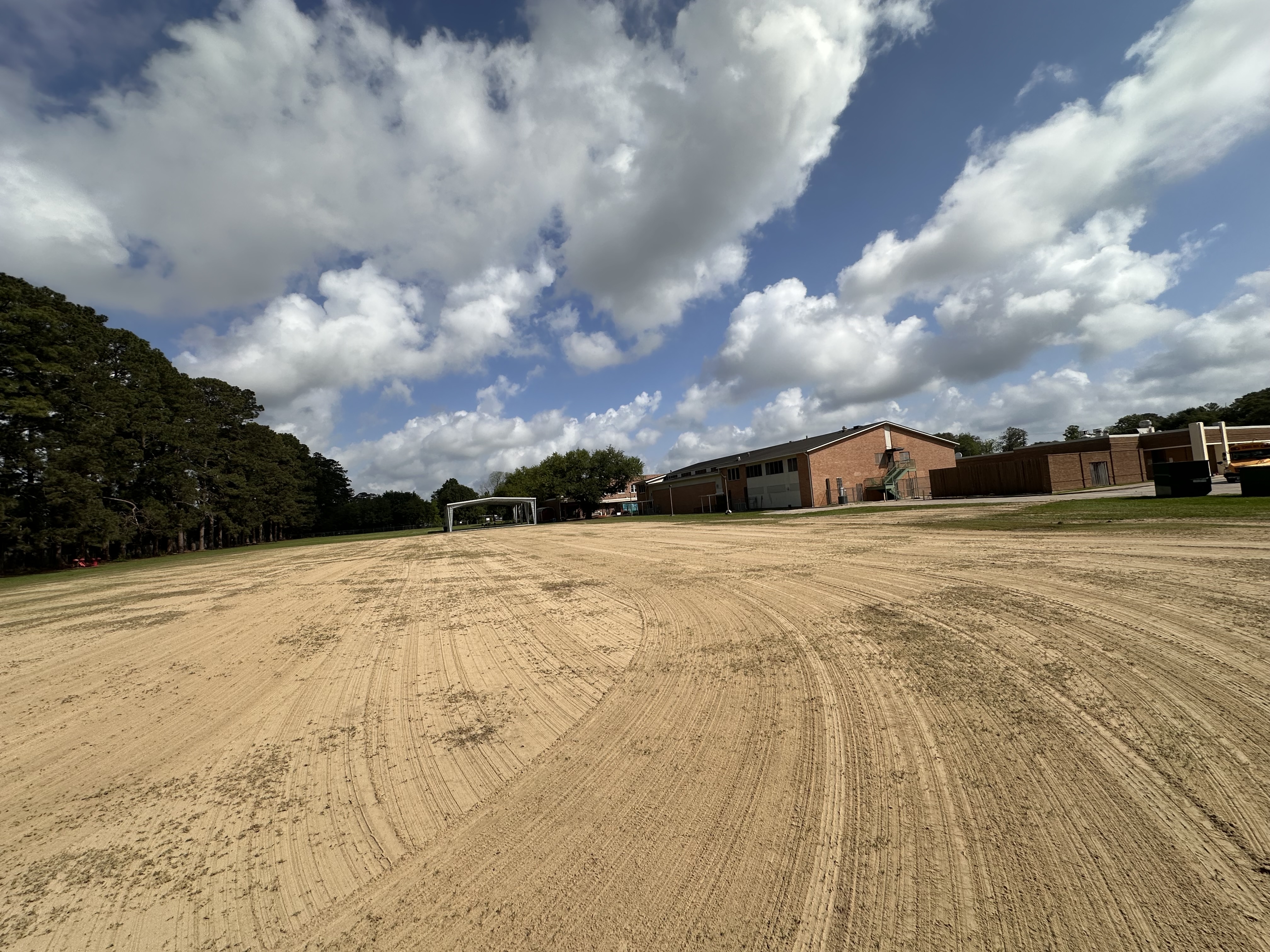

I don't understand sand to add to grass. I've never used it and just graded and worked the ground smooth on larger-size new home lawns. It seemed to me that sand doesn't grow grass that well and would be easily dislodged from where you put it? That has been my understanding.
How does the sand stay where you put it and how is sand a good growth substitute for good dirt?
The sand serves several purposes.
It will smooth out some of the rough spots that tend to build on athletic fields.
It will help the surface to be softer, therefore possibly preventing head injuries
When we aerate and punch holes, the sand will fall into those holes, allowing better percolation of water, and allowing better root growth. This is especially true on heavy clay soils that tend to get compacted.
Sometimes we will put a 'sand cap' on the field of up to 6", if the budget allows, and plant on top of that. This provides excellent drainage and playability after a heavy rain. Again, this makes it softer to help prevent concussions and other injuries. LSU's Tiger stadium has 6" of sand with 12" of limestone below that. This does require a lot more 'spoon feeding' of fertilizer and watering of the grass but provides an excellent playing surface. Much better than fake grass.

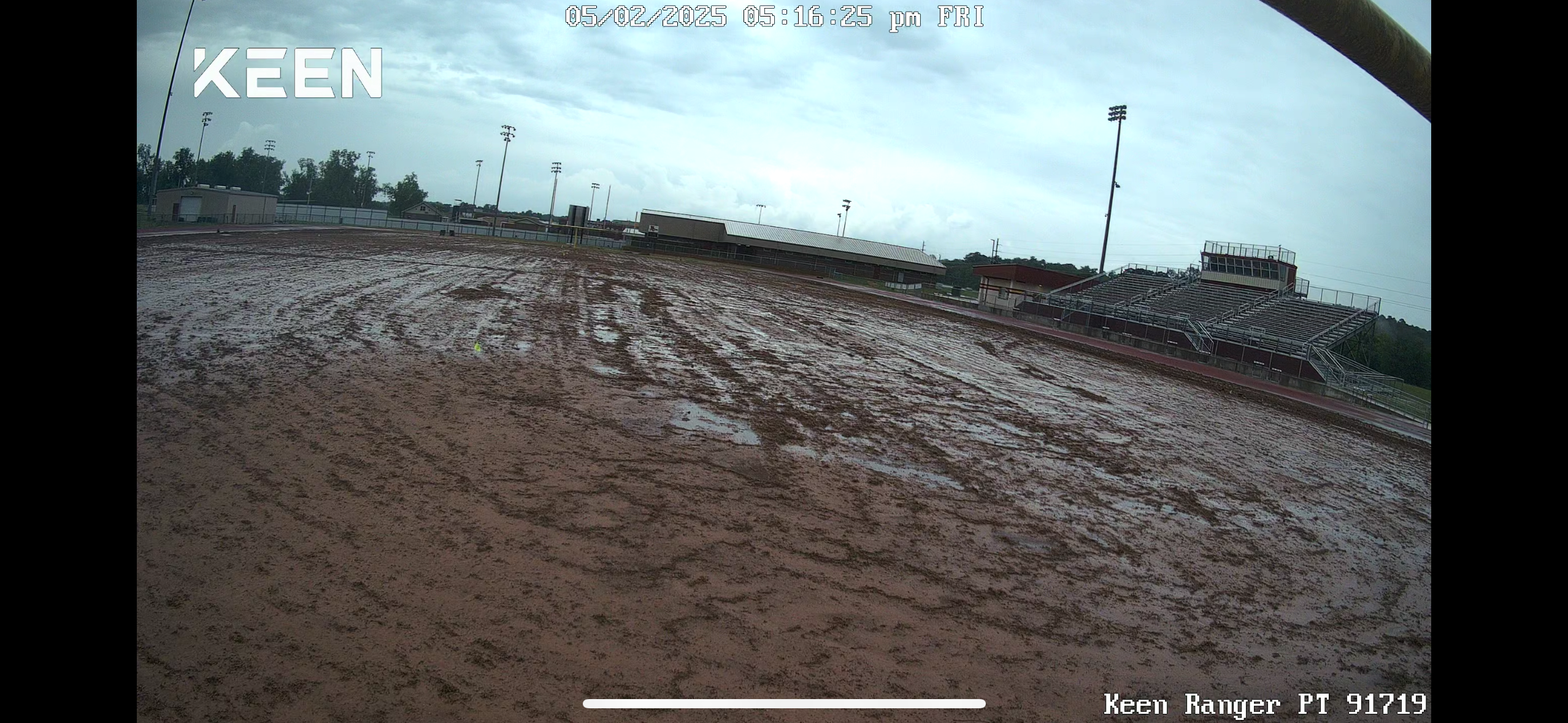

Current situation at the field renovation project. My rainfall app says about 1.25" today.

This is after the sand is spread. It's probably a little more than we needed. And they mowed it as short as he could yesterday. If we get the rain that is predicted for the next few days, it won't look so much like a beach.

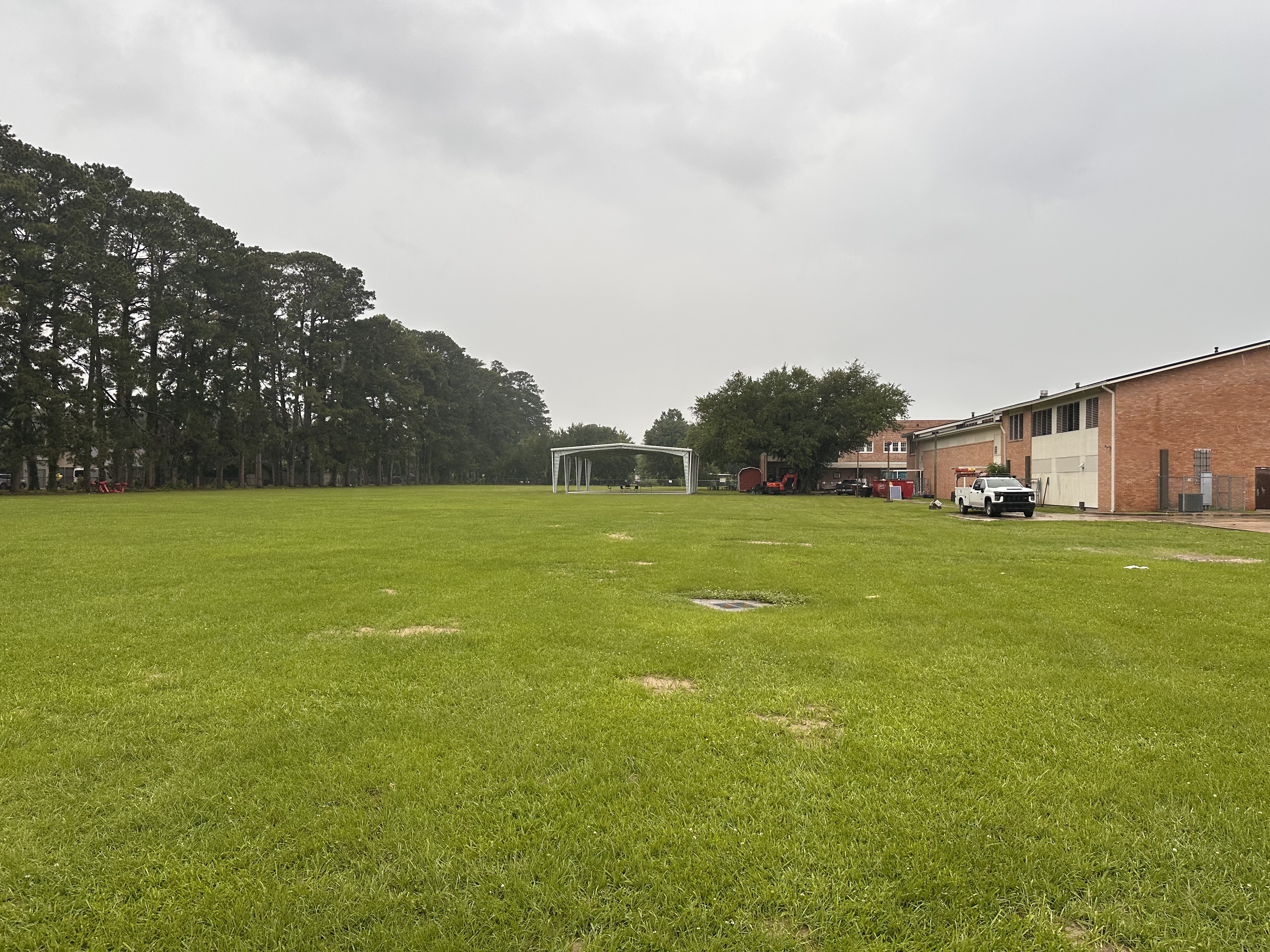

Went by this field today. We spread the sand on April 22 which is about 16 days ago. We've had probably 12-15" of rain since then and it has not been mowed. I'm very happy with how it looks.
