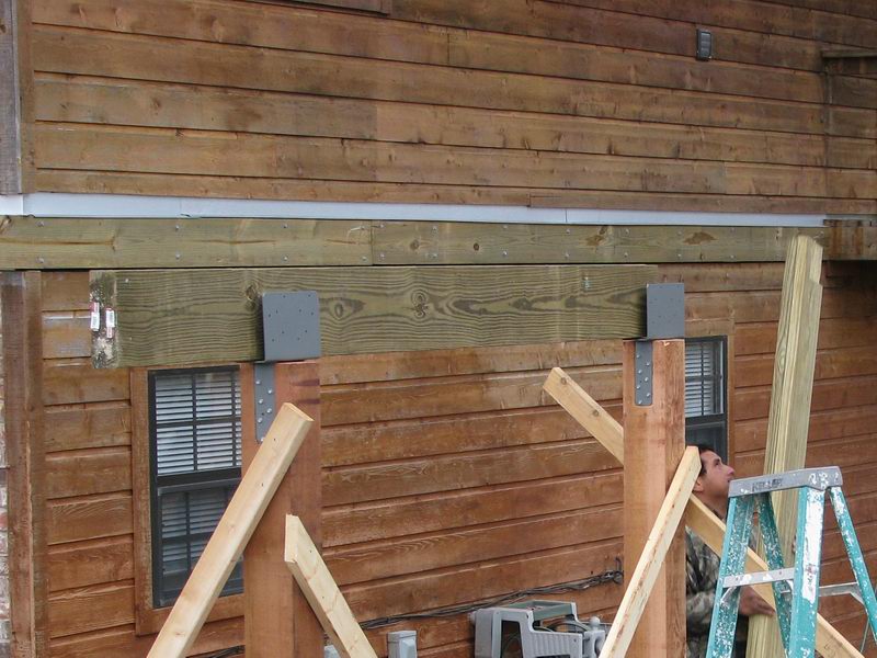

One area of your build we haven't discussed that I was wondering about. Where your new South side deck joins the new East side. Is your plan to extend the ledger on the East side past the house to act as part of the beam for the East side joists? That is what we would do by doubling up the ledger with the last joist on the South side. That is a corner of the house to pay extra attention to the flashing. The extended ledger can act as a path for water to travel back under the flashing at the house.
Mark, on my front deck, the end joists are doubled. I planned to do that for this deck too. That would make that south side deck end at the corner of the house with a double joist. To keep the dimensions true, the ledger would then continue on along this double joist to the south end of the east deck. That would give that area three 2x8s and lots of strength where the two deck sections join. this would be an ideal place for some bolts all the way through. I'm also thinking that to prevent water from running down the ledger and under the flashing, we probably need to make a notch in the ledger so water would drop down and out rather than continuing on down the top of the ledger. It shouldn't take more than a 1" square notch to work as a water trap.

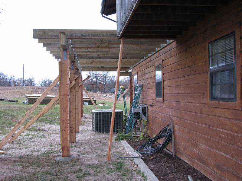

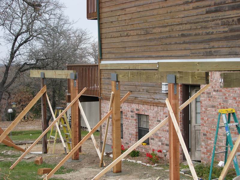

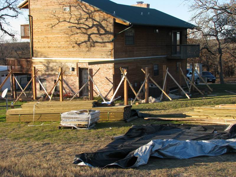

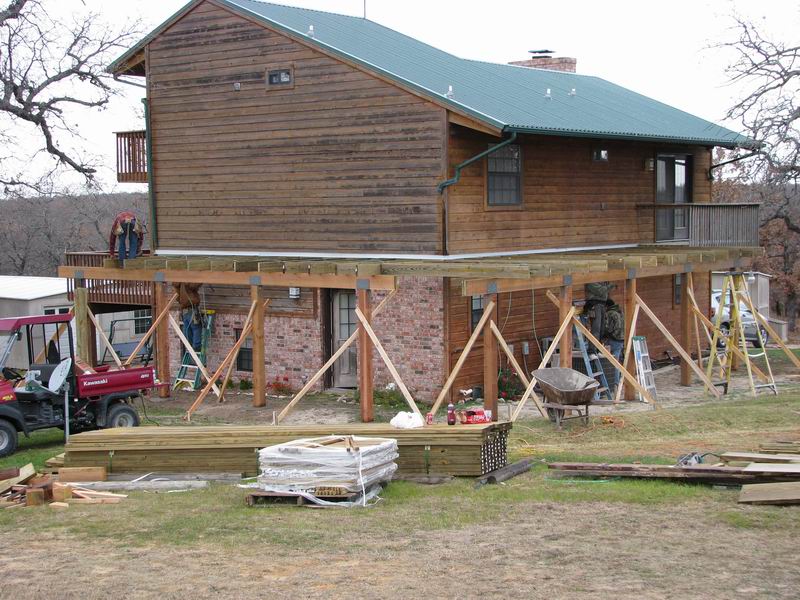

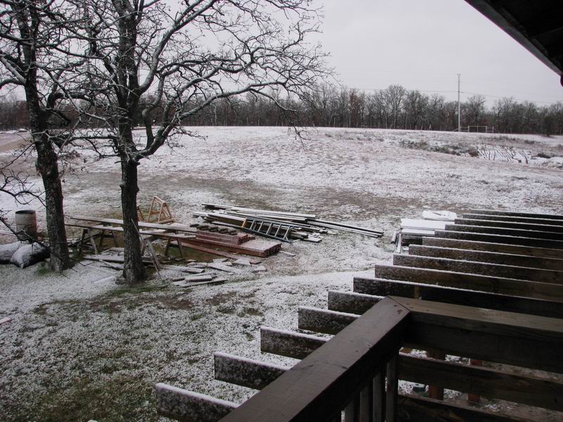

Time for an update. . . .
The deck is progressing nicely. It's not going quite as fast as we thought, and will take an additional day to complete. That's largely due to the weather. It has suddenly turned cool and wet. The crew had to knock off a couple of hours early yesterday because of heavy rain.

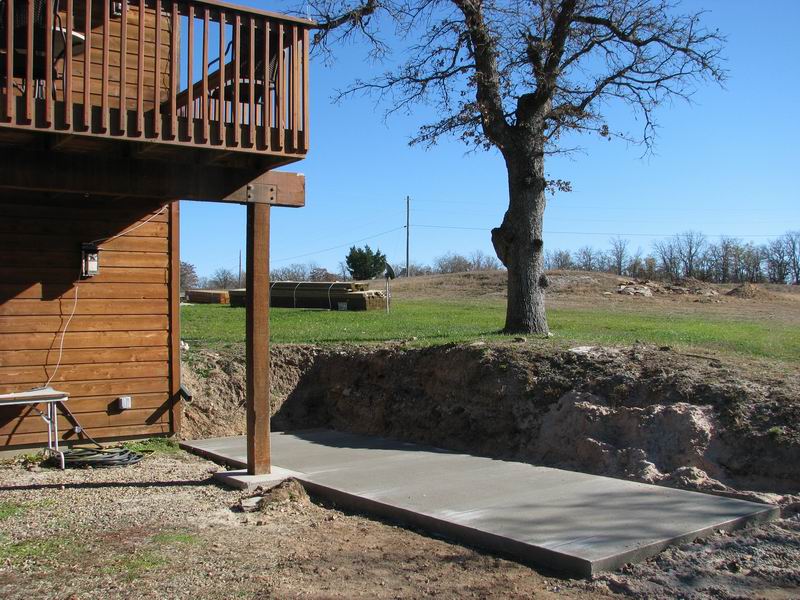

On Monday, we made some final changes to our plan, adding an additional post on the east side deck. That's a total of 9 posts. I had ordered 9 Simpson post caps, so we had plenty of those. I only had 10 of the 10 ft 6x6 cedar posts, so I was coming up a post short for my deck landing. I also needed one post about 12' long. It turns out that I had a creosote post that is 15' long, so I substituted it.
Here are some pictures of the pad for the landing and the posts. As you can see, the excavation for the pad is also under the corner of the deck and needs a longer post so it can sit on undisturbed soil. After the deck is finished, I plan to add a retaining wall in this area around the pad. The other pictures show the column caps going up and the attachment of the ledger and deck joists. If the weather holds, today we will get the deck and steps finished and tomorrow the handrail.
Oh yes! I posted one additional picture of the ledger board with the lag screws installed.
Edit: It is 6:30 AM and I just looked outside to see about 1-1/2" of snow on the ground with slushy snow falling. Oops! Deck building may have just got very interesting.:rolleyes:

   / Pictures of our new deck
#30
The snow was much deeper about an hour ago, but there is still plenty of slushy messy stuff to make building a pain. I haven't seen the framers this morning and suspect they may wait awhile before showing up.
...I know, I know... you guys up north are laughing your hineys off at us. We are such cold weather wimps.:eek:
Like Bird said, this may be the only snow we actually see all winter long. We have to make a big deal of it when we get the chance.:D
