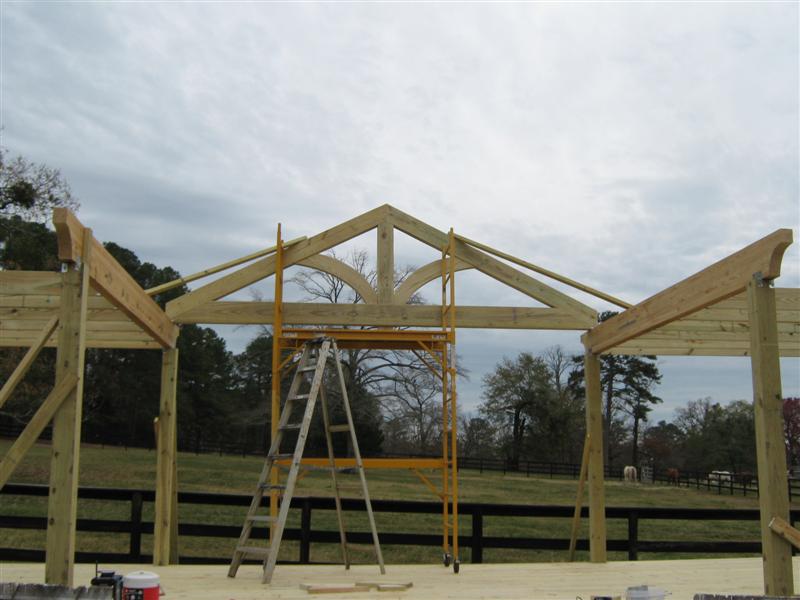

If you look real close, you can see the brackets that I used on the pavilion that I'm building. Mostly, I'm relying on gravity to hold it all together, but to make sure, I use brackets and screws.

I think I've seen those brackets, Eddie. Actually, I don't care what brackets you're using, that's one nice looking job. Wow!:)
