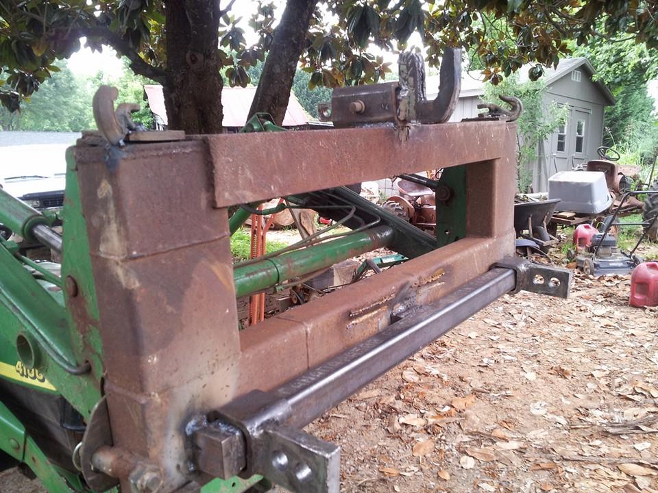

beenthere you did nearly the same thing I did on my FEL View attachment 396063
Hmmm?
I don't have anything like that on my FEL. Is it a plow mount? Looks pretty heavy duty.
Only think I have on my FEL is a bucket or the JD forks.
I did modify the forks so they could be easily picked up with the iMatch quick hitch.
