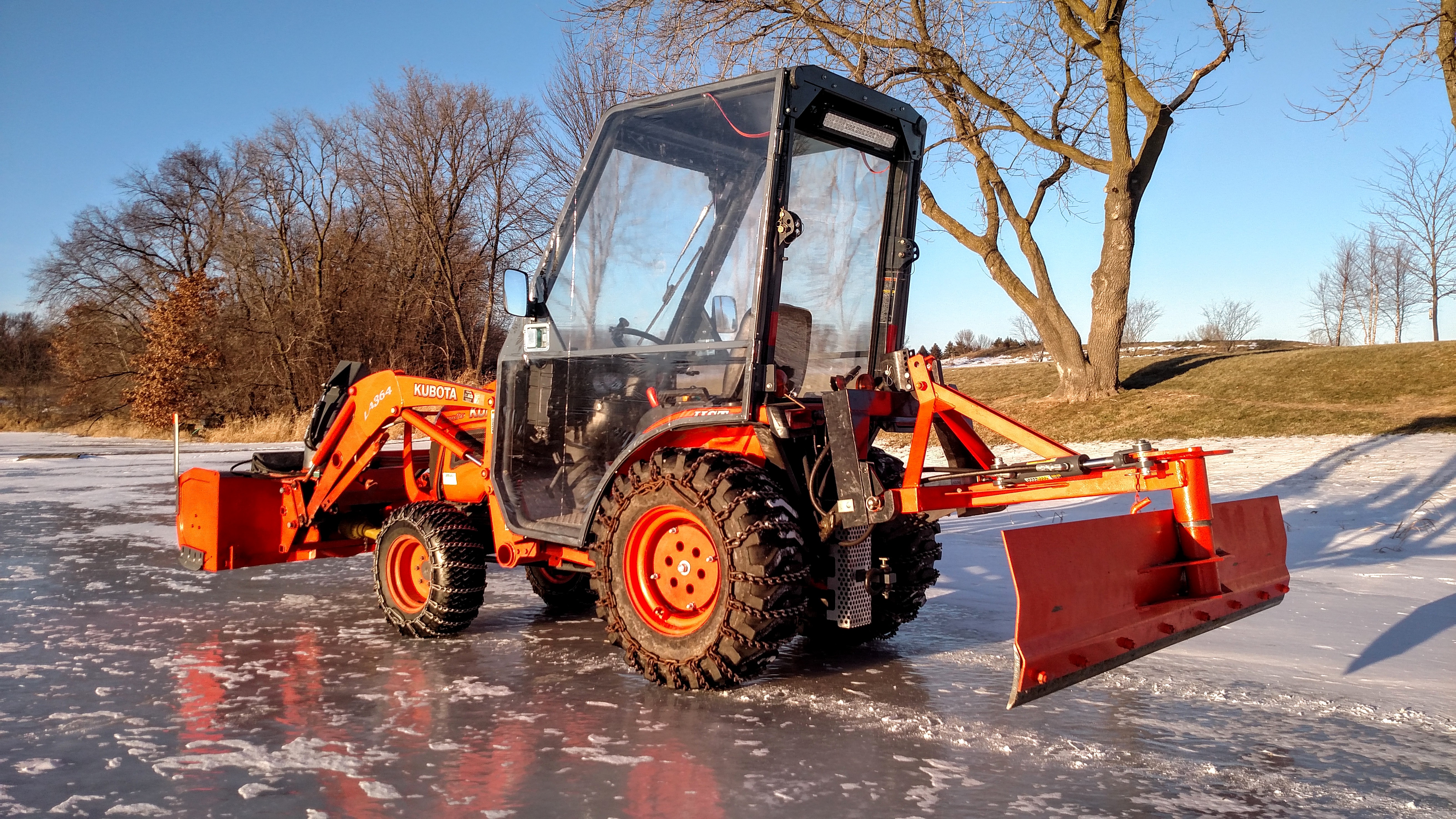

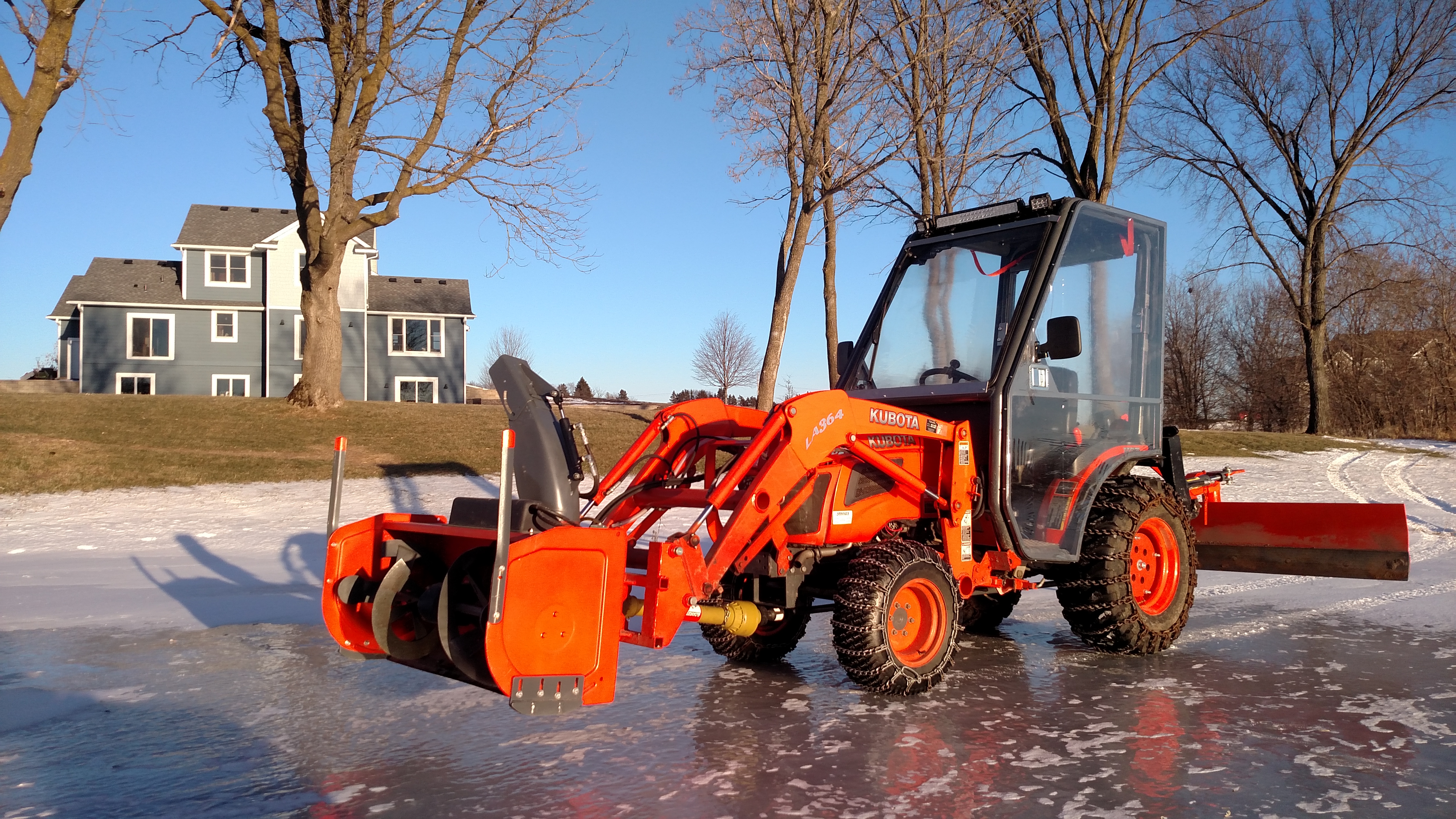

Here's my setup. It's a Kubota B2920 with a loader-mounted JD 47" snowblower. I made a front PTO kit that runs off of the rear PTO to power it. I added 4 auxiliary hydraulic circuits to the tractor and added a hydraulic tilt to the snowblower. The rear has a King Kutter 84" blade that I added hydraulic tilt to as well.
I built the cab myself. Glass front and back windows, wiper, heater. The LED lights are awesome. I wanted the doors to be lightweight so they are covered in shower curtain liners. They also easily lift off the hinges.
I have two sets of rear tires--turf for the summer and the R4's for the winter. I leave the wheel weights (which I made--110lbs per side) and the chains on the R4's and swap them out twice a year. The front tire chains are easy to put on.
I typically use the blade for the light stuff and the blower once it gets piled up. My driveway is 1000' long so I love having the blower out front. Having it loader-mounted means I can lift it about 18" before the PTO shaft starts binding. It also means I can easily swap out the blower for my pallet forks or a bucket, which I like.
-Chris

lakeside
:welcome: to TBN
Nice rig you have, and see you have the dreaded winter ice.
For my likes, I prefer the temp goes below freezing and stays there until time for spring thaw. Usually doesn't happen so we have to accommodate the ice layer.
Great build on the cab.
   / Pictures of your snow weapons #3,406
beenthere,
The pics are actually on the pond behind the house. I use the tractor to clear an ice rink back there.
