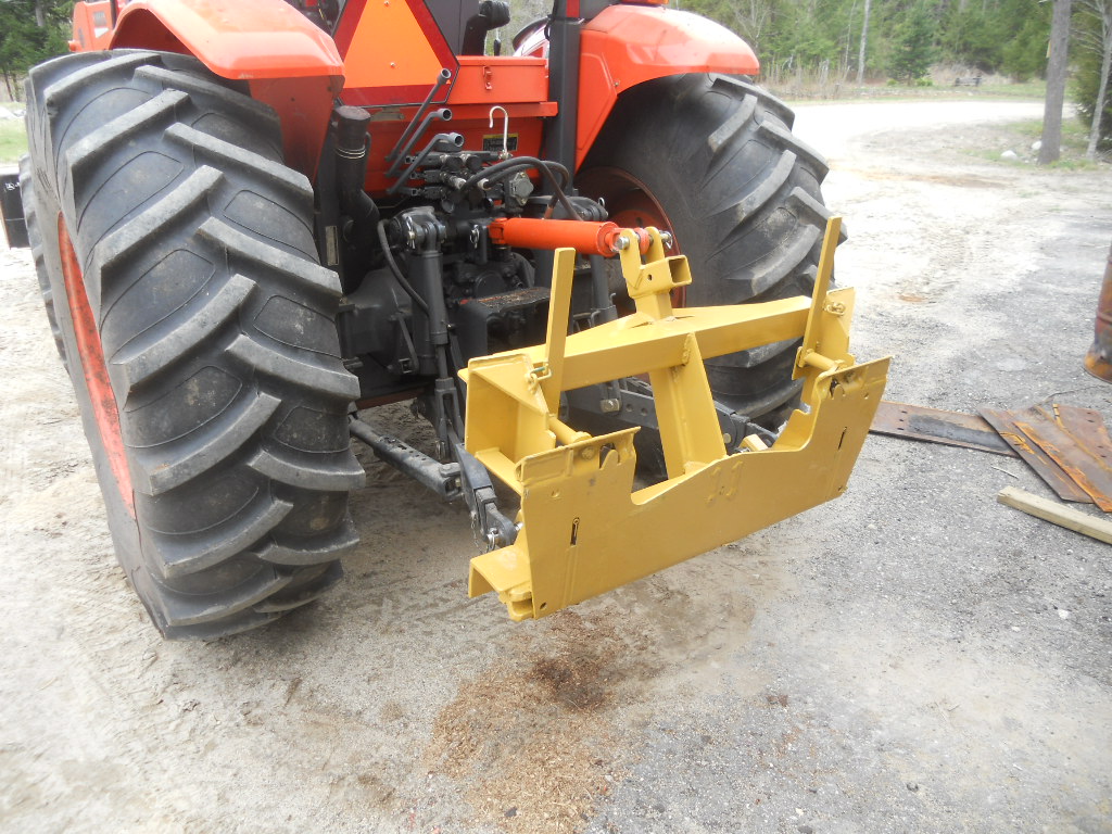

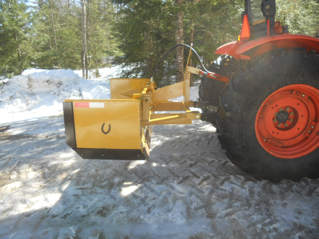

I needed a winter project so I built this snow pull/push box.
I did a post on build it yourself.http://www.tractorbynet.com/forums/build-yourself/390955-snow-pusher-box.html#post5012734
Here's what it looks like.
Just finished it up this morning.

A short video of changing it from push to pull would be great.. nice fab job.
Now I see how you change it.. went to the build link. Clever. Drop it and go around and pick it up from the other direction.
Seems a box could be fab'd to work off a quick hitch in a similar fashion too.
I had a (machine side) quick hitch sitting around and turned it into a 3pt. It was not "deep" enough in the pull position and I didn't want to cut it up for that, but yes, that would have been pretty simple although I'm relying on some of that sub frame I built to support the blade. The main body is only 1/4".

Your invention will make quick work of moving snow.. and likely won't have to touch the shovel. :thumbsup:
