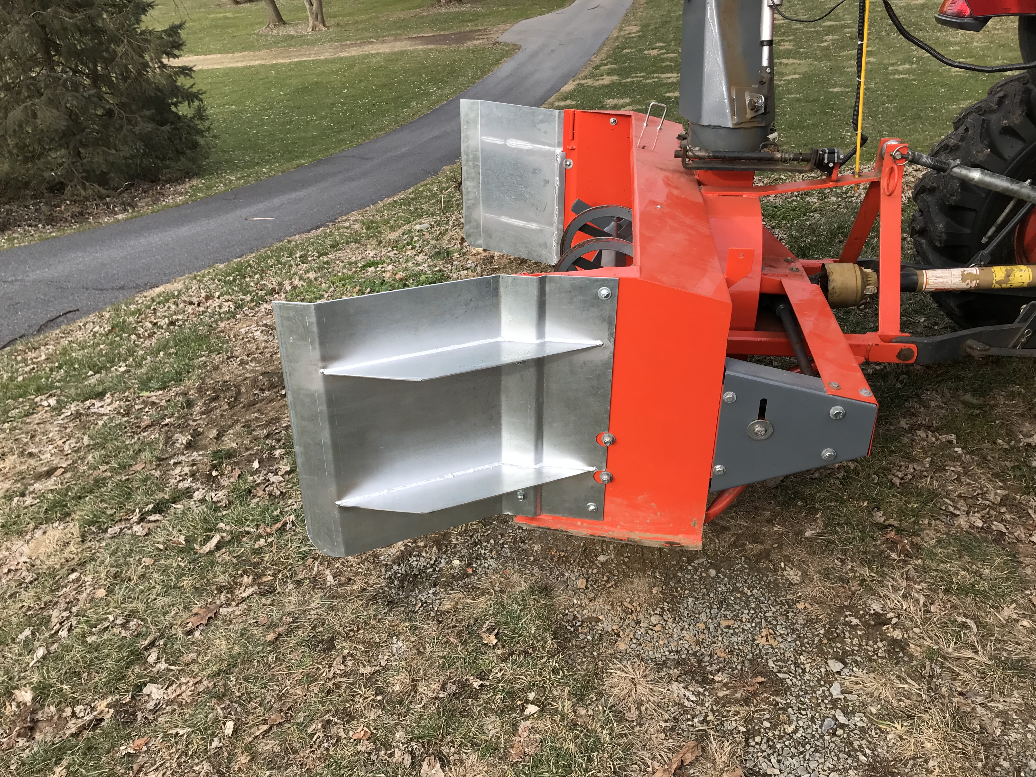

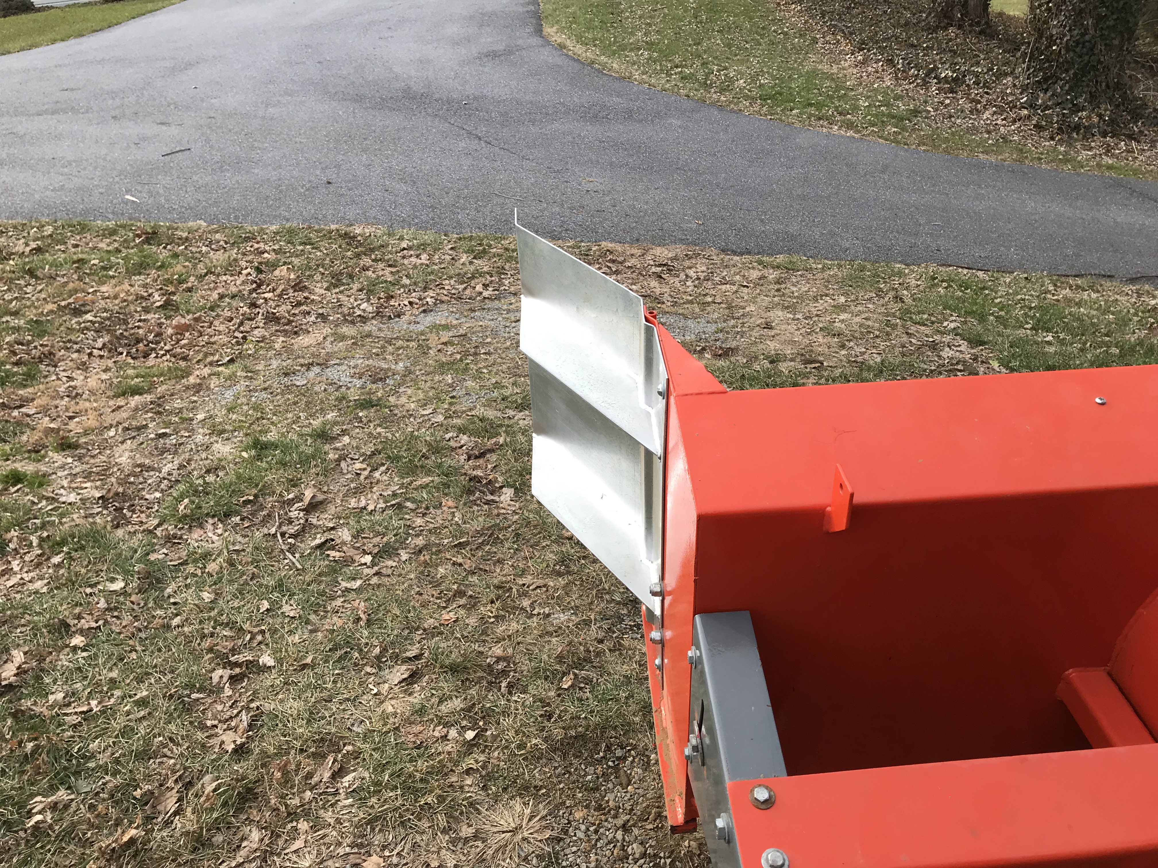

Bolted some extensions on the blower today. I'm not sure how they'll work. I'd assume the manufacturer has someone smarter than I am to calculate the fan size to the blower width. Maybe it'll just be a matter of going a little slower.
The original plan was to sell the blower with the L3200, but Wifey said why not keep it for the new (actually older) tractor? I explained the outside dimension of the tires on the L4240 was 76" as currently set and the blower is 66". So on Thursday morning I stopped at the shed and took some measurements and made a sketch. Since the fab shop at work is a little slow right now, they had some spare time to do the extensions. I fit the (10ga) extensions up today and all that needed done was to drill for bolts 4 places each side and trim around the bolts holding the end bearings of the auger. There are stacked strips that form a pocket on the inboard side of each extension that goes over the back edge of the blower body.
There's a front mounted power angle plow in the works for the L4240, so the blower will probably see limited use anyway. Since the plow isn't ready, the blower will stay on the smaller tractor for now.
