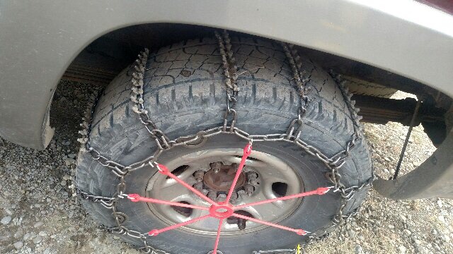

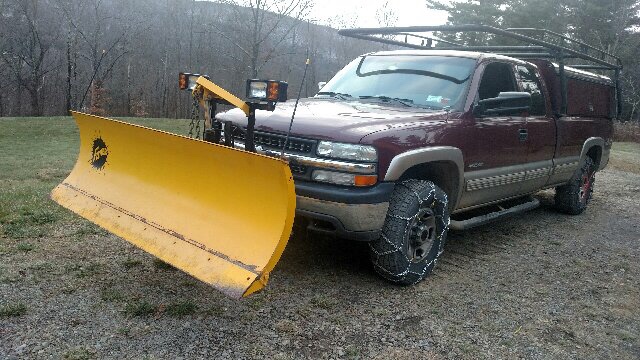

Just got myself set up. New to snow plowing. I have a 1300 ft gravel drive, of which 600 ft of it rises 120 ft. . Need some advice from experienced plow guys. I planned on driving down the middle of the drive from the top with the plow straight. Clearing the level area at the bottom and street side. Then driving back up the middle that was plowed and go back down on either side with the plow angled toward that ditch. Is this the correct way or am I missing something. I have to put some pics to honor the thread title so here they are.

Nice setup for plowing, with the chains all around she should do good.

As far as the worn tires chains are better then traction thread tires most any time.

Looks like you have some weight in the back, it is very helpful. I like having a trip-edge like yours instead of the whole blade tripping over. Also, with gravel make sure your shoes are set properly or you will be scooping up lots of gravel in the spring. And remember, you get stuck because you get hung up on snow. Don't get into snow deeper than your frame.

Hope to be helpful, but in your 3rd pic of the tire with chains, those chains do not fit the tire. The side chains should align like the 2nd pic. Trying to hold them on with bungee cord, I think you will walk right out of them in short order. But try it and see if it works for you.

Good thing you have 4 wheel chains since your tires are so worn.
Thanks for the advice.
Tires only have 8000 miles on them. Still have the nubs on the side of the tires.

Those chains are dead center on the tire. Totally different chains than on the rear. The chain that goes with the tire is supposed to be center of tread on a slight angle. If that makes sense.

Thanks for the advice. And yes, I put a load of firewood in the back. Gives me some weight and it can cure at the same time..

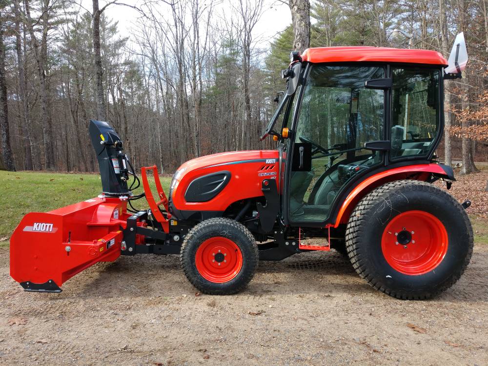

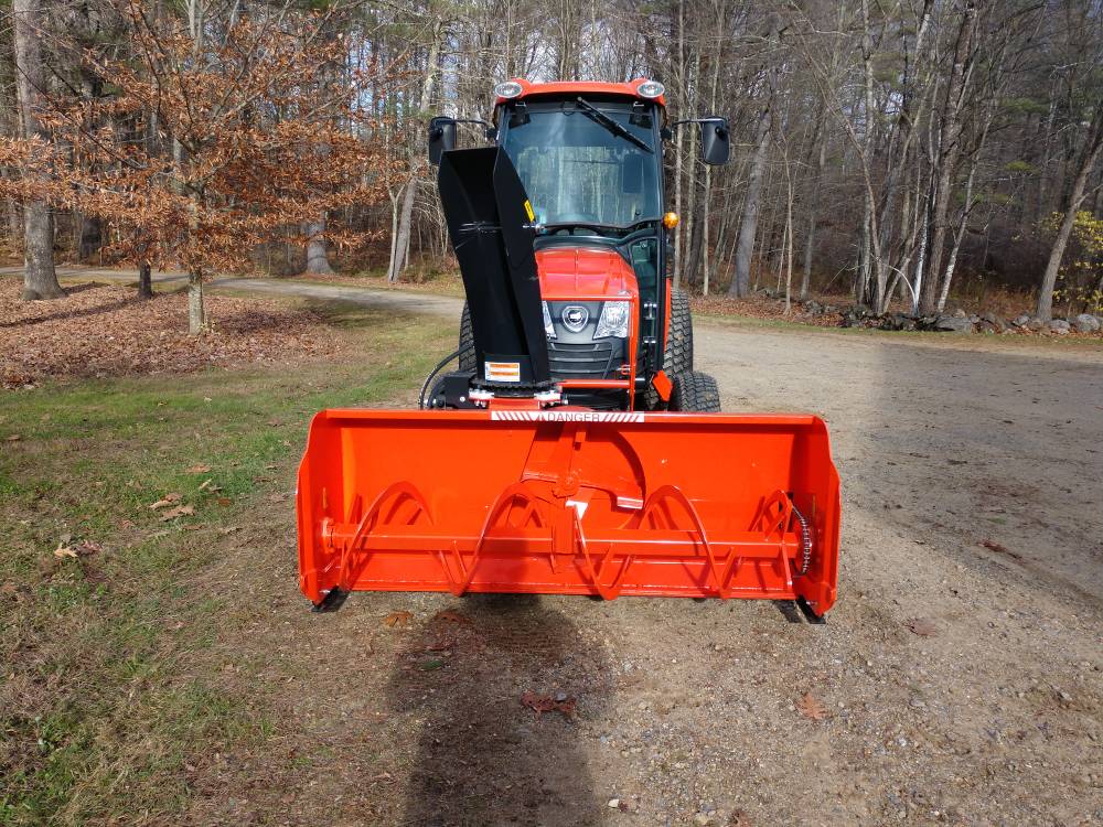

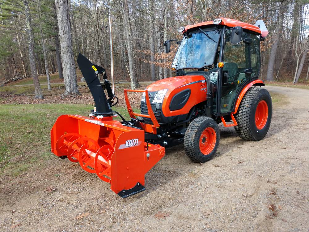

Kioti CK2610 & SB66 blower
Just waiting on the snow! IMG_20191103_133109392.jpegIMG_20191103_133138778.jpegIMG_20191103_133119389.jpeg

dpgoalie, beautiful setup you have. Everything looks brand new. How much clearing do you have to do?
