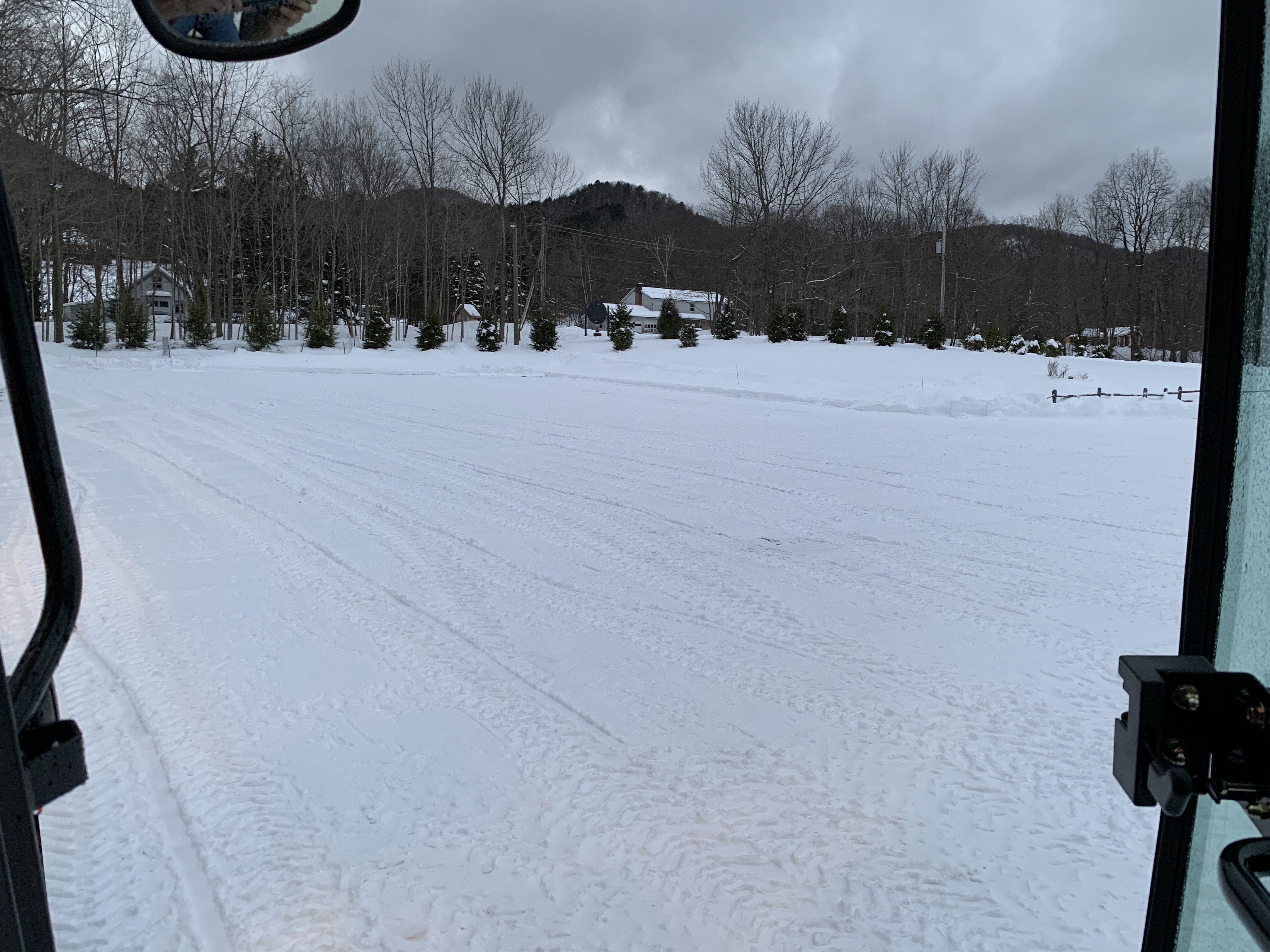

Cleaned things up nice. We got about 18-20 inches and I had to leave it for a few days because I didn't have time to get everything with work. Was heavy today after some warmer weather, but the blower and tractor pushed it right out. Does take a while, but I like the results much better than with aplow. Waiting on my pushbox for the front, hopefully be here next week.

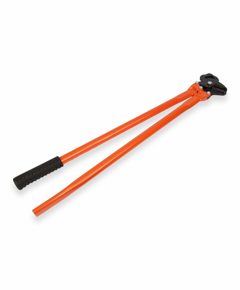

They also sell any acessory/part/crosslinks you could ever need for alterations or repairs. Last year I sprung for a new "tire chain" tool, what a life saver for that job.

Tell us more about the tool, with a pic and how it is used. tks

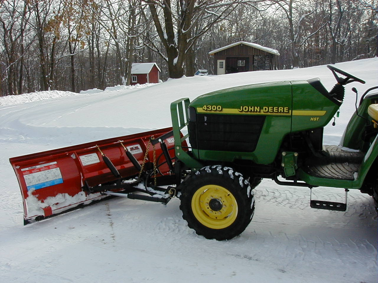

   / Pictures of your snow weapons #5,207
7' Western is very well balanced in 'float' on my JD 4300.
It's mostly a tool that opens/spreads your end links that attach the cross links to the long side chain. Helpful when replacing or adding cross chains (links). It also closes them, in other words what you would do with a hammer & chisel, a miserable job. in the pic below, the closing side is to the bottom rt. of the "head". the opener is the other towards the top end. Any cutting is still done with bolt cutters or a cut off wheel in a small grinder.

Thanks Rusty.
Managed to borrow that tool when I made my rear wheel chains for my 4300. Very handy tool for doing what you describe.
