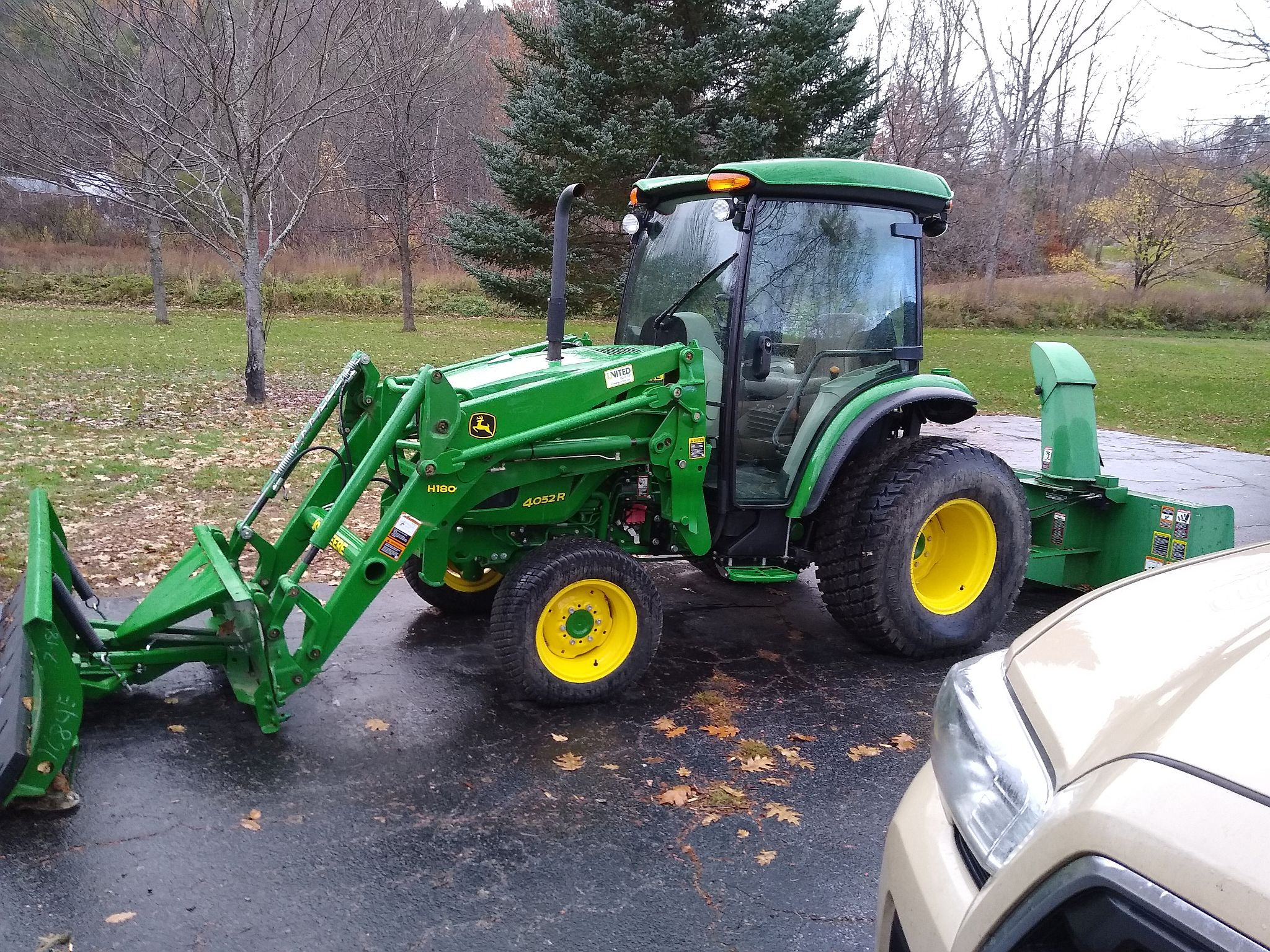

I have a Frontier and it's a great blower. You will need at least one rear remote if you want a hydraulic chute rotator (pretty much a necessity with a cab tractor)...two rear remotes or a diverter if you also want a hydraulic deflector (these are both available as electric options too, but I have no experience with them). I only have the hydraulic chute rotator right now.
I can't say any about the Woodmaxx snow blowers, but I do have a Woodmaxx chipper...great implement and I expect the snow blowers will be just as great. Plenty of videos on YouTube about Woodmaxx equipment.
Meteor...no personnel experience but look of YouTube for Good Will Tractors for a great video demoing a Meteor pull type snow blower...
Heck, I'll save you the trouble
Here's my set up

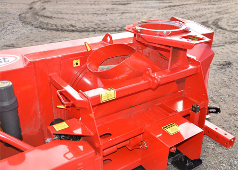

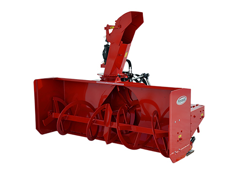

With your annual snow falls you should look at the Pronovost P720, and the P720TRC; It has a rotating impeller housing that lets the operator discharge the snow directly to the left or right bypassing the chute and spout which eliminates plugging with heavy wet snows.
The picture on the left shows the P720 with the partial chute covering that reduces the amount of snow spray if you are cleaning powder snows.
The picture on the right shows the left discharge side of the TRC model. The shoulder of the right discharge hole is not shown.

Thank You. I have never in my life plugged a chute while blowing snow. We have the rotating impeller housings on the big blowers at the airport. I do not think the added cost and complexity is worth it to me.
