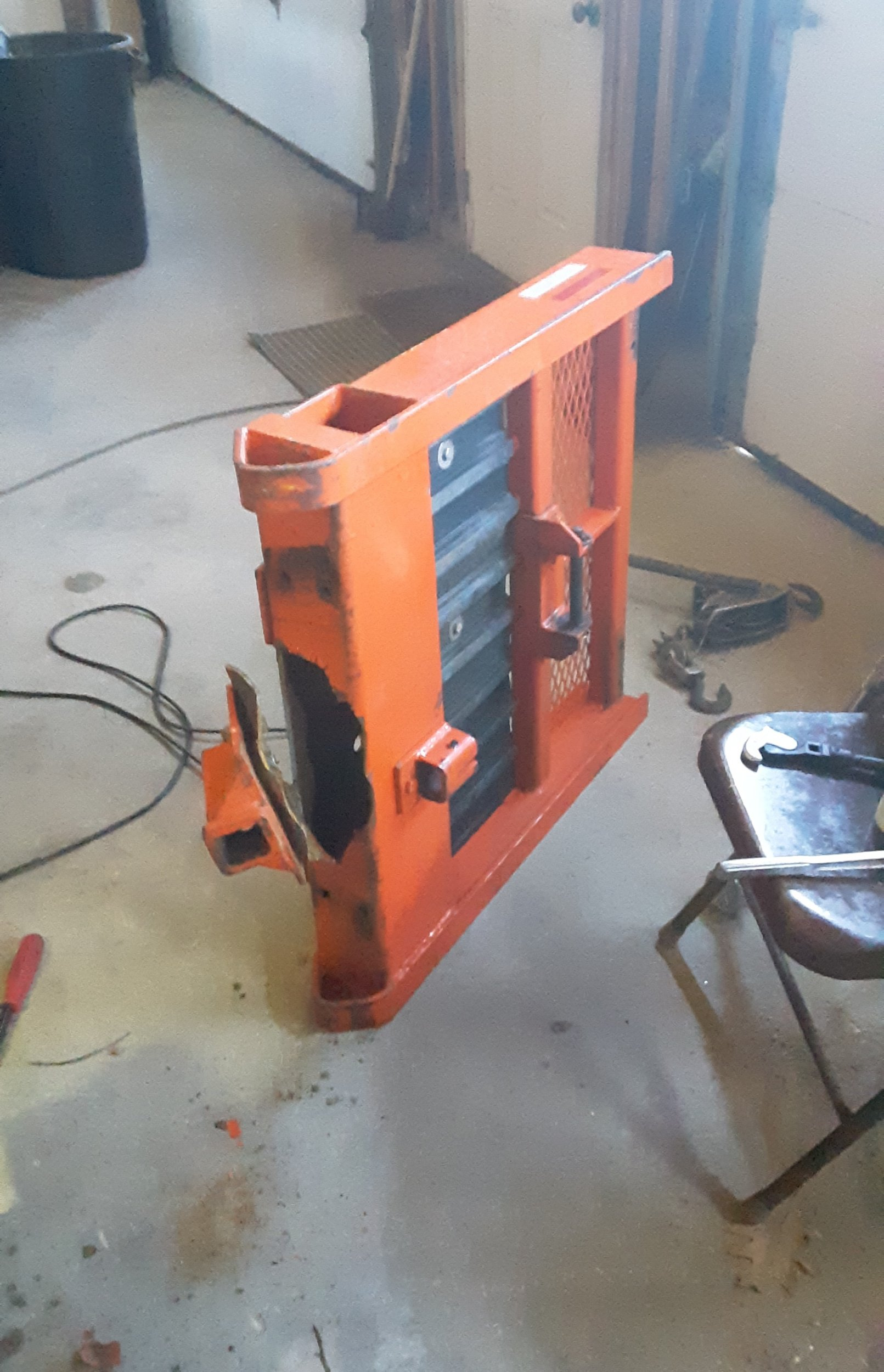

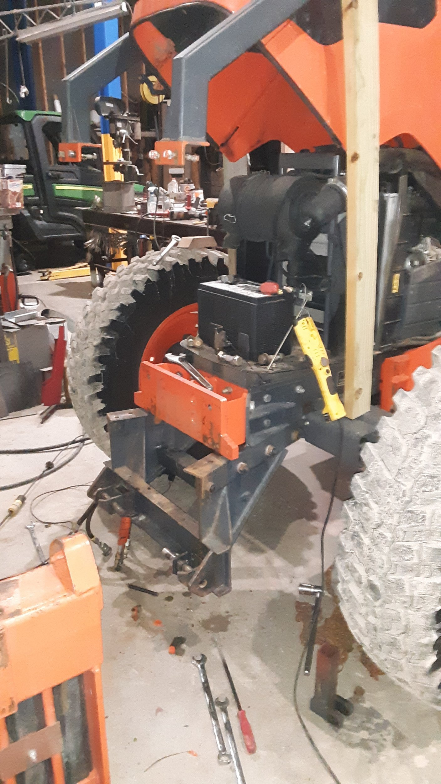

This past Saturday's storm was when I had some pretty severe metal fatigue show up.

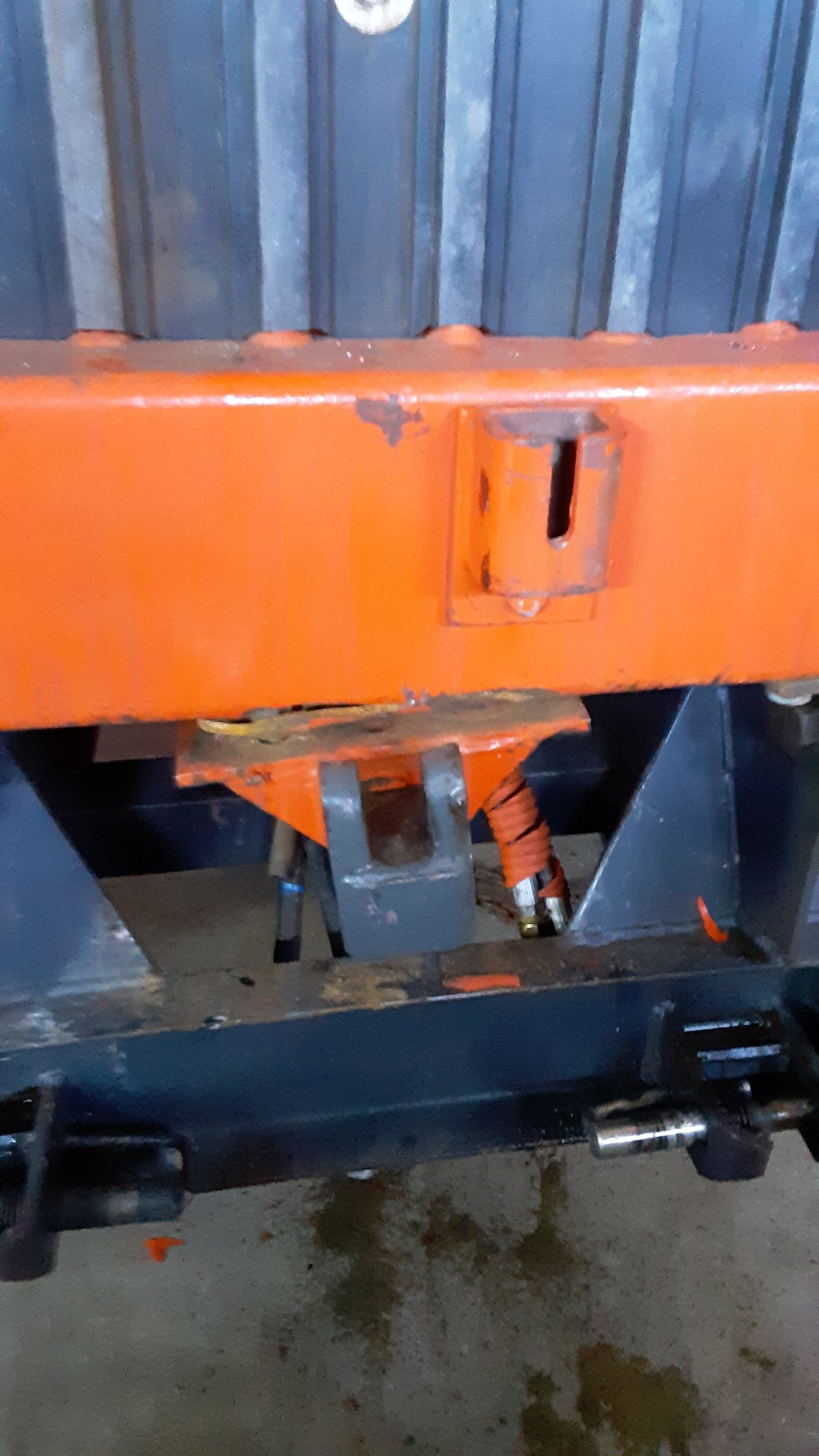

This is my grill guard - bumper the I use the reciever hitch to mount the lower end of the plow lift cylinder.

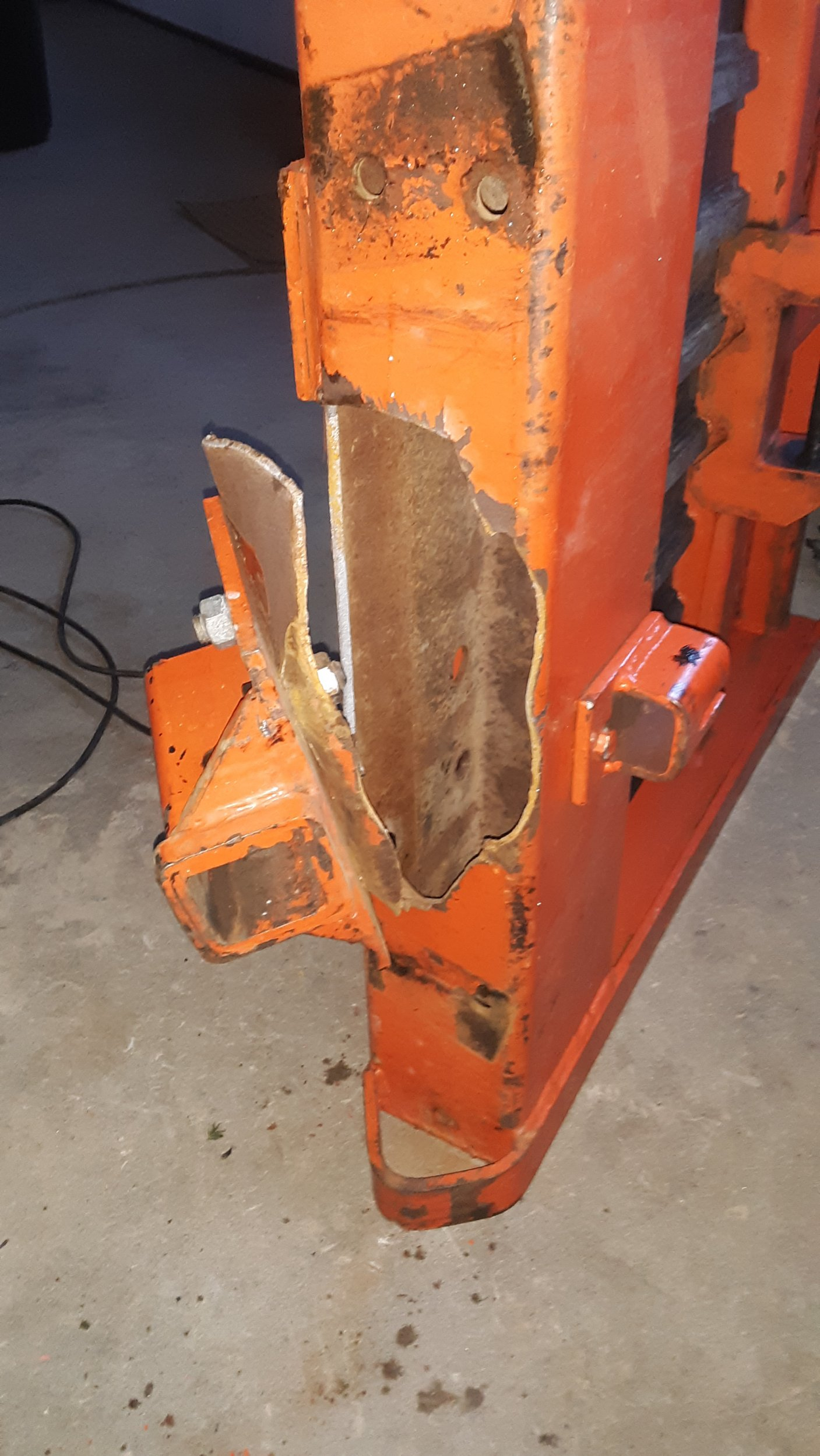

That's a 5x7x1/4" tube that everything up front is built on. The reciever was welded to a 3/8" plate with 4 3/4" bolts holding it to the tube. All my welding held up but after 8 years or so with the heavy 9'6" v blade bouncing up and down while traveling the roads, this is result looking at the bottom.

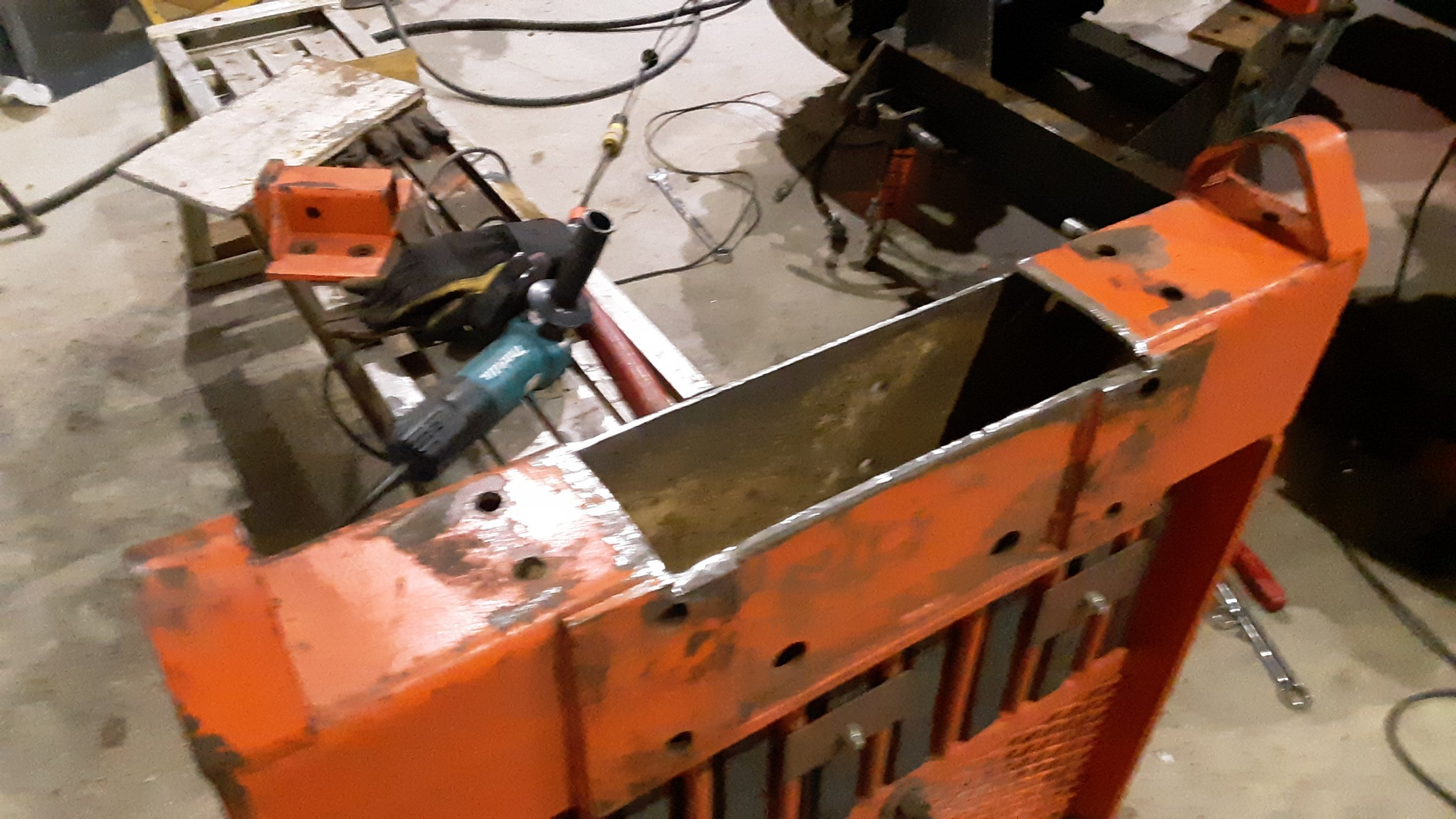

I'm cutting out and welding back in a piece of 1/2" plate, this time with a little bit of additional gussets.
To understand what the pictures are, this was the day before in working condition.
This is where I left off this afternoon.
It took a couple of hours just to get it off of the tractor.

It all looks so rugged who would have thought the lift cylinder mount would let go - until you think about a 9-6 V-plow bouncing along. Looks like it started a while back. Get it fixed before the snow gods see it apart.

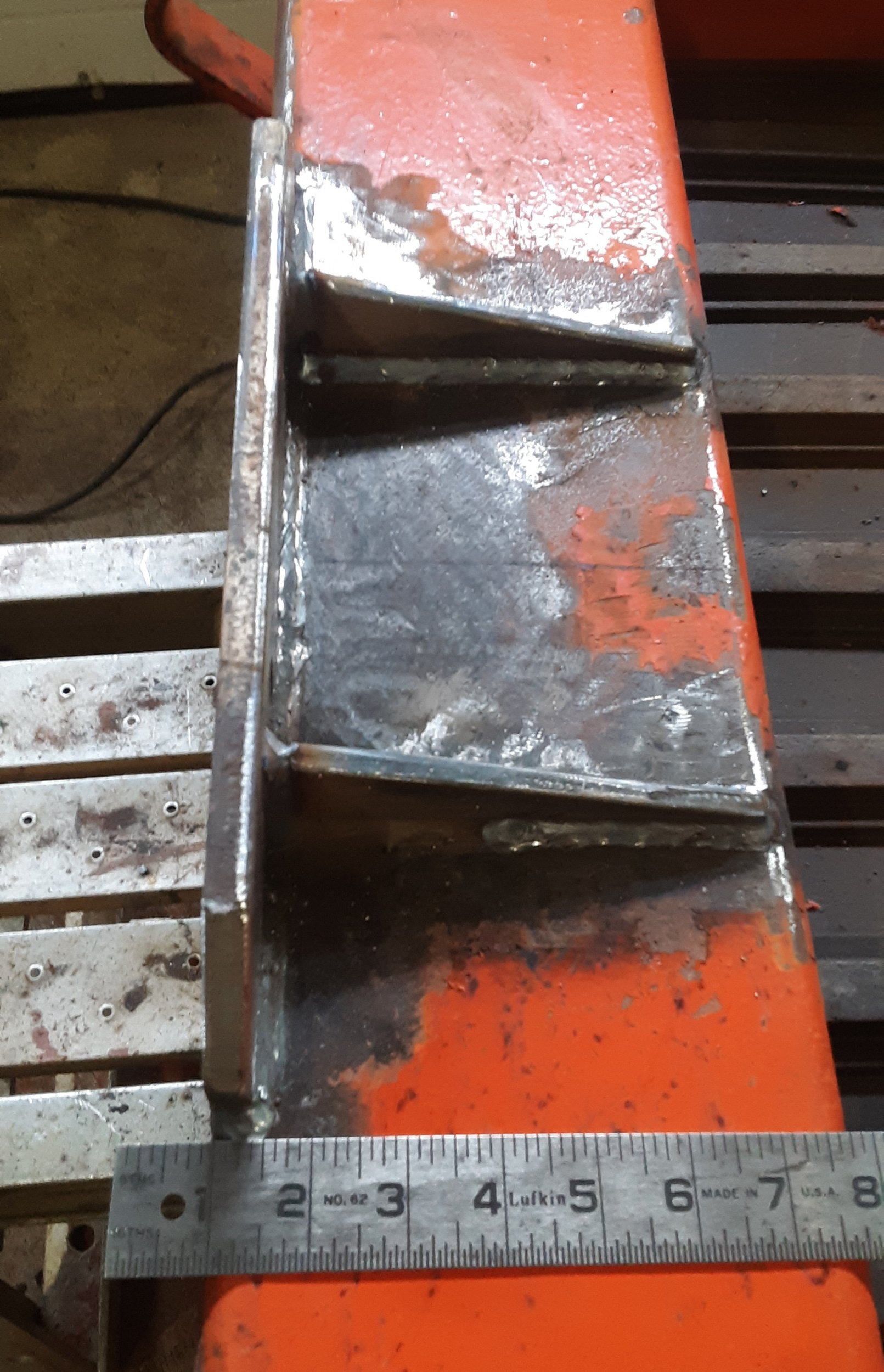

I think I got it. Replaced the 1/4" wall of the tube with 1/2" and a couple of gussets.
I find it amazing how the 1/4" almost "ruptured" before the 4 bolts that held the receiver on failed.
You're right Gordon, there's a little rust on the front edge, not really old looking but not bright like the back side.

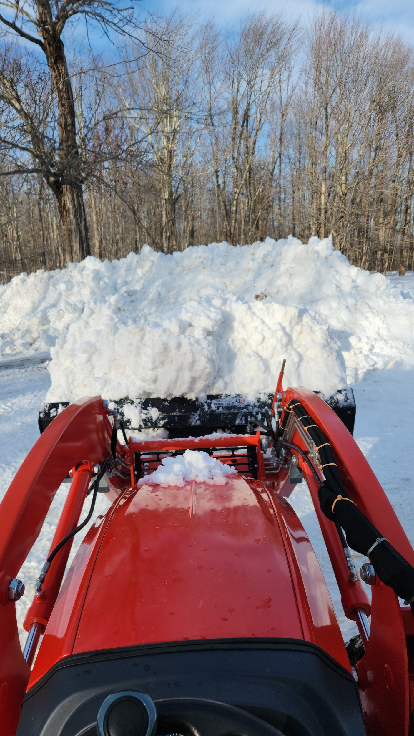

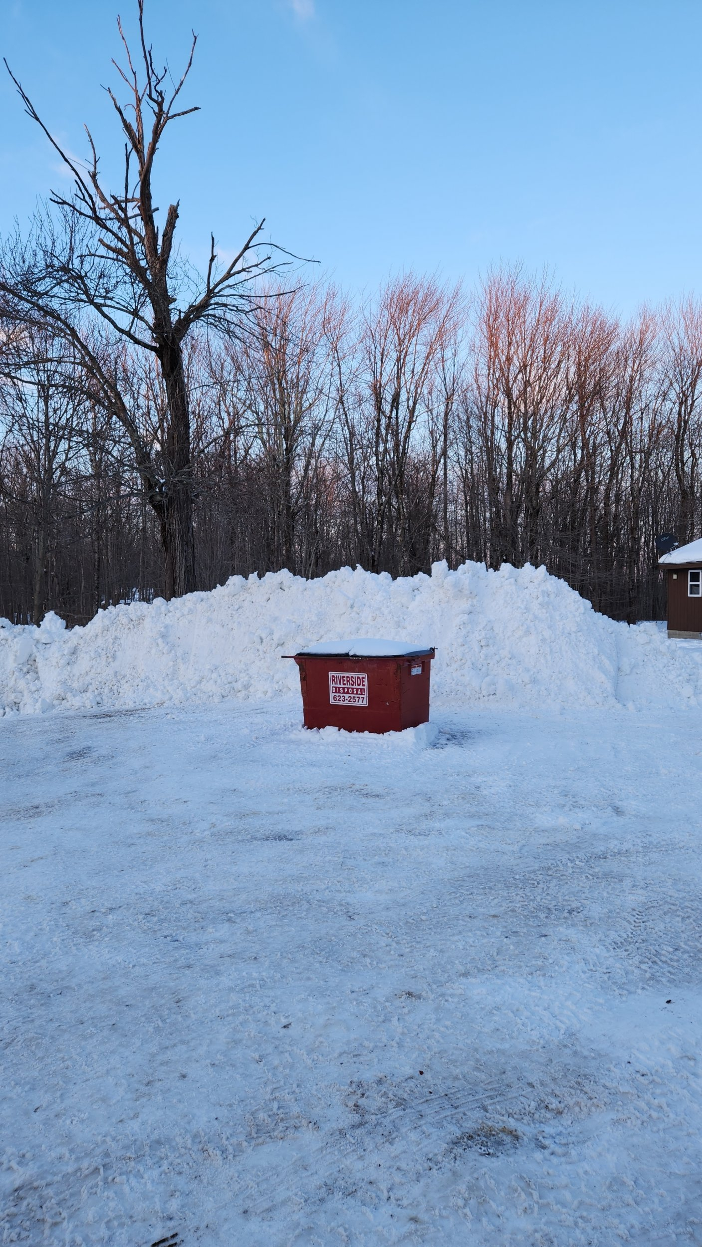

Yesterday I pushed last weeks snow out of my little log landing. On the way out there I tidied up the road edges and broke an access hole thru the snow bank into where I am cutting. I mounted the camera on the front of the ROPS just for fun.
