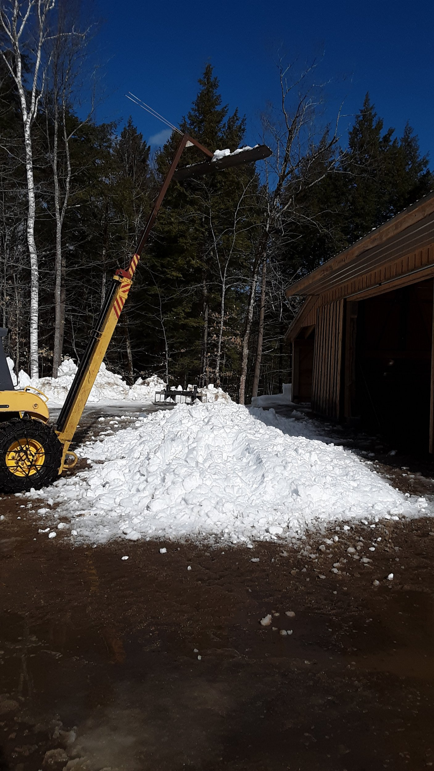

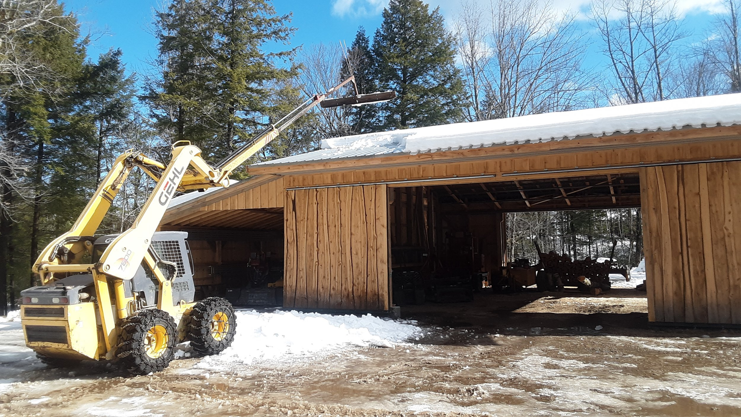

I built this one for lifting. The working end is basically a big 4" reciever for various arrangements for different lifting situations. This "roof rake" was a natural for this, it's just a simple metal frame and the "cutting edge" is a pressure treated 2x10 bolted to the heavy angle and can pivot a few degrees to compensate for differences between the roof and the ground that the machine is on. It telescopes 9'.
The weather conditions this year just wouldn't let it slide off the metal roof and it would just drip when above freezing.... right where I process my firewood !
These pictures were early February, the whole season's snowfall to that point, we've had about 20" (2 storms) since then and they've both slid off on their own. 👍

That is a sweet idea and attatchment spent a few days last week shoveling off my folks roof.

I haven't had to use it for probably 10 years (all metal roofs) but I had forgotten how fun or satisfying it is to have all that snow come thundering down right in front of you. 👍

I forgot to ask - What are those two feelers sticking up from your neat rake Eric ?
