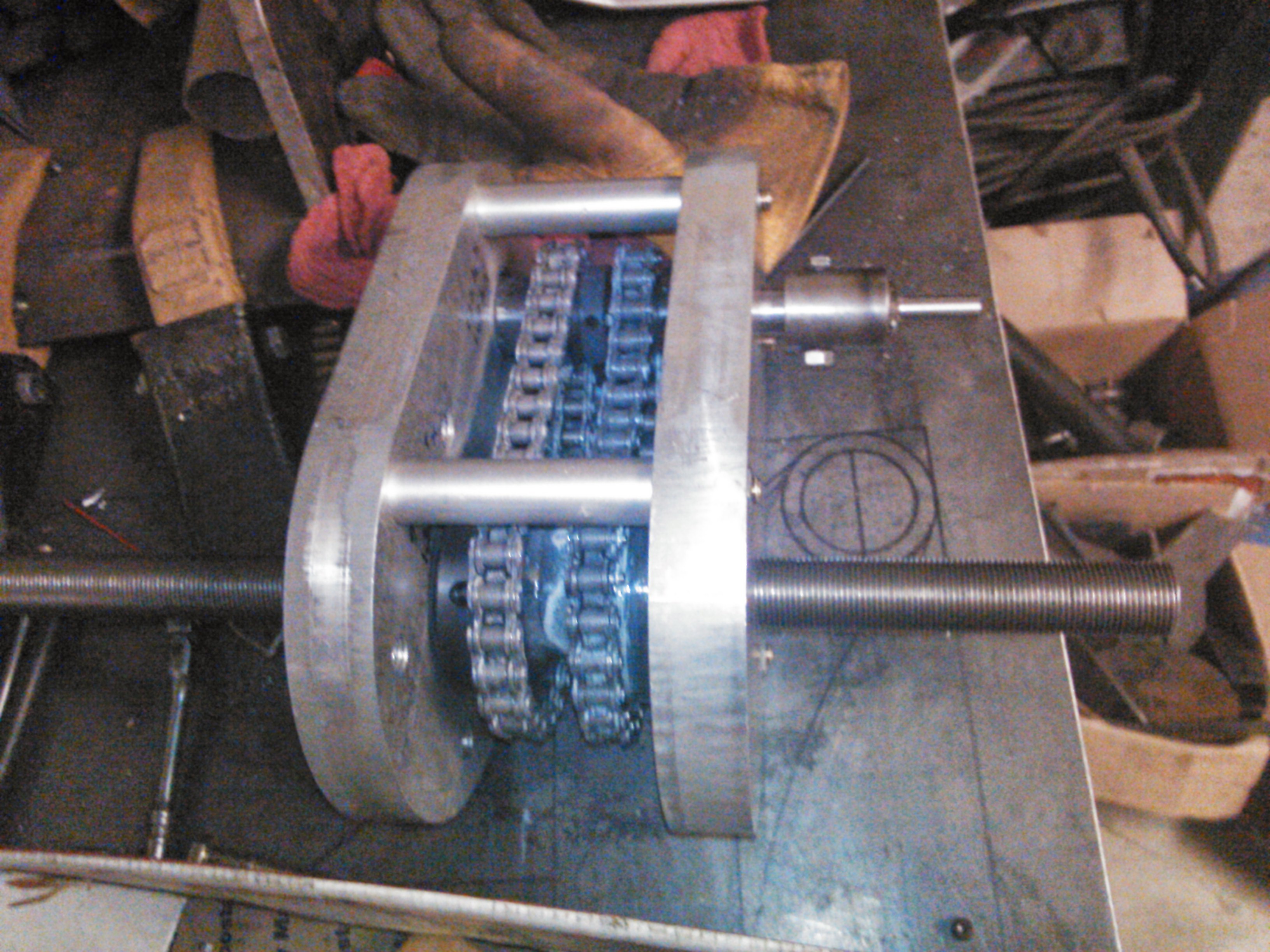

I made a line boring setup a couple years ago, pretty simple and works well.
I used spring bushings when I made my backhoe, pins were made out of 1144 stressproof.
Mcmastercarr has a decent selection of spring bushings.
My drive system, fixed at between .005-6in per rev.
