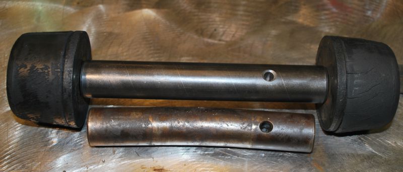

Got the first pin made from the 1144 ... was somewhat taken aback by how easy it cut and machined. Behaves like it's soft, but it isn't. Compared to the 1045 I can just feel it trying to grab the surface of the 1045 .. so it is a bit harder. And in the reverse the 1045 just skitters off the surface of the 1144. The 1144 cut way faster than the original OEM pin .... I'm hoping that's just an example of Woods not wanting to pay the extra money for "easy to machine" alloys. The original pin didn't appear to substantially harder than the 1144 though.
This is the pin that connects the boom ram to the main housing. Obviously the old one is bent badly, a couple of years ago it broke the ears off the main housing and in the process bent the pin, it had been repaired once before poorly. This time I rebuilt the whole area, bent the ears into alignment, welded on additional 1/4" plates to reinforce the area. Poor design from the get go, the main housing should be 1/2" plate, not 3/8". New pin is 1/2" longer to compensate for the additional 1/4" plates.
New pin slides in nicely. Going to make a couple of the bucket pins next ... they are about $90 each .... cause they have a washer welded to them. The plain pins are cheap from Woods, but any pin with any machine work on it is like 3 times more expensive.
