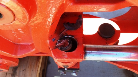

Attached are pictures of the washer freshly ground off along with a side-by-side of a new pin versus the one removed. Best guess is that the assembly has not seen a bit of grease since it was manufactured. Strangely, the other side is greased and is good as new.
I am one dang bolt away from removing the swingframe from the boom. Heat and cussing failed to convince it to yield so the just delivered slide hammer is about to be put to the test. This was after constructing a Rube Goldberg frame to prevent the boom/dipperstick/bucket assembly from falling over and creating a cart that would hold the mainframe and stabilizers so that they could be wheeled out of the way when disconnected. It is an interesting education. Turns out that I have a welder/machinist a couple of hills from here and once that final bolt is coerced out I will be delivering the swingframe and DOM tubing to him. Hopefully, the end is near.

The pictures tell the story. Glad you're making headway.
   / Pin Hole Too Big #69
Was the washer ONLY welded to the pin? If so, I still maintain it is purley cosmetic.
If the washer were welded to the swing frame, or both, then I could see it as a temp solution to lessen slop.
But from the looks of it and where it wore, there looks to be little wear around the center of the pin where the cylinder hooks. And this is the only place that should need it. The pin is bolted in place and shouldnt rotate in the swing frame. So there shouldnt be much wear there? Other than the pounding it takes. Certainly an odd occurance

The washer was welded only to the pin. Had I been smart enough to put a mirror to the bottom of the pin, I would have noticed that the bottom bracket was hanging by a thread to the pin and a tap with a chisel would have negated the need to grind. There was minimal wear on the pin where it mates with the cylinder hook, but while I have it all apart I intend to replace that bushing also. Does anyone know if that should simply knock out or do I need a hydraulic press to remove and replace?
