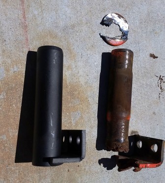

Thx for the new pix. This is a real puzzle. How one side would be ok and the other side such a mess. And as LD1 says, what happened to make the pin start chewing up the swing frame, while the part of the pin in the cylinder rod end stayed more or less ok.
   / Pin Hole Too Big #73
I would say that the cylinder end was hard fasted to the pin. No rotation put all the force above andbelow that area, which had no grease so it wore out the hole in the swing arm which is softer than the pin.
   / Pin Hole Too Big #74
Yep. My guess would be that the grease zerk on the cylinder stopped taking grease and whoever did the service didn't notice, or didn't care until the pin fell out. Then they probbaly welded it back together a couple of times and eventually put the washer on top.

The way the pin is retained, it HAS to rotate withing the cylinder clevis. It CANNOT rotate within the swing post unless the bracket breaks.
Which is quite possibly what happened. THEN it would be allowed to spin in the swing post. Which wasn't bushed with hard material, because as designed...it isn't needed
It was broke in the picture
Yep. But could have have broke during removal.
In either case, once fixed and kept freely spinning with lube in the cylinder eye, the swing frame shouldn't wear at all
   / Pin Hole Too Big #80
Looking at the welds on the bottom of the worn pin, I would guess that it was re-welded several times.
