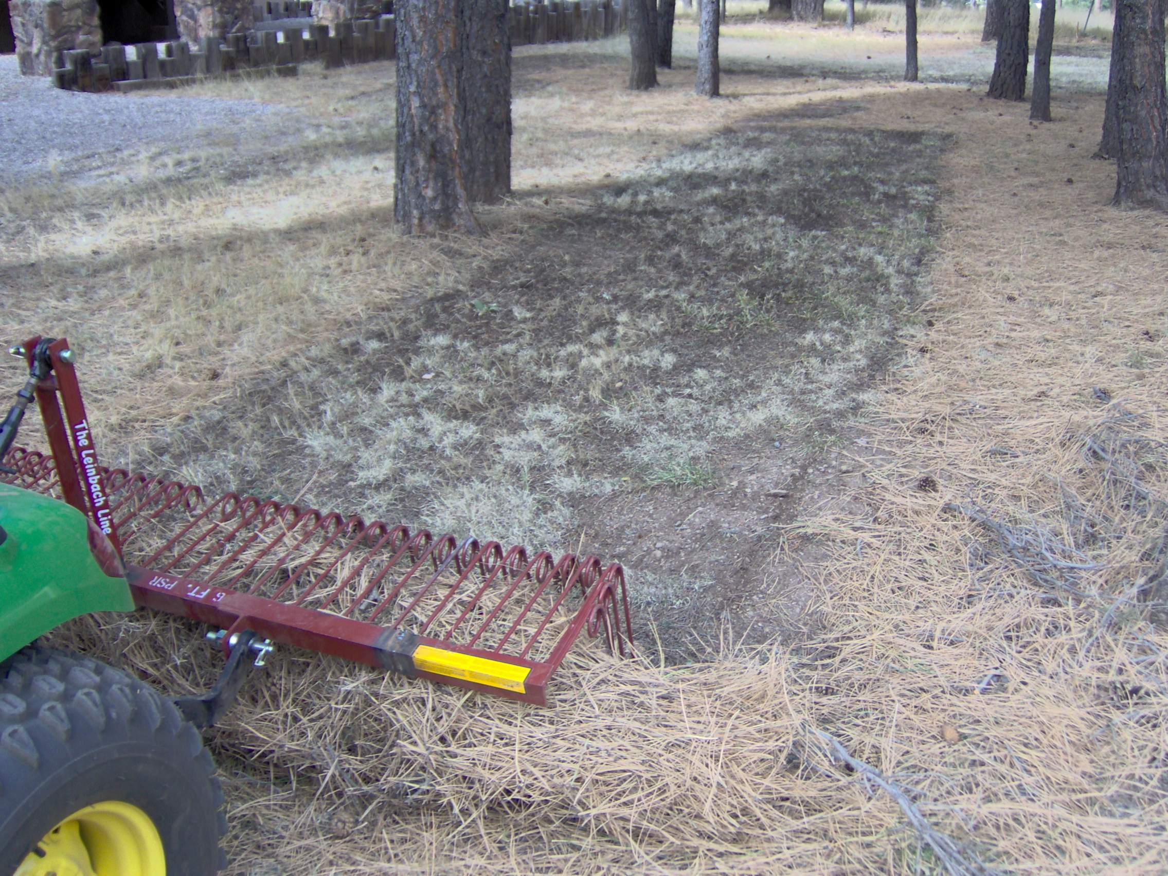

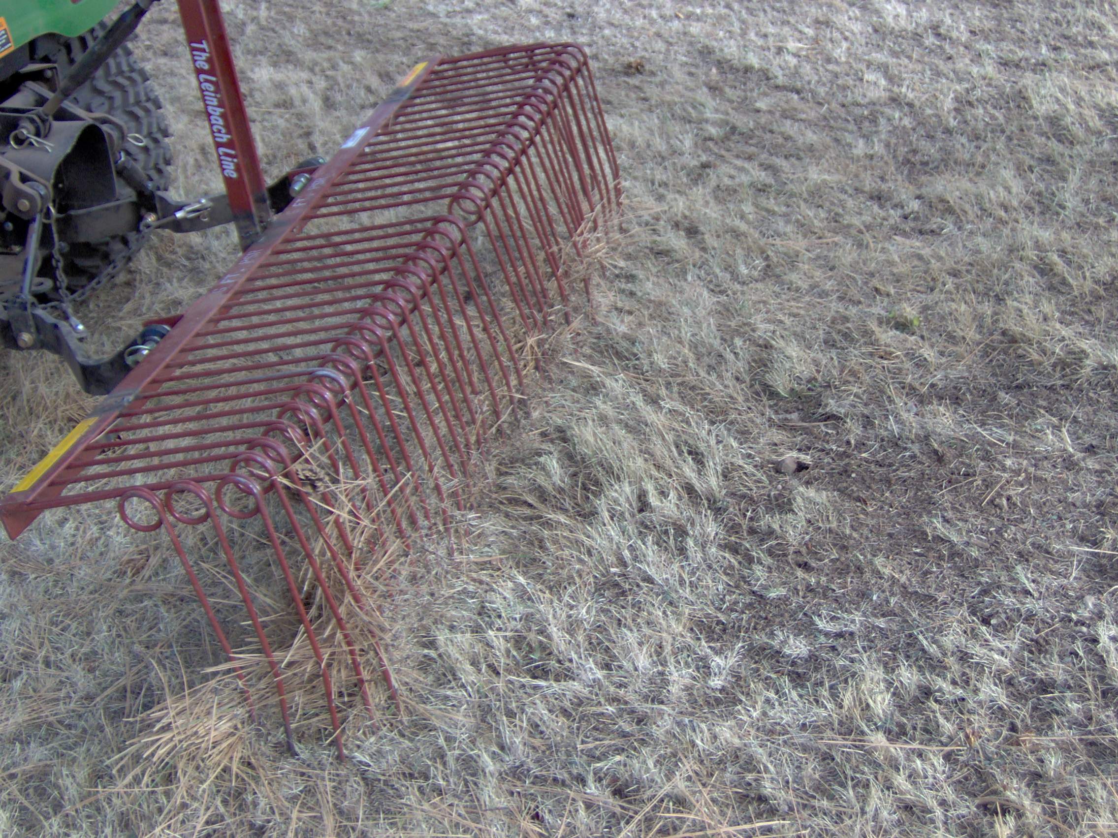

Here's a couple of pictures of my pinestraw rake. This is a good tool to have for several things such as smoothing over seeds and finish smoothing. I bought this Leinbach from ETA before they made their own, it works well but I would recommend the new rake with easily replaceable tines.

I wonder why Leinbach/EverythingAttachments wind their coil tines backwards. There must be reason for it but I was always told that torsion springs are better used with the force trying to wind rather than unwind the coil. I has to do with the preload induced in the coil when winding providing more strength against further bending.
Thanks, jenkinsph, for posting the great application shots.

I think flexing is more important and the goal here my rake is about three years old now and the tines are close to being all straight without any of them out of alignment, They do need to flex easily enough to ride over obstacles such as stumps and large rocks, and so far no problems with that.
About dethatching, I would say it gives fair results but is not as agressive as a purpose built dethatcher. Still I just ran the rake around my lawn a couple of passes and will vacuum up all the loose stuff in the morning before fertilizing. Time to purty up the lawn.:D
