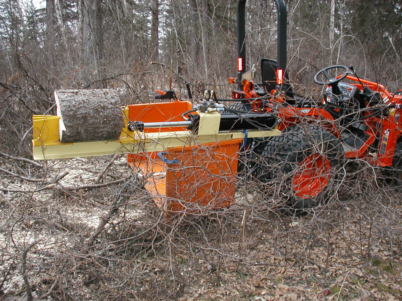

I built this one for under $300 but managed to scavenge the steel so was only out of pocket for the hydraulics. I unplug the bucket roll hoses from hte FEL and plug the splitter into them. Note the bungee cord holding the FEL joystick. The block on the splitter is about 18" dia. The splitter has never refused a split so has enough power for me.

brandoro, I like that setup. Cheap and effective. Even thow you're using the tractors hyd. system don't you still need a hyd. res. ? What about the box it's mounted on, does it serve as a carrier also?
/ Pint sized log splitter #6
Since it is using the tractor hydraulics the trans. hydraulic fluid of the tractor is the reservoir. Running the splitter barely keeps the fluid warm so no problem there The box the splitter is on is my three point carrier, the splitter is just clamped to it in the picture, that was the trial run. I liked the splitter on there so am making a proper mount for it. I block and split enough wood to fill the carrier then drive back to the shop to unload the wood then drive back out in the bush to block and split some more. Don't play myself out that way. I am thinking I will strengthen and extend the carrier rearward a bit so it will hold more wood, cut down on the travel time a little.
It has a 4" X24" cylinder and is limited to 2000psi, I think that works out to about 12 ton of force.
I looked at one another guy had made with a 2.5" cylinder, too fast and not enough power IMO.
