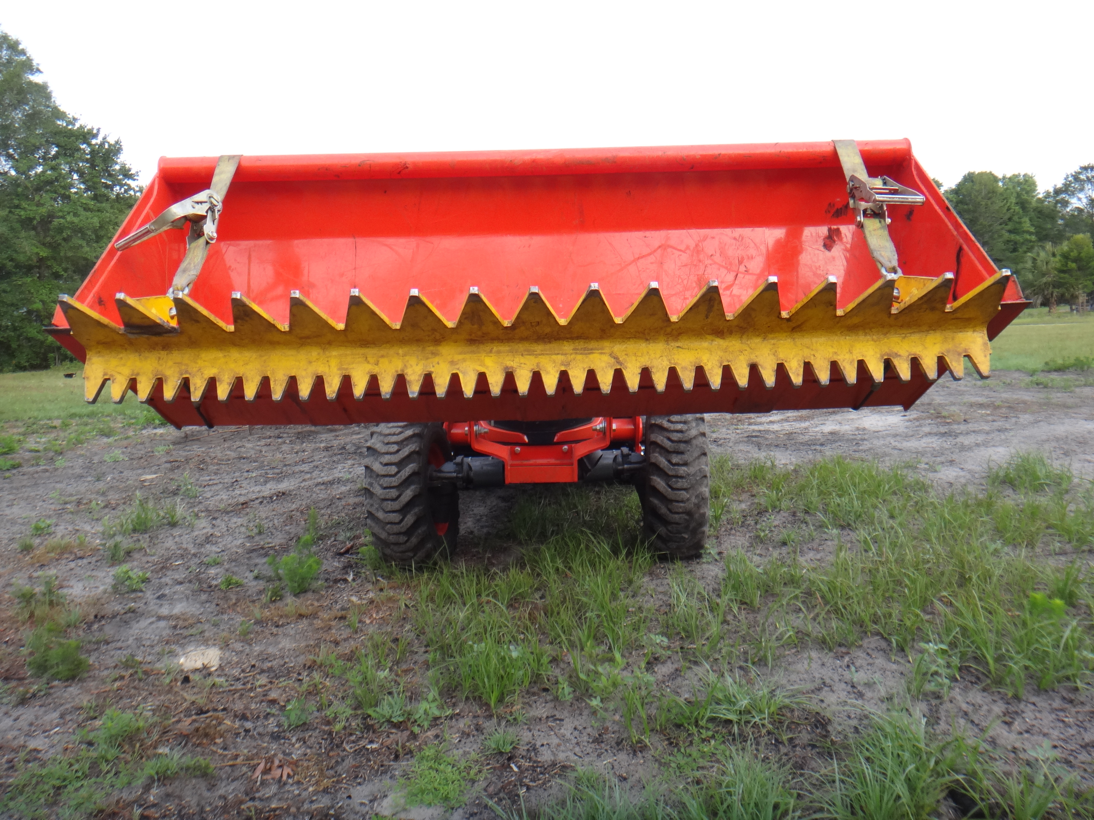

piranha tooth bar. It stays on the bucket, more versatile without needing to keep reattaching it. The landscape rake is better or easier for collecting or dragging rubbish and your ruts but a box blades is what you're going to get anyway
   / Piranha Toothbar or Ratchet Rake???? #6

My Piranha tooth bar lives on my FEL bucket; I've never taken it off once I installed it.
