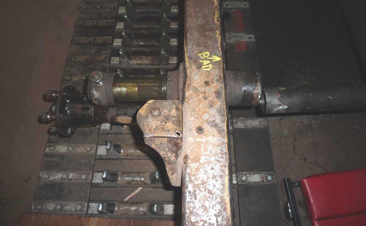

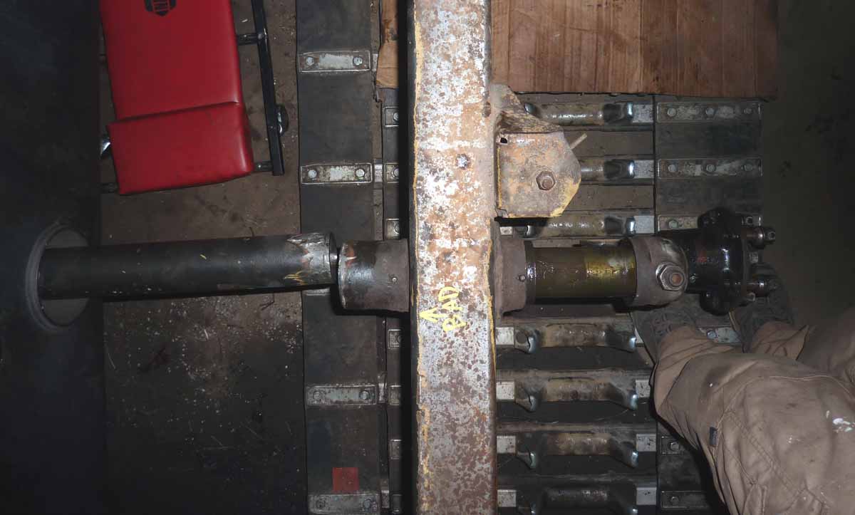

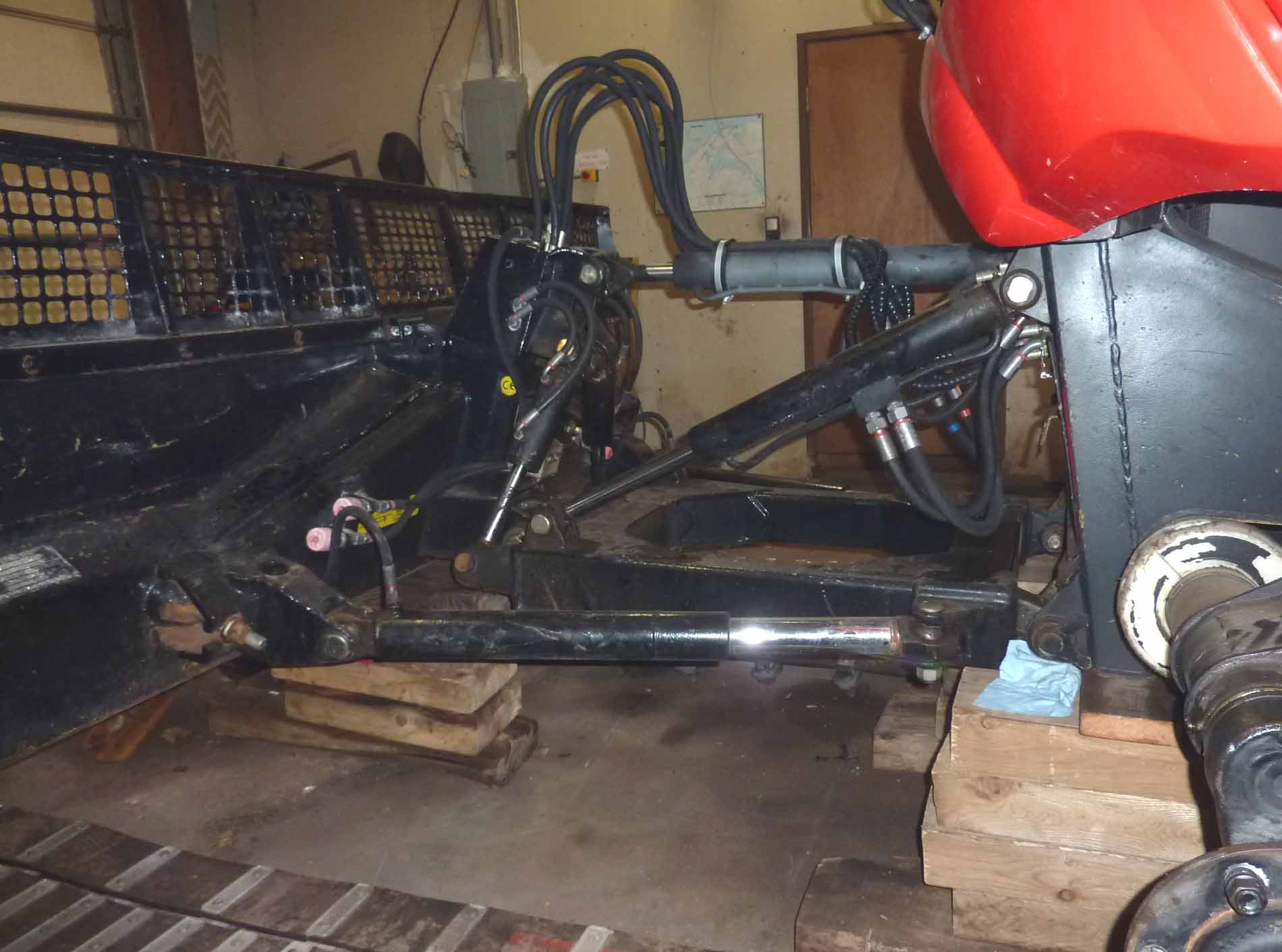

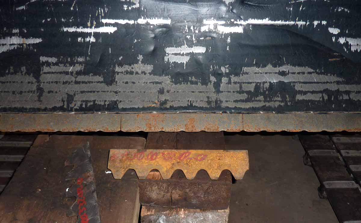

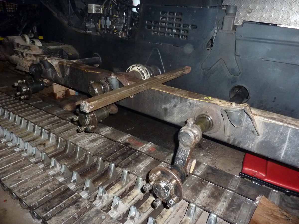

More service photos taken today. First ones are repairing of the cracked torsion bar anchor tubes. Then what the all-way blade setup looks like.. Last ones are the next welding job to replace the worn blade cutting edges.. Do they need it?? :confused2:
