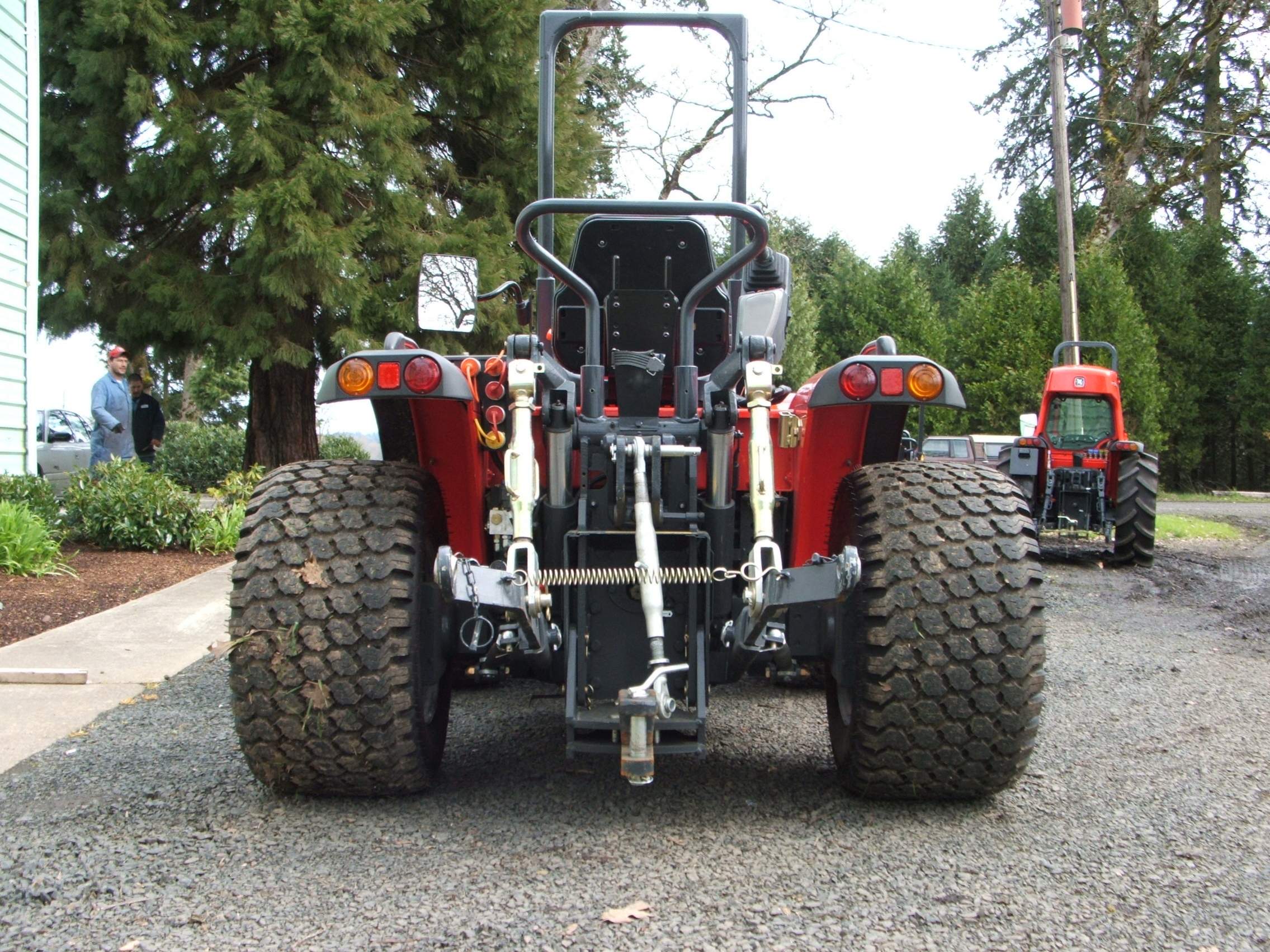

After a year of reading this site, I finally pulled the trigger on a Powertrac 1850 for my 40 acres of slopes. If this tractor had not come along (used because 20K was my budget) I would have purchased a TYM 330 and had Dualies put on it. It had a liberal warranty program and the price was right.
This all said, if you can, go rent a tractor for the weekend. That little exposure that you get will tell you SOOO much. Ask if they will set the tractor up wide, and if they have one with loaded tires.
The Powertracs are the best of the slope oriented tractors (other than Carraro's) in my opinion. I only base that on the fact they do a lot of regular tractoring. Problem with Powertrac is three major issues. They are sold and serviced only at the plant, They are unreliable in the beginning, and they do not hold resale that well at this point. My rebutal to all of this is that they are super simple to work on. They are designed with owner repair in mind. Most parts are over the counter and most issues are related to hoses. Second part is that once you work out the bugs of your particular machine they seem to last a long, long time with little care.. And because of this website, I think they are starting to build their reputation as a useful and reliable machine. I know that the used ones that have come on the market have been snatched up immediately and at better prices than I would have thought...
But, if you don't like turning a wrench, and there is no local skid steer or hydraulic mechanic, don't go down this road.
