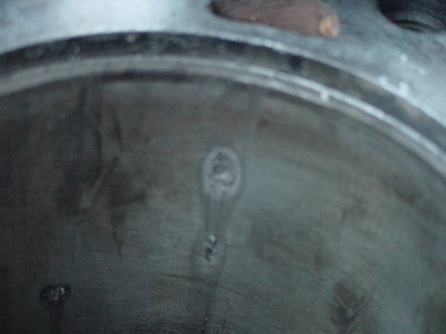

Hey Guys,
Got the sleeves out via welding. Burnt through sleeve a littl. Will hone out. Is this ok???
Machinist said check rod bearings for copper color. Sure enough.
He said this could indicate crank journal excessive wear. What do you think?
A little bit discouraged today. Sleeves out, hope the pits in cylinder will not be a problem after honing. Sure wasn't planning on pulling crank.
Opinions please.
Thanks,
Jim

Here is a picture of where I burnt through the sleeve. It looks worse in this picture. I only did it on the first sleeve. On the remaining two I tacked a pipe cap into the sleeve and they drove right out.
Regarding the crank journals any suggestions on what to look for. The machinist said to mike for specs. I thought I was on a role until the sleeve mishap and now the possibilty of having a crank with worn journals.
I can upload pics of the rod bearings with minimal copper coloring if it would help.

I am sure your overhaul or rebuild will work out just fine. In fact, anyone doing their own work will almost certainly be happy with the result if they are careful. The chances of a poor job is almost impossible if you follow the instructions in a manual and use the manufacturers recommendations. I wouldn't worry too much about the burn, but ensure it has no high spots before reassembly and would recommend using a high temp sleeve retainer like Permatex or an equiv. This is a space age plastic that seals between sleeves and the block. You can read more at:
http://www.devcon.com/techinfo/HI TEMP SLEEVE RETAINER.pdf
If you have removed your sleeves, you will need to replace them. I am not sure what you mean by honing out. You don't want to hone the block after removing the sleeves, but will want to lightly hone the new cylinders to ensure for a good ring seal if they are not honed already. When replacing your sleeves, watch your surface rise on the sleeves. Your engine may call for it and may not. It has a lot to do with sealing the head gasket. Search the internet for examples of a good, 'light' crosshatch before honing. Don't hone too much. You want enough to seat the rings, but this is a lightly honed surface, barely able to be felt with your fingertips. I find the ball hones work well, but don't over do it. I have seen some pretty enthusiastic honing, where the person would have been better off leaving the original cylinder in place. An original .008 taper isn't impossible to work with, but I have seen people hone .010 off a new wall by not understanding the idea of breaking the glaze on a cylinder. I would make sure the head is in good shape before replacement. If you had excessive ridge, the chance you need new guides is pretty high and at that point, clean up the valve margins. Don't lap your valves, either reface them or take them to a shop to do it for you. You can easily see if there is excessive wear on the crank journals by using a micrometer to measure them. At the very least, check the new bearing clearance with plastigauge.

Jim, No reason to be discouraged. This may turn out to be one of those projects where your initial thinking is that you want to go a yard but since you are there you might as well go another step and since you are already this far then another and another--We have all been there. I have done it more than once on an engine rebuild too. Initial thinking rings and then a complete rebuild at the end.
However, a little "copper color" does not necessarily mean it is necessary to turn crank. You should mic the rod journals to find the smallest size and the largest. The difference will tell you your out-of-round (the largest and smallest will be 90 degrees apart). Yanmar has a spec for that too. if it is within tolerances then new bearings and go. If it is outside the specs then turning and oversize bearings are necessary. The top rod bearing and the bottom main will be worn.
Do not hone the bore for the cylinder liner! Just carefully remove any high spots, maybe with a dremel tool. I do not know how thick the walls are, but the cooling jacket is behind that wall and you do not want to put a hole there or your block will be junk. I do not recommend honing because you want a tight fit and do not want to enlarge the hole at all. The dry sleeves rely on the tight fit for the heat transfer and you do not want any relative movement of the liner to block.
Take heart and just push ahead!!
