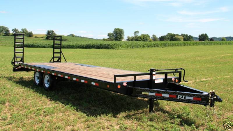

Hi All,
I am still looking for a trailer to haul my JD2520 with loader and rotary cutter, cars, building materials, etc. on. The tow vehicle is a 2004 F350, V10, 4WD, automatic, longbed, extended cab, with camper and snowplow packages and a 4.30:1 rear end.
Now for the question. I am looking at a new, bumper pull, PJ 8 inch I-beam flatdeck trailer with 22 feet of flat deck and 3 foot dove tail, 96 inches wide with 7000# axles and brakes on all wheels (see picture). Here is my delimma - from what I have read on the web, this thing probably weighs around 4000# empty. According to the information in the brochure on the PJ web site, there is 11.5 feet of flatbed (plus the 3 foot dove tail) aft of the centerline of the wheels and 13.5 feet (plus the tongue, say about 5 feet) ahead of the centerline.
If my calculations are correct, this makes the tongue weight of the empty trailer at least 1000#, which seems like an astronomical amount for an empty trailer. Does this sound right, and if so, does this sound like it will work with this truck?
I have no doubt that the truck is capable of pulling the weight, but the tongue weight issue concerns me.
Should I be looking for a lighter trailer or at least one with different wheel placement?

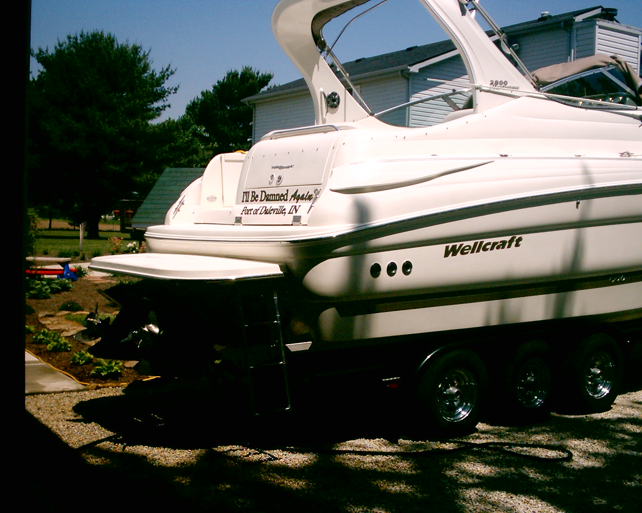

Just for the record I have a 2006 F-350 SRW with the Powerstroke and its a 4x4 short bed super cab. It has the highest SRW GVWR available of 11,500# and it handles this boat fine with 1,800# of tongue weight and a total weight of the boat of 15,600#.
I had a 2005 Dmax 3500 SRW 4x4 bong Bed crew cab that had a GVWR of 9,900# and it would not handle it nearly as well as the Ford and my 2004 F-250 4x4 SRW short bed Powerstroke with 10,000# GVWR would not handle it very well either but did slightly better than the Dmax.

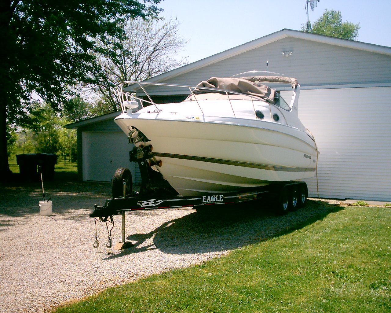

/ PJ Deckover Trailer Questions
Diamondpilot,
How much does that 1800 lbs make the rear of your F350 sag? I assume you're not using a weight distributing hitch with the boat trailer. Does it cause you any steering problems, etc.?
I suppose I could go to a WD hitch, but it seems like overkill for the type of towed loads I'll be having.
The biggest thing I've towed with this truck so far is my 24 foot cuddy cabin, and I had to move the trailer bogies as far back as possible to get even 300lbs of tongue weight out of that.
I wish there were a few more choices of trailers around here, but deckover bumper pulls seem to be a rare commodity.
/ PJ Deckover Trailer Questions #7
Diamondpilot,
The F-350 only drops maybe 3" and feels rock solid. I have towed upt0 25,000# with this truck 30 miles @55 mph and it did ok. But again it has all the packages like Snow Plow Prep, ect to give it the highest GVWR of 11,500# I had to order it that way. For example my 99 F-350 only had 9,900# GVWR.
My F-250 with 10,000# GVWR and my old Dmax 3500 that boat would drop a good 6-8" and was not comfortable to drive. The steering really suffered.

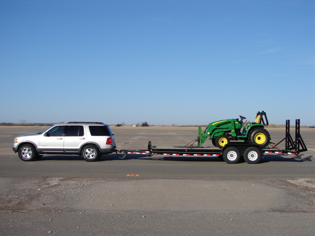

My two cents: Too heavy of trailer for your needs. I have a JD3320 and use a 24' PJ 6" frame trailer to move it around when needed. I went with a LONG trailer so I would have plenty of room to move the load around, which helps adjust tounge weight. The empty trailer is approximately 3,400 pounds.
In the attached photo: the 22' version of my trailer and my old tow vehicle.

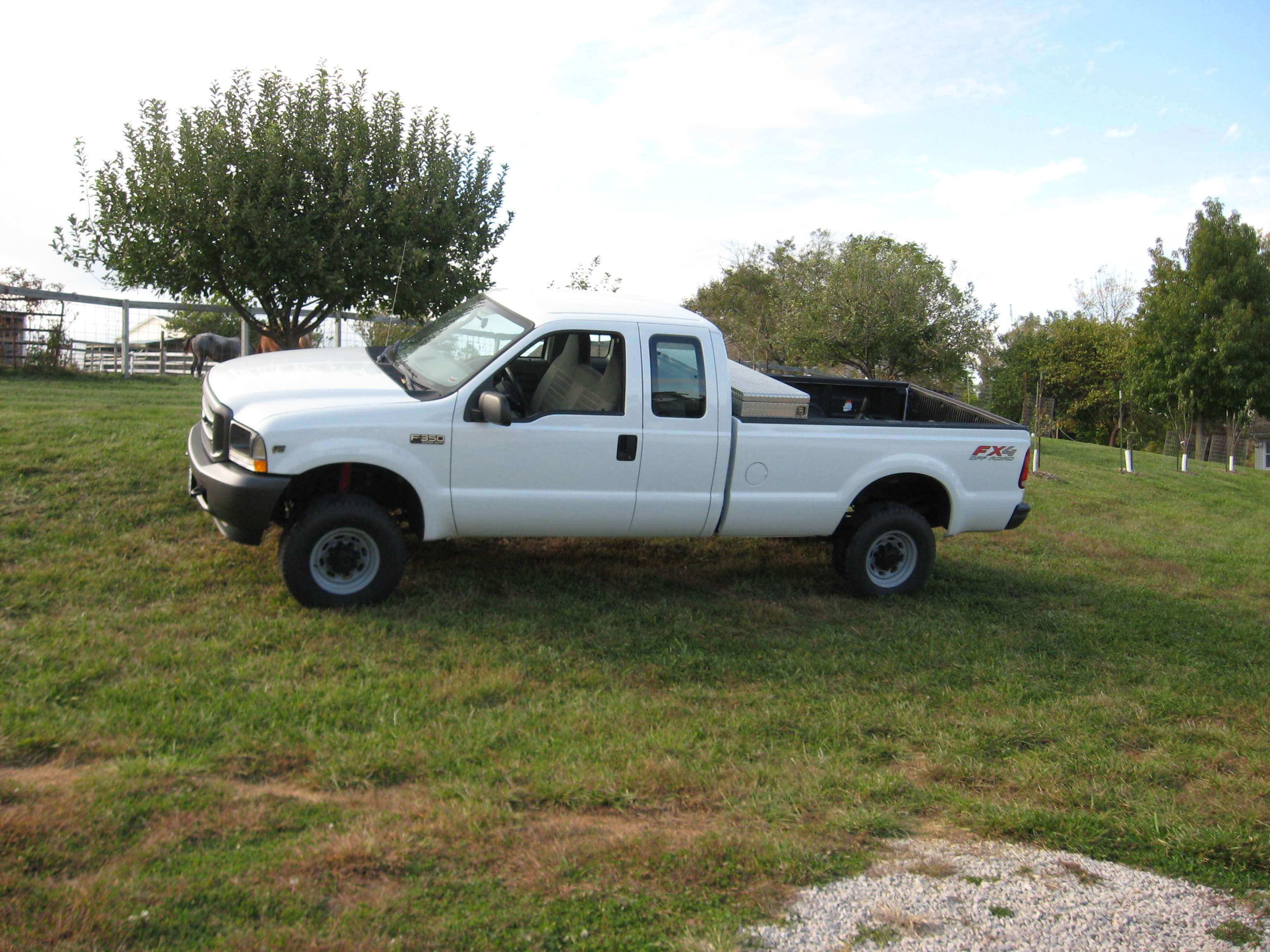

I guess that's another way to go; just bite the bullet get a gooseneck hitch and be done with it. Kind of didn't want to modify the truck but maybe that's the best way.
One concern is that this truck sits a little high for a gooseneck.
I had your same issue when I bought my trailer last year. I looked at the PJ, both in the bumper pull and gooseneck. I decided that the bumper pull was just too much trailer to hitch to a standard hitch without weight distribution, so I bought the gooseneck version. As far as modifying the truck, I don't see that as an issue. B % W makes a great bolt on model, and the only alteration is a hole in the bed, but it is filled with the removable ball and causes no issues. When I traded my '97 F 250, they could not care less that it had a hole and hitch, if anything, it made it more valuable. Luckily, my 06 F350 had the hitch already installed.
So if you truly need a 14,000 lb. trailer in a flat top, I would go with the gooseneck. It is superior if you really load it to the max. The height of the truck should not be a problem. Yeah, you lose your bed, but with several thousand lbs. on the bumper, what could you carry anyway?
