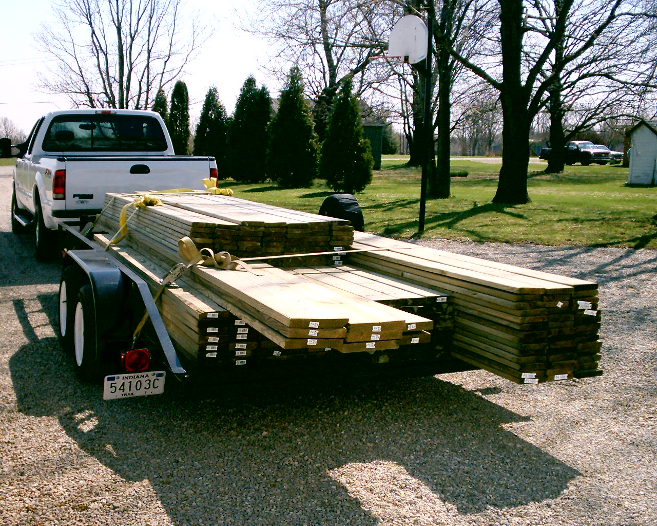

No open center. I guess its not a car hauler but a landscape trailer. Most landscape trailers are only 76" wide but this one is 82" wide and most are only 16' long and this one is 18'. I ordered it new in 2004. It has 2 3.5K axles and I had it weighed the day I picked it up. It was just a tad over 1,200# I have since added a winch, and electric brakes to bring the weight to just about 1,250#.
I have hauled my 5,200# tractor on it tons of times. It last job was rescuing a Chevy 1500 with a bad fuel pump. It has also been to Chicago to get a Hyundai, take a Suburban to Terre Haute, went to Detroit to pick up a Lincoln Aviator, and pulled about 20 cars around locally including both my uncles and fathers Corvettes. I would guess it has well over 3,000 miles pulling cars and another 3,000 miles hauling boats, furniture, tractors, ect.
Here it is behind my wifes 2004 F-250 4x4 Powerstroke. You can see how wide it is.
Chris
