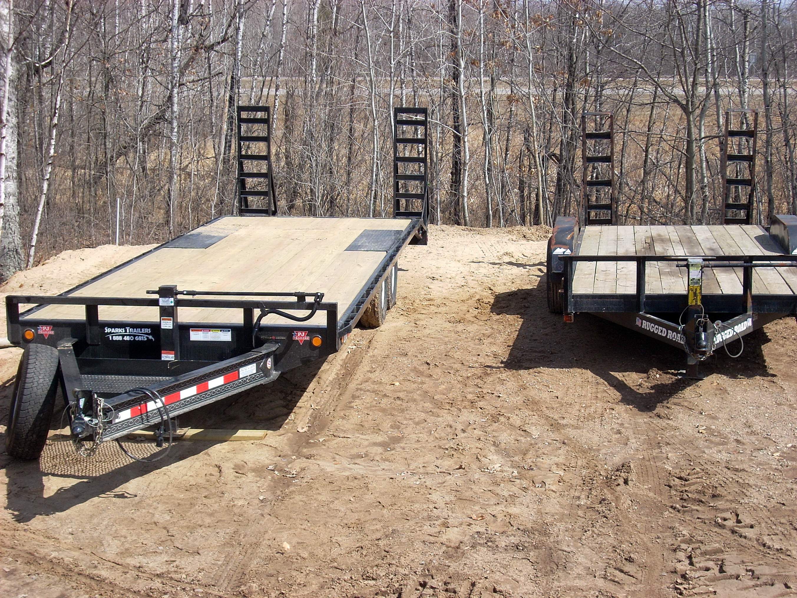

I've had a PJ 8x24 14K deckover for almost 3 years now. About mid range quality and lower price than others. My old trailer was a 18' bobcat style. The extra mobile fenderless RE is handy when moving pallets of materials.
I'd confirm about 5-600lb tongue HOWEVER that tool tray in front carries ratchets, chains, straps, and a jack + I welded a steel cover, tire carrier & added a spare tire.
Now my yard trailer tower 455 JD lawnmower with a 3pt lift will not lift it much & I added about 150 lbs on it's front bumper to keep the front wheels down. So the road ready tongue weight is closer to 800-1000. I move it with the lawnmower when I mow under it.
My tow vehicle is a 1 ton dually dump. A powered dump box is much more valuable to me than a gooseneck trailer.
