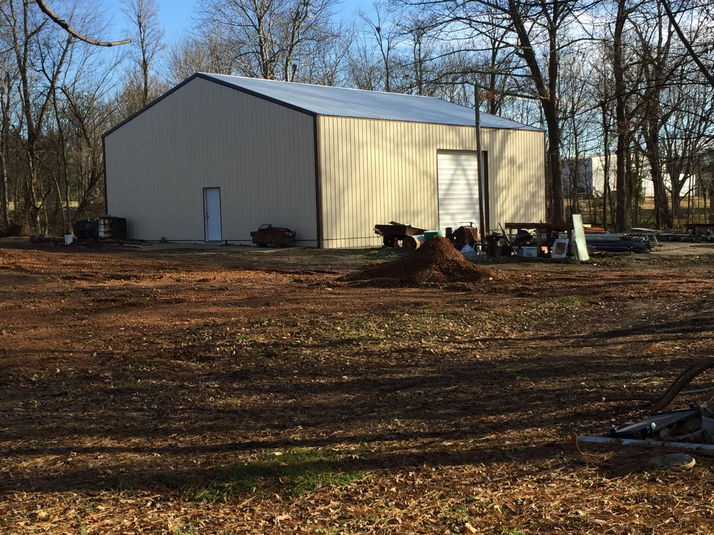

This looking at the S.W. corner, PB is 40x60x12 6-12 pitch 100 lb snowload. This is March of 2014 not quite finished. I got the idea of the OH doors from my neighbor who had that on his 30x40 garage.
I moved the mandoor around the corner just to the right of the OH door. I put a insulated heated shop 22x33 in the S.W. corner with a 7x7 compressor room at the east end of it.
Lay out works perfect for me.
