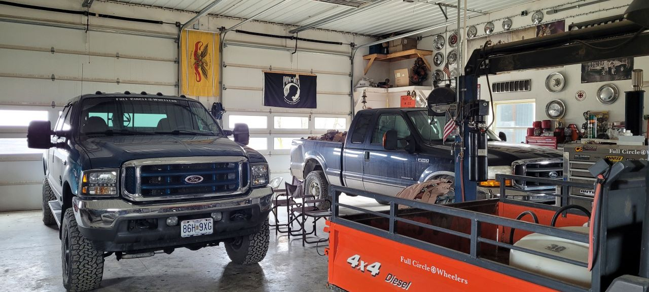

My 39x48 has four 4ft square windows, two walk-in doors half glass, two 12ft wide overheads with two window panels.
Today is moderate clouds with drizzle. No lights on.
Love my glass.
