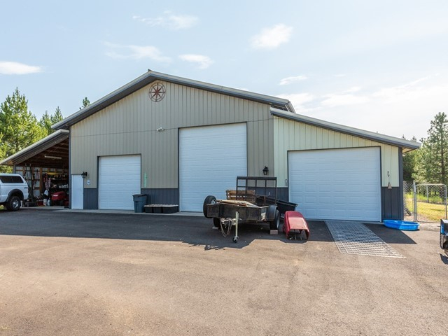

my shop is 48' X 72'... I installed another door on the left like the one on the far right (10x12) .. then the 14X12 and the 10X12 next to the regular door.. snow slides off each end, I still have to use the big blower on the front because we've gotten over 13' of snow in the past.. inside ceiling is 14', plus the storage area above that..

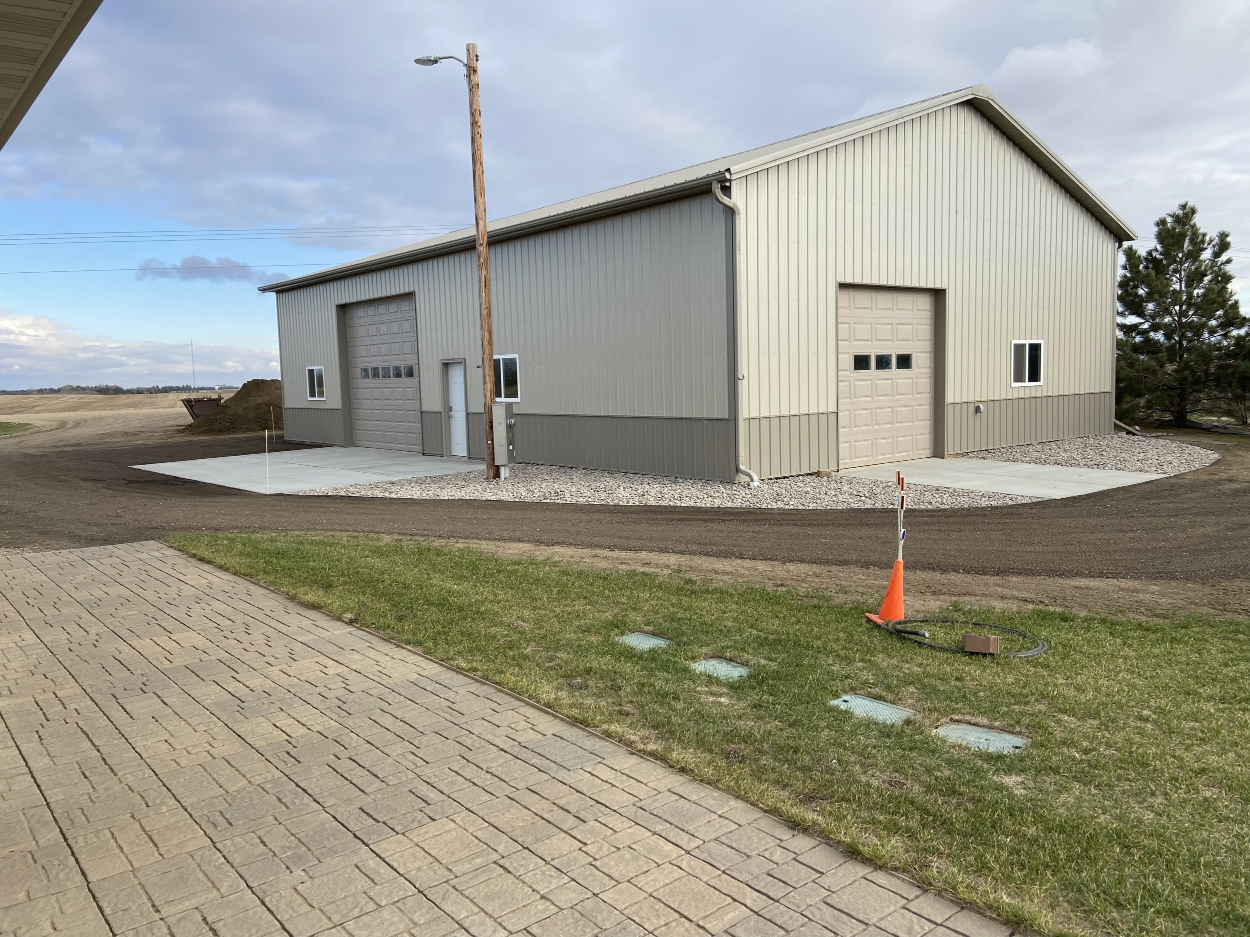

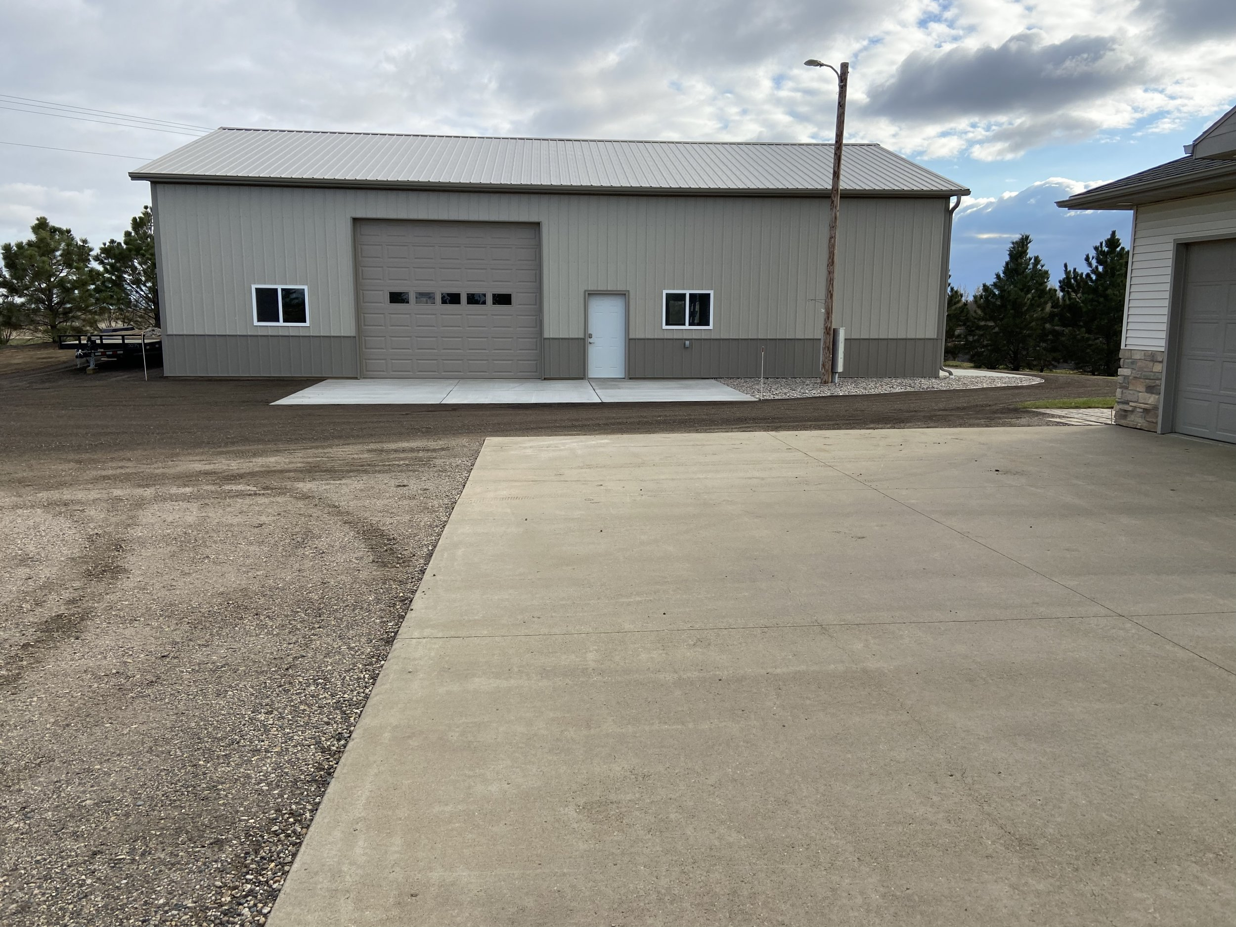

I have exactly the same size building- I went with a 12x16 single door on the gable end of the building. I did provision for another door adjacent to it should I decide to install another garage type door.View attachment 789670

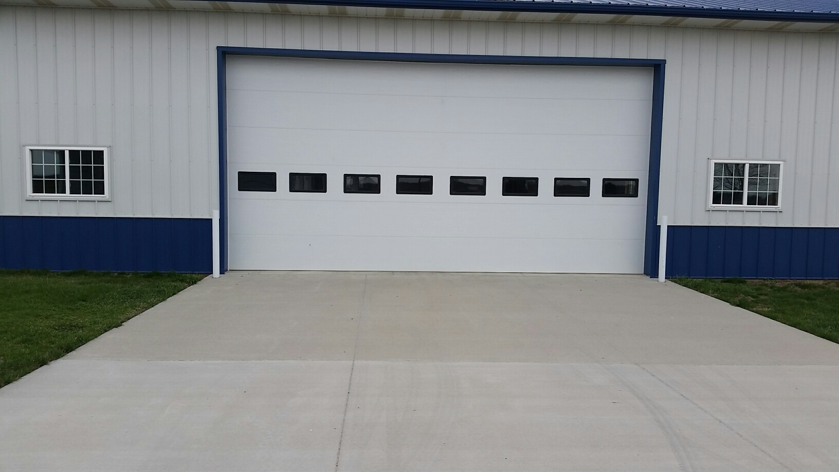

It's 24 x 12
