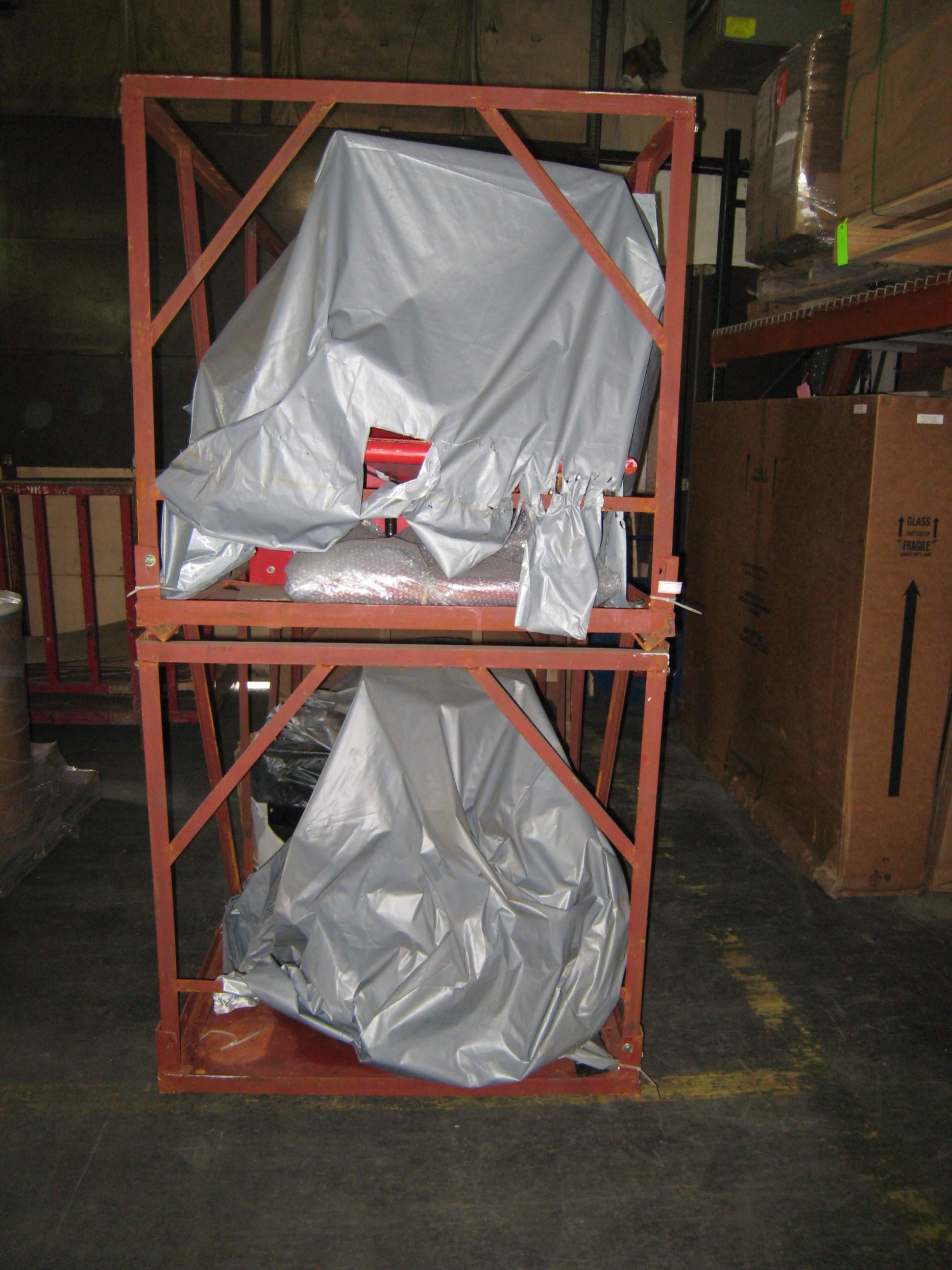

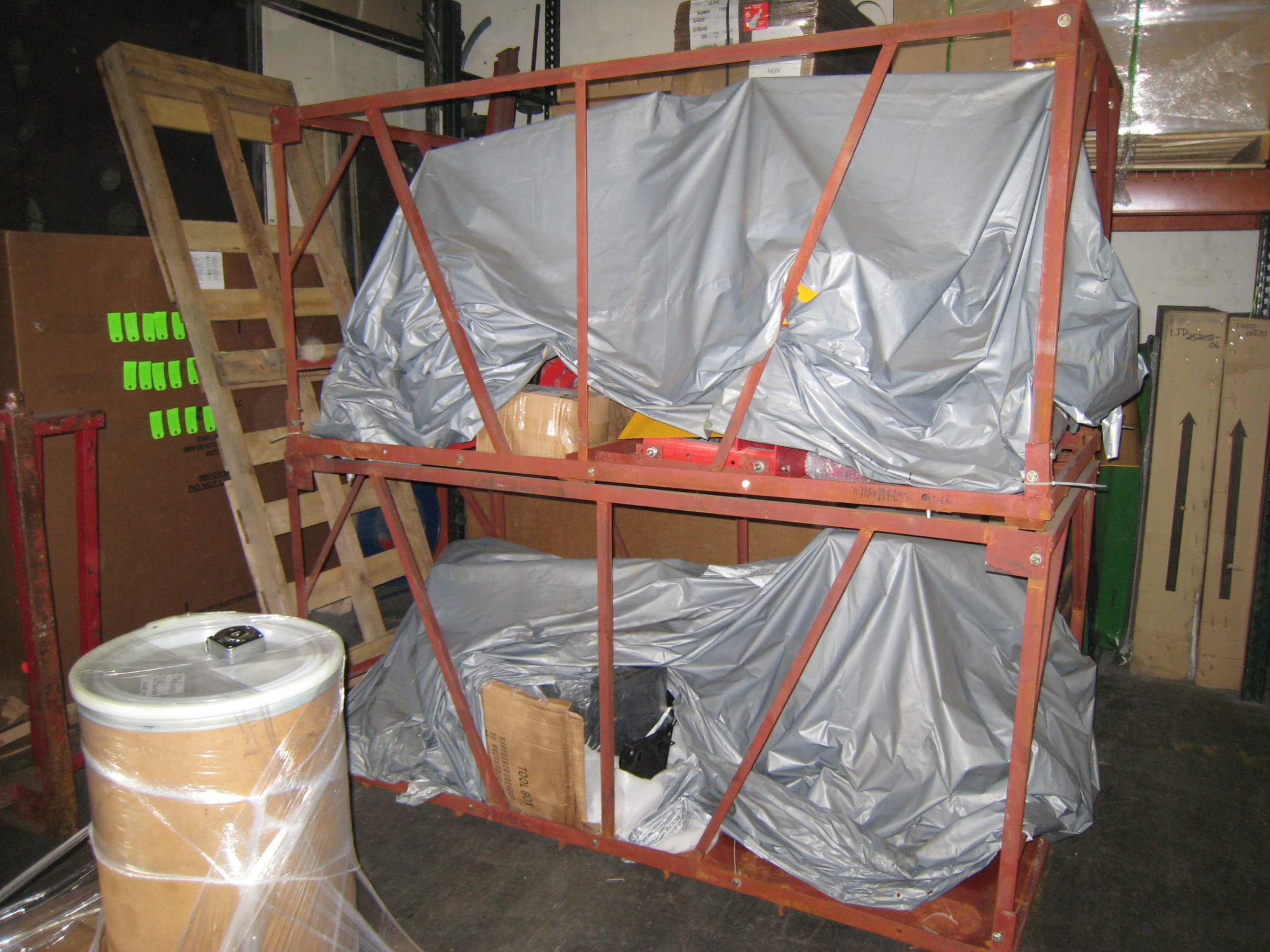

I've got plenty of angle iron and can't even chip it! :laughing:
   / Placing Order with Jinma Factory #22
I loooove angle iron crates.. :)
