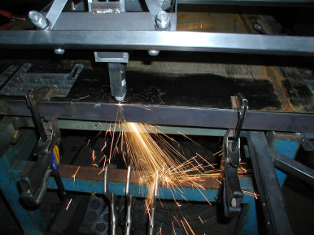

More progress; All the electrical problems are fixed now, no more false switch-open signals. Added o-rings to the motor shafts to keep the insides cleaner longer.
My Dad came home from a local auction with forty sheets of 0.060" stainless steel (400 series?) which had a little corrosion but can still be polished up nicely. Makes nice fodder for the plasma animal. We cut about ten parts out Saturday, including a part drawn in Catia, saved out as DXF, converted to Gcode by Master5, editted for torch pauses and cut order. It came out great. Here's an action shot attached. Next I will be learning cutter compensation to zero in on the part tolerances a bit better. The plasma machine is now worth painting, so I suppose that will have to happen soon. I was thinking John Deere green and yellow...just kidding, any suggestions, I need something cool and exotic looking!

   / Plasma cutter, automation project #34
Rather than using cutter comp, you can just offset the shapes you want to cut by 1/2 the kerf in your CAD program - remember offset outward for outer shapes, inward for holes. Makes programming life much simpler if you're hand coding.
