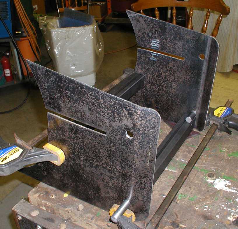

Here are some recent projects from the NC plasma cutter. Yes, it's still alive and working well! I have made a BUNCH of stuff from it over the last two years. It has greatly expanded my fabrication capabilities, to the point I had to add a press brake this fall (what a bad problem). Shown are parts for the snowblower project.

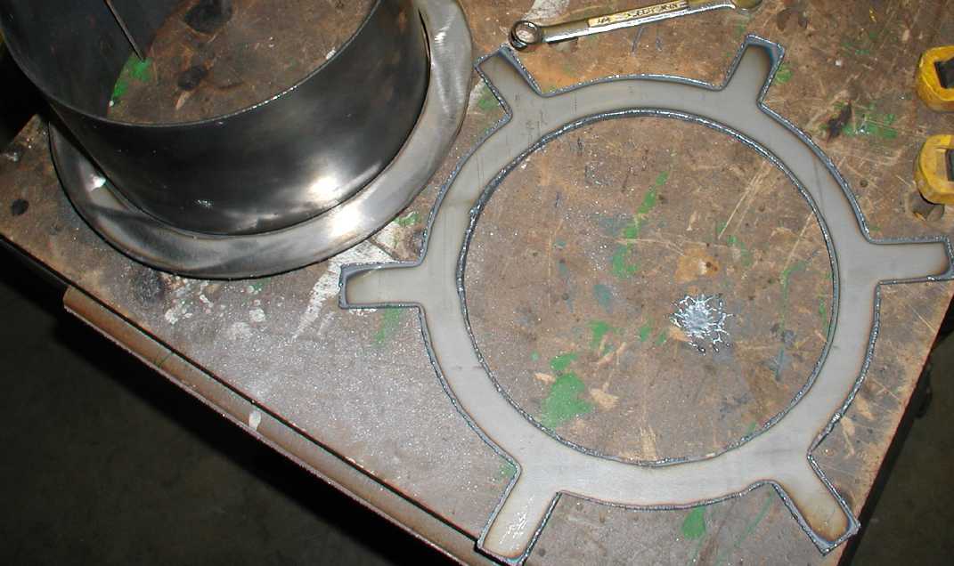

...and this one, which some of you may recognize as an adaptor to the John Deere Quick-Tach front hitch.

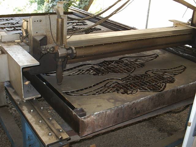

   / Plasma cutter, automation project #46
This is a picture of the CNC Plasma system I built about 7 yrs ago. I'm useing my old sign software to create art or drawings and it creates a plot file. I wrote my own soft ware to run the machine itself. It is dos based. I'm useing a Hypertherm Powermax 800 machine with machine interface board. I built my own torch height control by reading the torch voltage, provided by the machine interface board. Also by useing the Powermax system there is no high frequency start voltage so I never had the problems with starting the cutter.

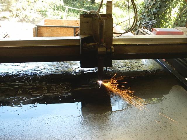

I've read all your posts and I was wondering what software you are useing to create your drawings. I was also wondering if Master5 software allows z axis control for torch height control and if it can be used on the fly(while it is running). As I said before I'm useing the machine interface board from my
powermax 800 to control torch height, but I want to build a ox/acetelene system for cutting thicker metals. My current system will cut 3/8" thick but because of the lack of wall straightness I thought I would go with a reg torch. Also in an earlier post you talked about metal warping while cutting. I've included a picture of my machine cutting which shows the water I cut in. I discovered I could in water by accident. But when I realized I could cut in water I set my cutting grate in a 4x8 water tank and brought the water level up to the bottom of the sheet of steel. It really stopped the warping and it really stopped the amount of stuff it put in the air. It made the working enviroment a lot better. I was wondering if you where useing 14.5 degree or 20 degree rack and spur gears?
