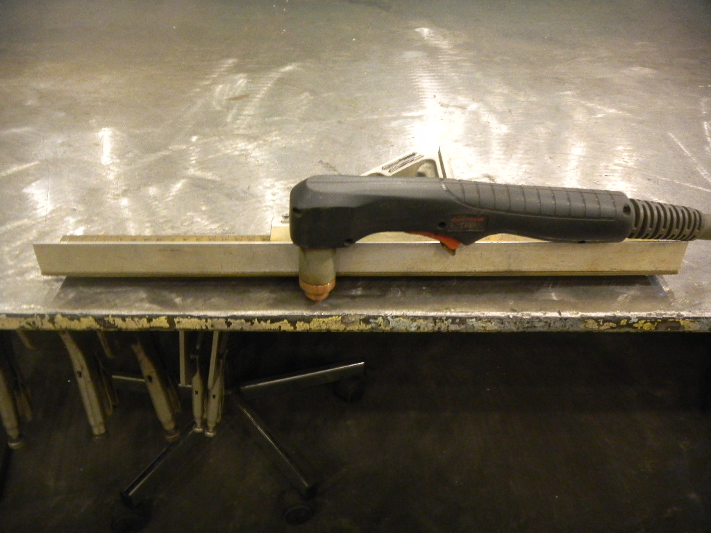

I tried the dragging technique, but some plates are just too rough to get a good cut, so I use a burning bar, or the CNC table when I can. But sometimes you just have to free hand things.

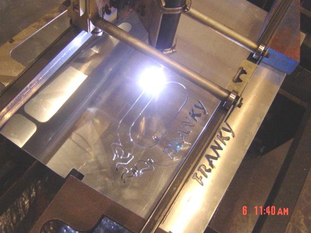

I have had a plasma CNC machine since 2005. I got it as a hobby, but its ended up being used more times than i can remember to make a bracket here, repair this item there, etc.
I can make a quick drawing in Coral, transfer it to a cut path drawing on the computer in my shop and have the part cut in nothing flat.
Last summer i added a hydraulic down assist to my post hole digger, and needed a simple attachment point for the ram. Took about 10 minutes on computer then sent it to the plasma table. A few minutes later the part is sitting there ready for a light sanding and welding to digger bar.
Im so spoiled now, i really dont care what this hobby cost me 7 years ago. id do it again in a heartbeat.
I live 45 minutes from town, and i HATE having to drive there to get a part i can make myself.
