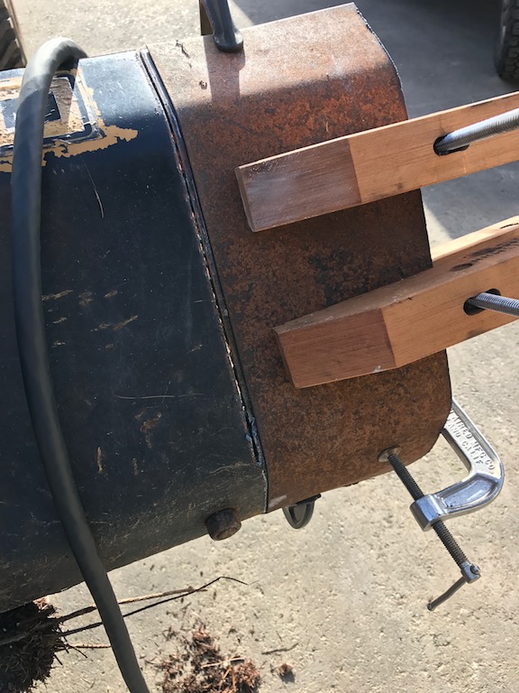

Remember that there are 2 types of Dross (slag) Low speed from too slow of travel speed and High Speed from too fast. Low speed dross is easy to remove and High speed dross is difficult to remove. Your pics are what normal hand held cutting looks like whan not using a stand off or guide. Most times the cuts like these are fine, Knock off the dross, Touch with the grinder and weld. Even with a flat plate and a straight edge you will get some dross because you will have a hard time keeping the perfect speed. The little ripples in your cut are simply motion. No Worries, Cuts look normal.
The dross did NOT come off easy. Had to take a grinding wheel to it and it was still a bit of work. The cut looks crappy compared to other 1/2in cuts I have seen. Also realize it took a second pass to sever this. I did use a piece of metal that I bent and clamped into place. Similar to how I cut the 1/4in blade shown here.
Mark.

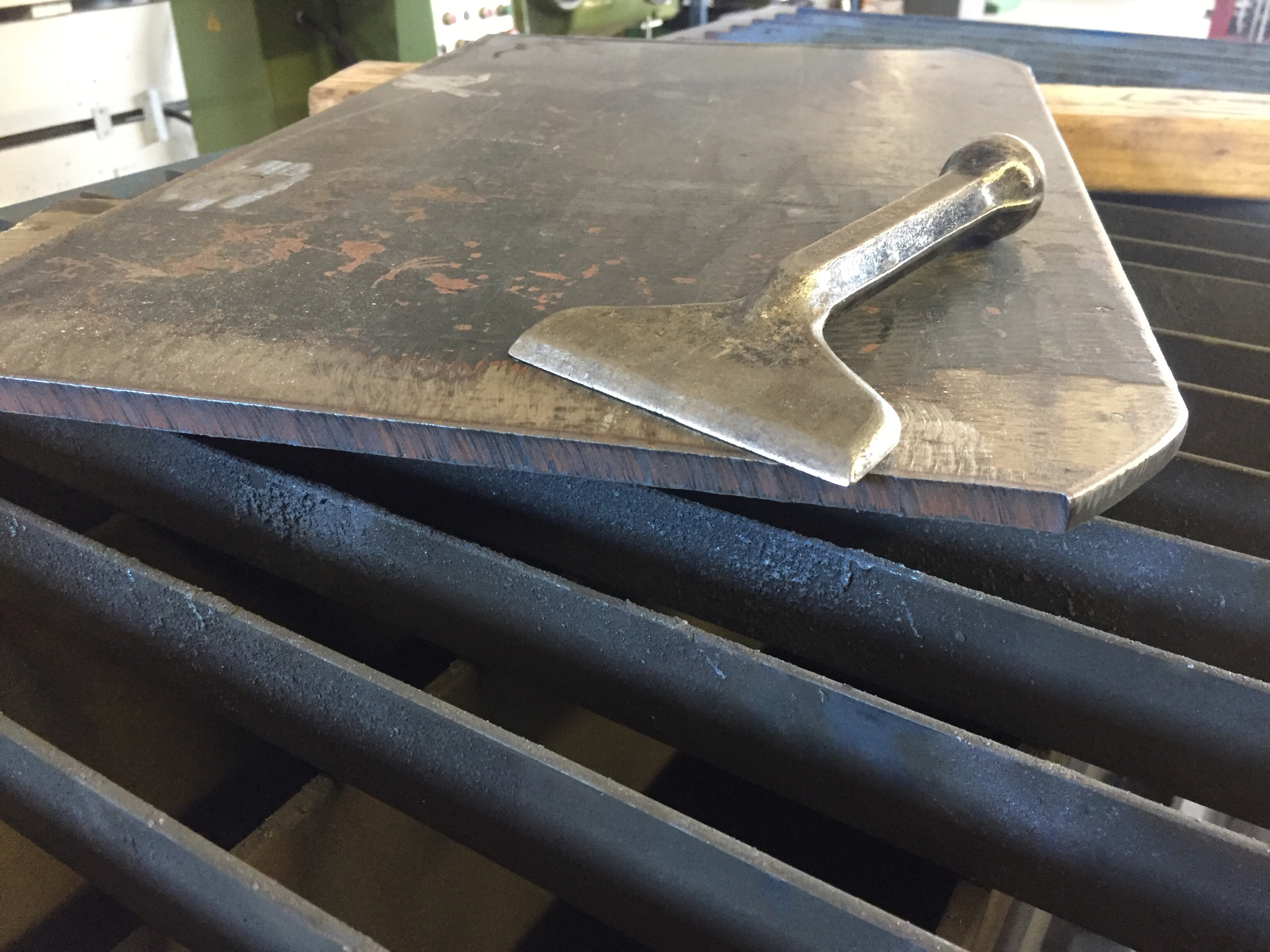

From the info you give I would guess that your air quality is not an issue and you are not getting the amps you need due to your restrictive extension cord.
Here's a pic of 1/2" plate cut with my Miller 625 Extreme (and
and from what I can gather a LESSER capacity machine than yours).
Wide blade chisel pictured makes short work of dross removal. View attachment 504523
That's is more what I was expecting. The whole reason I decided to go with the 45XP vs. the 30XP or Miller equivalent.
I think when you are able to wire a 50 amp receptacle you'll go a long way toward solving your problem. My 45XP cuts on 1/2 look a lot like Big Barns and I have to use a guide.
Yes, I am pretty sure it is my redneck 220v wiring to my shop. I am planning to extend my garage to have a bigger dedicated shop so I have been waiting to run wire from my main panel until I can do it right. If I ran it now, the sub panel would not be where I want it later and my run would be longer and maybe in the way of my foundation work.

Nice cut Terry. Perfect speed, smooth tip control, sharp tip/electrode.
My machine is same model. I had the earlier, large bulky 625 before. I like this smaller model much better. Comes with it's own carrying case. Easy to be mobile.

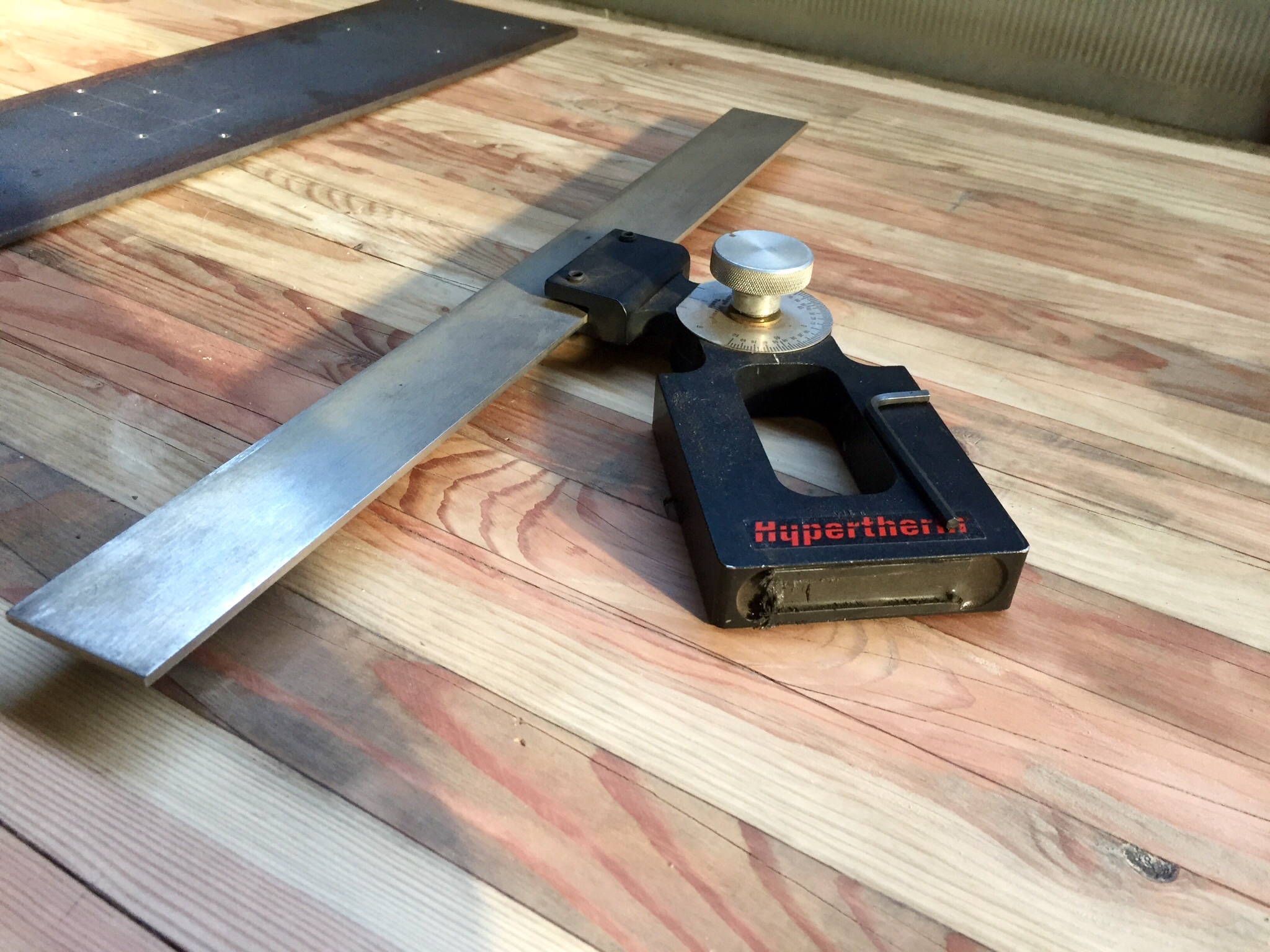

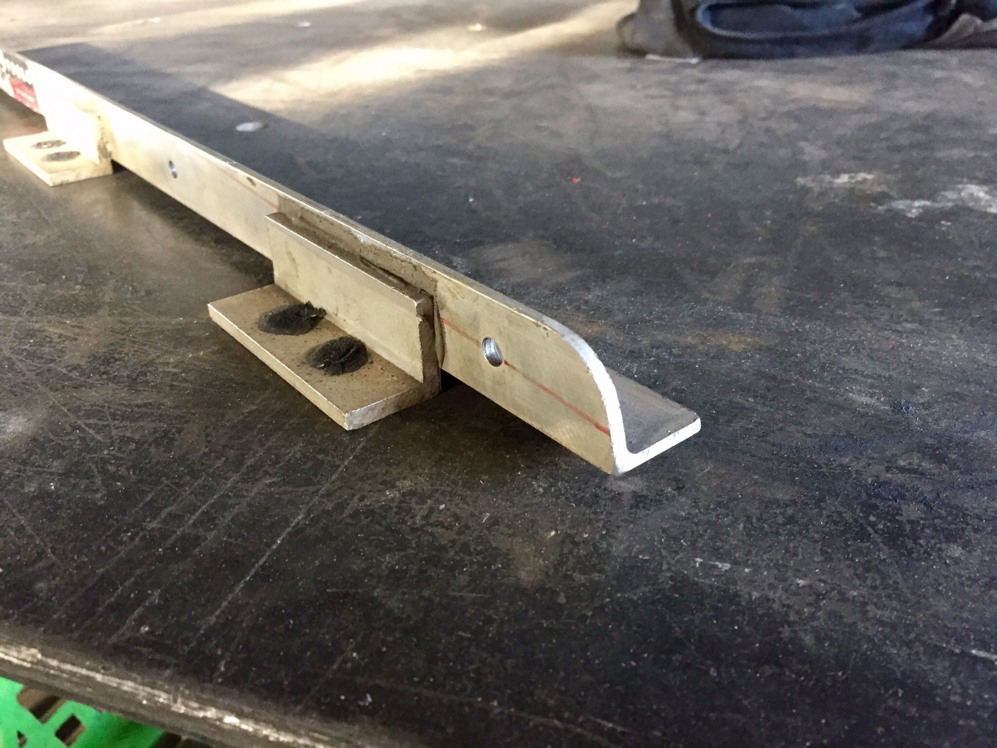

Richard. My first Miller Spectrum plasma I purchased almost 20 years ago didn't have elevated drag tips.
I made this straightedge guide to maintain correct cutting height for material over 3/16". I JB welded 3 aluminum vice jaw protectors to a length of aluminum angle iron (at appropriate height) for the plasma's retaining cup to slide on.
I also have a short magnetic guide for smaller cuts. The edge is elevated at the correct height for NON standoff tips. It's branded "Hypertherm" but I'm quite certain it's made by Flange Wizard.
Terry
Good stuff Terry. Thanks for the ideas!!!
Do you use a Drag Tip now??
